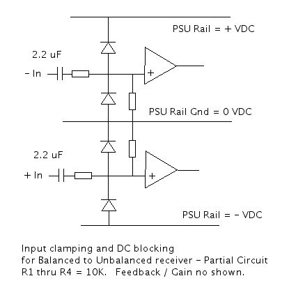

Nigel's suggestion is a good one. You might want to add a DC blocking cap and diode clamping to each balanced input of the receiver stage ... to keep that 48 volt phantom power from a hot mic from blowing away your PSU. ... maybe like this:

The basic reason that Alesis built that gadget with unbalanced I/O is just exactly so that a) it would not normally be in the audio circuit of a pro recording studio and b) so that microphones, etc. would not be directly connected to it. (There may be an XLR version for your purposes.)
Anyway, if it is usable to you, and otherwise connected, then leave it alone ... unless you have a crying need to use it 'cause you got it. (Normally, compression / expansion is added during mix down, not master recording ... exception: broadcast usage.) I would not use it at all if you are working with 24bit masters ... Or sources that need to be held under control for some reason like sound FX that are too dynamic for 110+ db masters, etc.
The mixing of balanced and unbalanced devices usually does not affect over all quality as long as the unbalanced interconnects are of good quality and kept rather short = IMOP under 3 feet = patch panel cables.

I wouldn't have thought you would be able to hear, or measure, any difference either way?- I would just connect it unbalanced.
