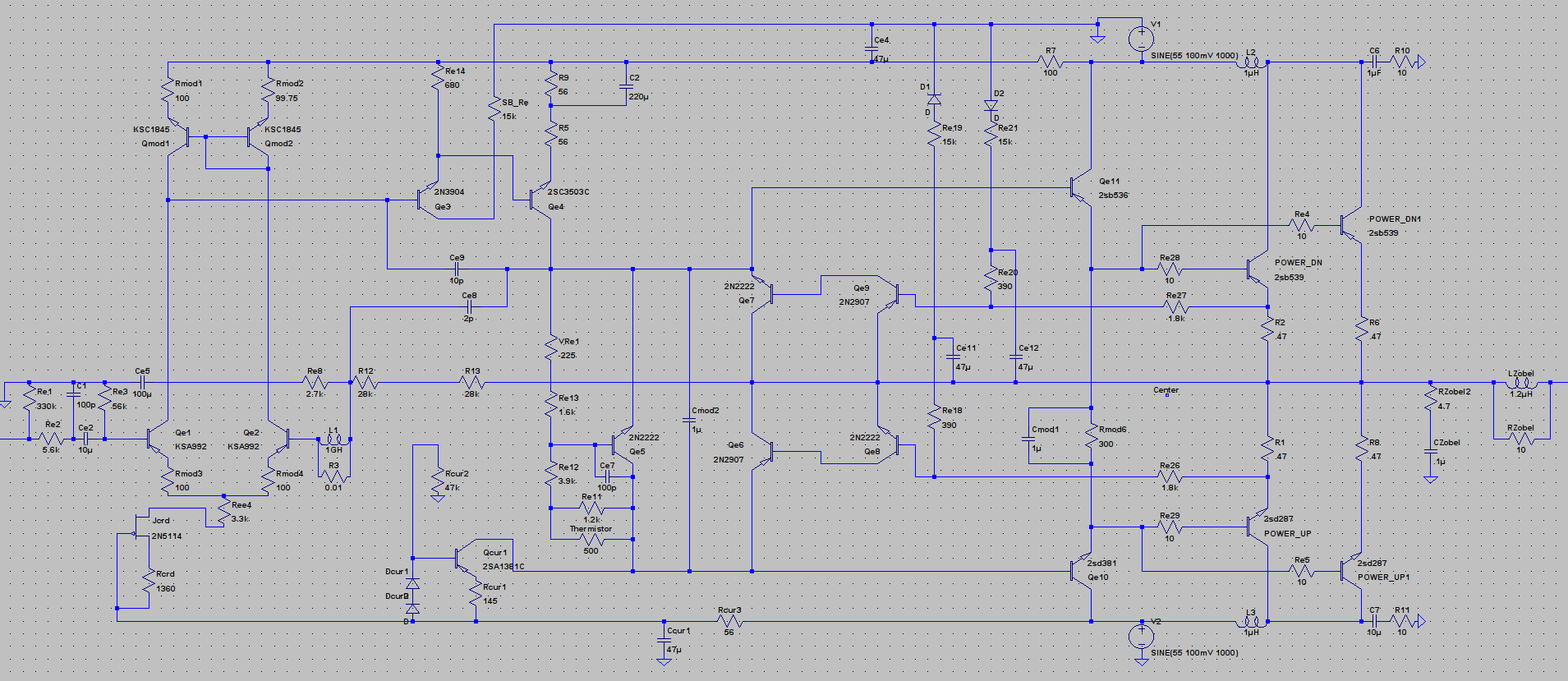

current source load for VAS and input stage
Here's an improved schematic with current sources for the VAS and input stage.
The "Jcrd" JFET and "Rcrd" resistor represent a 4.5mA current-regulator diode. Due to space constraints on the PCB, it's easier to replace a jumper with a CRD than to fit another BJT and resistor. I'll leave the existing 3.3k resistor in series with the CRD to reduce the CRD's power dissipation.
Everything else can be made to fit in the space made available by the removal of Ce6, Re9, Re10, De1, Re6, and Ce3. It's going to require cutting a couple of traces and drilling a couple of new through-holes. It can be done with a minimum of point-to-point wiring, most pins will solder direct to the PCB.
I plan to reduce VAS bias current to about 4.5mA or 5mA, from the original value of 8mA. This reduces power dissipation in Qcur1 and Qe4 to a quarter watt so they should be OK without heatsinks. There's not a lot of room for heatsinks. I haven't found a reason not to reduce bias current...
Unlike the prior design, simulation of this design shows more distortion with a large signal (peaking at +/- 40V) than with the small signal (+/-3V) on the 19kHz+20kHz IMD test. Distortion floor is 102db below signal for the small signal, 91db below signal for the large signal.

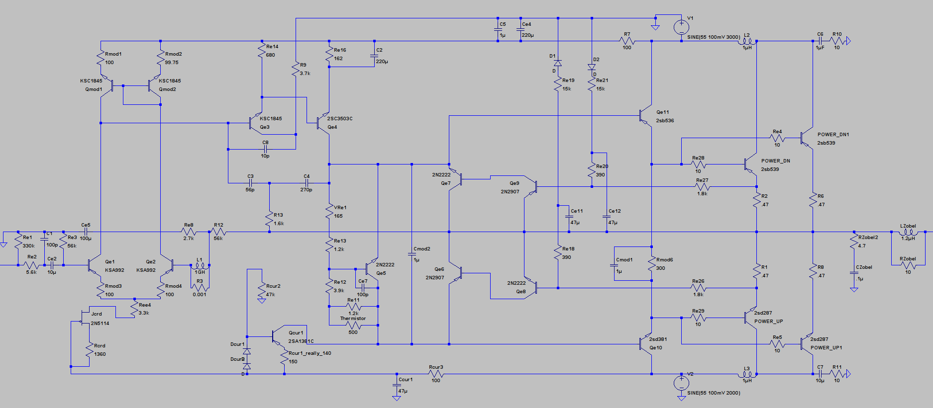

Here's another improved schematic. Now the noise and distortion floor falls to 110db below signal or better.
This borrows the compensation scheme from the Honey Badger. I don't know who came up with this topology or if it has a name. It's an excellent topology: simple, stable, and allows for vanishingly low distortion.
At audio-band frequencies, C3 is the Miller cap, being fed current through R13 from the output stage. This allows the Miller cap to linearize the output stage, even before global NFB is applied.
At high frequencies, the impedance of C3 and C4 fall with respect to R13. Now C3 and C4 together act like the miller cap, and the feedback loop shrinks to no longer include the output stage. That happens before the output stage becomes too slow to jeopardize the stability of the loop.
At middle frequencies, both Miller loops operate in tandem. There are no crazy frequency response peaks or wild phase swings on any node while the larger Miller loop phases out and the smaller one phases in, the crossover is very smooth.
A really beautiful thing about this design is that it's less sensitive to the bias current at the outputs than most class AB amps. The Miller cap will linearize the output stage even if the bias current drifts quite a bit, so performance degrades very gently with bias drift. Whereas the more conventional design from the previous post can behave very differently with 38mA or bias versus 44mA...
The only other change here is Ce4 increased from 47u to 220u to reject more of the ripple on the negative rail. And it's bypassed by a fast 1u cap. Without this change, supply noise stood out above the distortion floor.

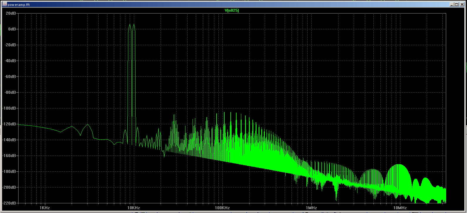

This FFT shows 9kHz+10kHz tones with all harmonics >110db quieter, for the schematic in the previous post.
The peak at 2kHz is ripple from the positive rail; the peak at 3kHz is ripple from the negative rail; everything else is distortion products.

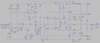

This is now built and running. There were a few late changes to the design:
- Qe3's collector resistor is reduced from 15k to 3.7k. This allows the amp to run on a variac at 1/4 normal voltage.
- Qe3 is changed from a 2n3904 to a KSC1845. The '3904 doesn't have a high enough Vce rating to work with the smaller collector resistor.
- Qe3 has a new 10p base-to-collector capacitor to prevent it from oscillating.
- Emitter resistor of Qe4 is changed from 168R to 162R, a standard value.
- The filter caps on the negative rail were formerly a 47u electrolytic bypassed with a .47u film cap. Spice sims showed most supply noise leaked in from the negative rail, so now there's a 220u electrolytic bypassed with a 1u MLCC.
The changes don't affect performance, Spice still shows a distortion floor >120db below signal in the audio band.
If I had this to do over again I'd use a 4.5mA current regulator diode in place of Qcur1. That simulates just as well, and it would have required fewer changes to the PCB. (There's already a 4.5mA current regulator diode working well for the input stage, represented by Jcrd and Rcrd on the schematic.)
