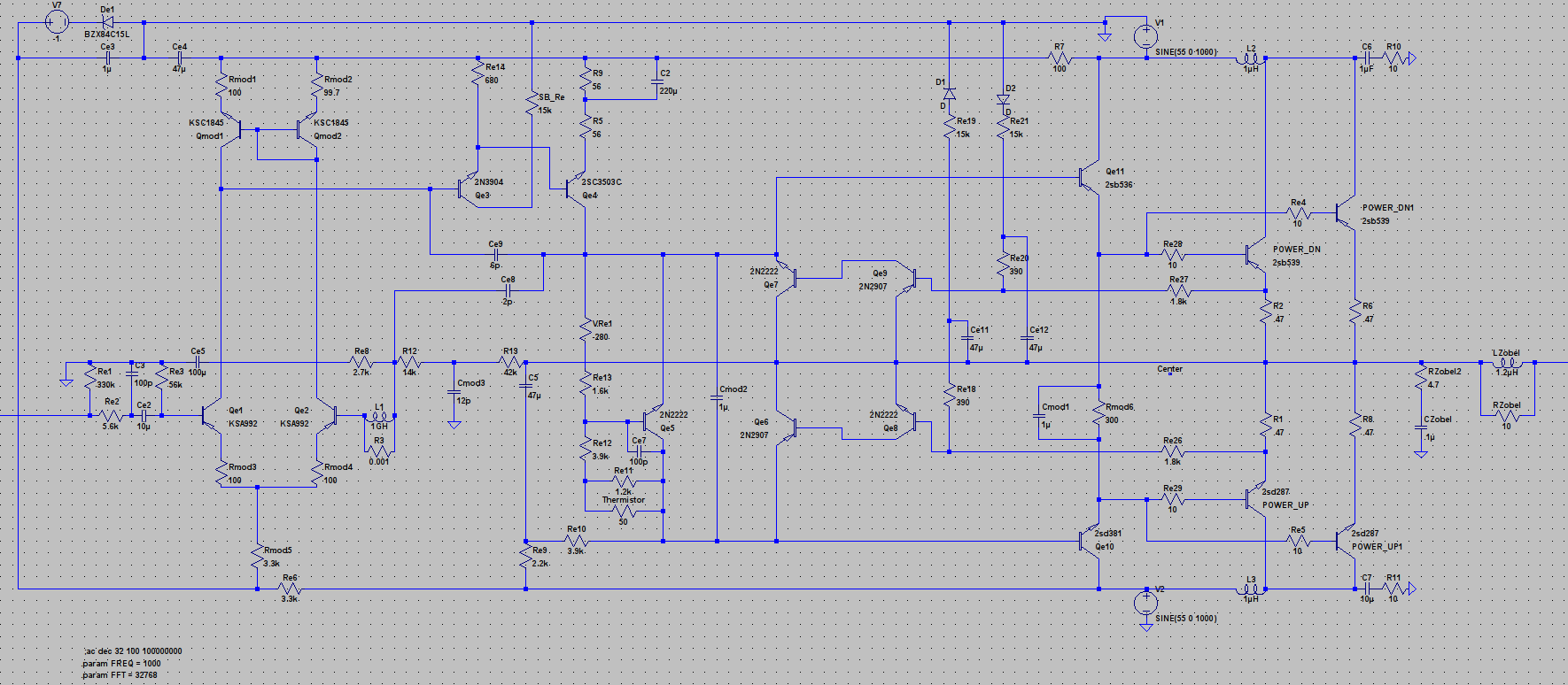

The Kenwood has a fun compensation topology. It has the usual miller cap at Ce9, and it has another cap at Ce8 that creates a "feed forward" path. This is a 2nd feedback loop that bypasses the output stage at HF. This allows a smaller Ce8, and it allows more gain through the front-end, but not much more: with too much gain you can oscillate through the feed-forward path!
OK, so what's the best combination of Ce8 and Ce9?

First surprise: the amp schematic in the OP, the one I had built and played for several hours during a party with guests over, isn't stable in Spice with these transistor models! It was stable in real life. That's good news -- we want the spice models to be conservative. We'd like to think that anything stable in Spice would be stable in real life. That's been the case so far, for this particular set of transistors and circuit topology.
The existence of Ce8 is a departure from the pure blameless amp that has no feed-forward path. So I tried the real amp with only a 56p at Ce9, and open circuit at Ce8. This runs stable, and it sounds bright and thrashy! That was the second surprise. The corresponding simulation looks pretty good, distortion floor is 87db down from signal (1k+14k IMD test.) It's weird to think that an amp that measures pretty good can sound harsh. It wasn't that super harsh, and it did a lot well, sounded airy and transparent sometimes, and sometimes it wasn't really fun to listen to.
After running a LOT of experiments with different component values I zeroed in on the new attached schematic. Ce8 is 1p, Ce9 is 22p, and the degeneration resistors on the LTP increase to 220ohm. It's stable in SPICE to at least a factor of two; you can reduce or increase either Ce8 or Ce9 by at least a factor of two and nothing oscillates. It also gives a distortion floor 95db below signal in Spice for the 1k+14k IMD test. This is built, it's playing now, and it sounds fine. It sounds neutral, not harsh, but just right. At least so far. 🙂
Third surprise: the Kenwood is sensitive to bias current in the output stage. At 30mA it hurts my ears, sounds real congested. At 50mA it sounds sweet. My guess is that the feed-forward path interferes with the regular feedback path's ability to correct crossover distortion, esp. at HF. That's a problem if you have low bias current and bad crossover distortion to begin with, less of a problem with ideal bias current and a smoother and wider crossover region. It could also be my imagination, psych effects at work. 🙄

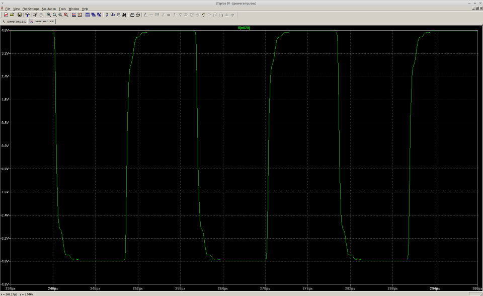

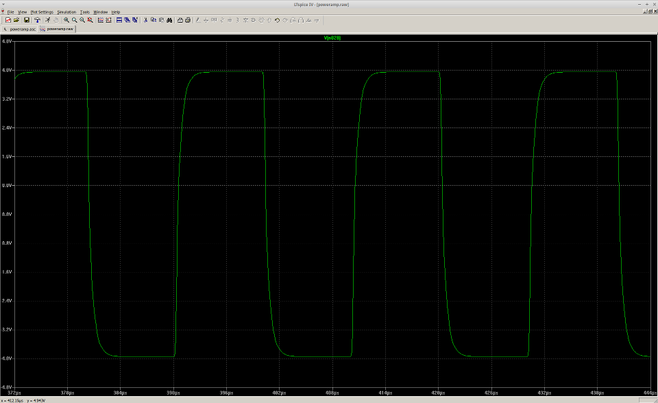

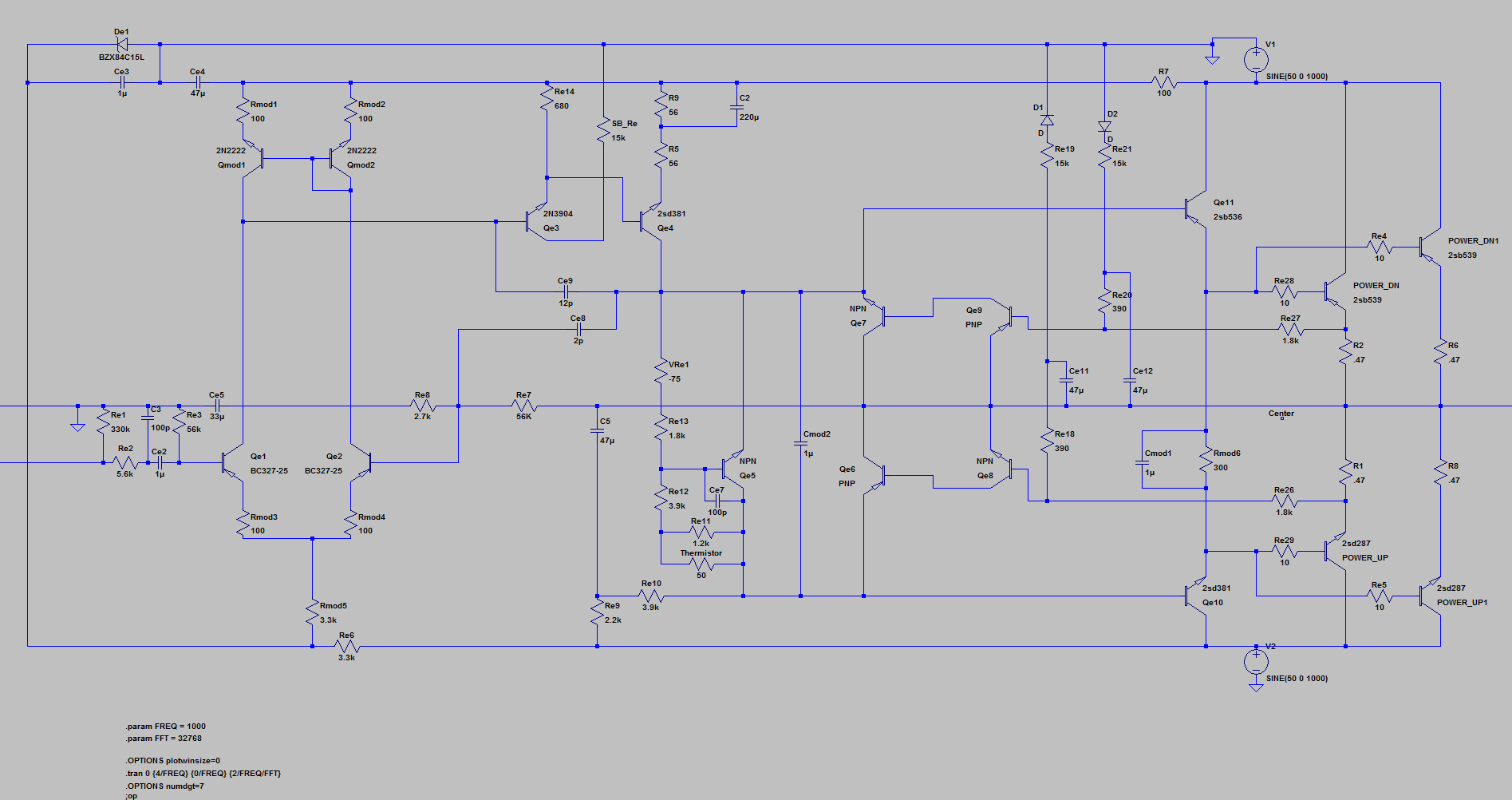

Getting to 0.005% distortion into 4 ohms
This revised schematic goes where no plebian, Miller-swilling Kenwood has gone before!
It has these nice properties:
* 60 degrees phase margin, 35db gain margin.
* Square wave looks clean. It rings a tiny bit, damps out quickly. The attached screenshot is a 50kHz square wave.
* On a 19kHz + 20kHz IMD test, the 18 and 21kHz distortion products are about 87db below signal, worst case. (Worst case means the output stays in the crossover region most of the time, while driving a 4 ohm load.)
The changes are:
* Cmod3 is new. It improves phase margin.
* KSA992 in the long-tailed pair, KSC1845 in the current mirror. (The BC327's previously in the long-tailed pair were overvolted. Oops.)
* KSC3503 at Q4 is faster than the Ford-administration-era 2SD381 that shipped from the factory. This improves phase margin.
* Miller cap Ce9 is reduced to 6pF. This consumes some phase margin, in return we get better open-loop gain and more feedback at HF.
The changes aren't built into the real amp yet. I'm waiting on the 2SC3503's. With luck it'll be stable...
Also new are the 1uH inductors on the power rails near the output transistors. These represent some parasitic inductance in the rails. The neighboring 1uF cap and 10R resistor prevent oscillation due to the rail inductance. This change is built in the real amp and works well.
Using 8p at Cmod3 makes an even prettier square wave. Also the AC analysis frequency response does not peak before rolling off, it just rolls off smoothly. I guess this is more stable the with the 12p at Cmod3.
Using 8p produces somewhat worse phase margin than 12p, but I don't think I believe that? I have also been computing phase margin and gain margin by breaking the negative feedback loop with a 1GH inductor at the base of Q2, running AC analysis, and comparing the response of the input to Q1 with the response at the feedback node. This alters the circuit a bit, so you can't trust it for exact numbers. I guess you have to close the feedback loop for final tuning and do without super precise phase margin / gain margin numbers.
Latest LTspice schematic is attached.
You will find in the real world, that to approach "Blameless" performance you need to follow Self's script a little closer and find the working, not simplified schematic. Here's the real model's AP measurement from the sales website: The Signal Transfer Company: Compact Blameless Power Amplifier .
If other projects are anything to go by, Spice modelling will show typically about 10 times better THD figures than real amplifiers. As the real model amplifier measures <0.0004% midband, imagine what the simulations might have predicted. 😉
There are a few features needed here, like a current source for the LTP and the VAS, RC filtering to the front end, diode clamps and flying catch diodes that should be on the schematic by this stage. I don't know how you see a bootstrapped capacitor loaded VAS as "blameless" but you can be very certain that you won't find that in one of D. Self's creations. No doubt you'll realize this design needs more help than what simulation predicts will qualify it as "blameless" which, after all, is a performance level, not a design topology, for any who are in doubt.
Self has a VAS with the same topology here, it can't be that bad.
Adding a current source for the VAS yields a 1db lower distortion floor. Nice. Maybe because Q4 is less loaded.
What projects have 10x worse distortion than Spice predicts? That can't be universally true. If you minimize the issues that can't be represented on the schematic -- inductance from the output rails into the feedback network, nonlinear ceramic caps, etc. -- Spice should be accurate.
I think you missed the point of that article you linked which is Self's thesis for ridding amplifiers of all sub-optimal topologies like the capacitor bootstrapped VAS shown. He certainly hasn't endorsed it or offered it as an acceptable alternative. I meant what I said in that you won't find that in any of his designs, so associating it with blameless qualities just makes no sense.
In the VAS distortion section (5.2) the basic CS variation is shown in fig. A and with enhancements in figs C,E,F . The accepted bootstrapped version is F which doesn't use an electrolytic capacitor but requires the addition of a buffer amplifier for the output of the stage as well as a bootstrapping resistor - quite a different beast to the normal version B, as in the Kenwood and countless other, older amplifiers.
Having said this, there's no reason you can't do whatever you like to improve your amplifier but my suggestion is to not go overboard in trying to clean up a basically good sounding amp. Many people fell into the trap of thinking low THD was a panacea for all SQ problems back 20 years ago when Self's work was becoming widely known.
