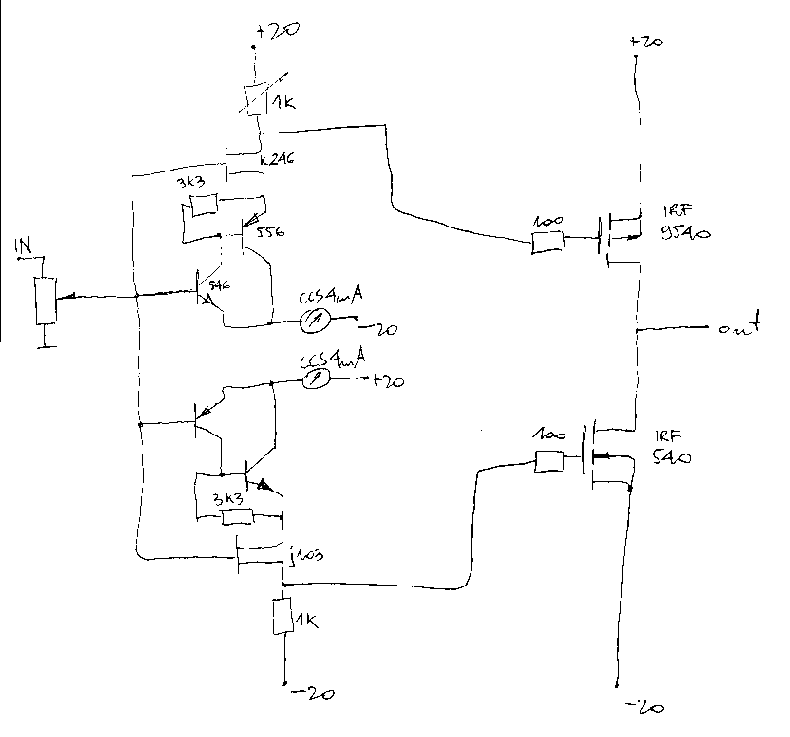

So I tryied to build an amp which was something like on this quick sketch (maybe it is wrong but please look at the idea). I eliminated VAS. The amp played not too good not too bad.

I think you would have to do something to the output stage to avoid the memory distortion there. I think the device that controls the gain should have as little power variation as possible.
How do you set bias and DC operatin point in your device?
How much gain do you have?

hjelm said:I think you would have to do something to the output stage to avoid the memory distortion there.
The irfs are operating at A-class and general the output devices produce relatively low level of "memdist"]
yes but with a common sense][/QUOTE]
The ccses are jfets with the potentiometers at their source to set the current. Then is a simply correction of the offset at the output. I can not tell the overall gain but is enough to drive the speakers with a cd connected via the potentiometer to the input.][/QUOTE]

Please remember that the schematic was only estimated, not exact! However very close to reality.
