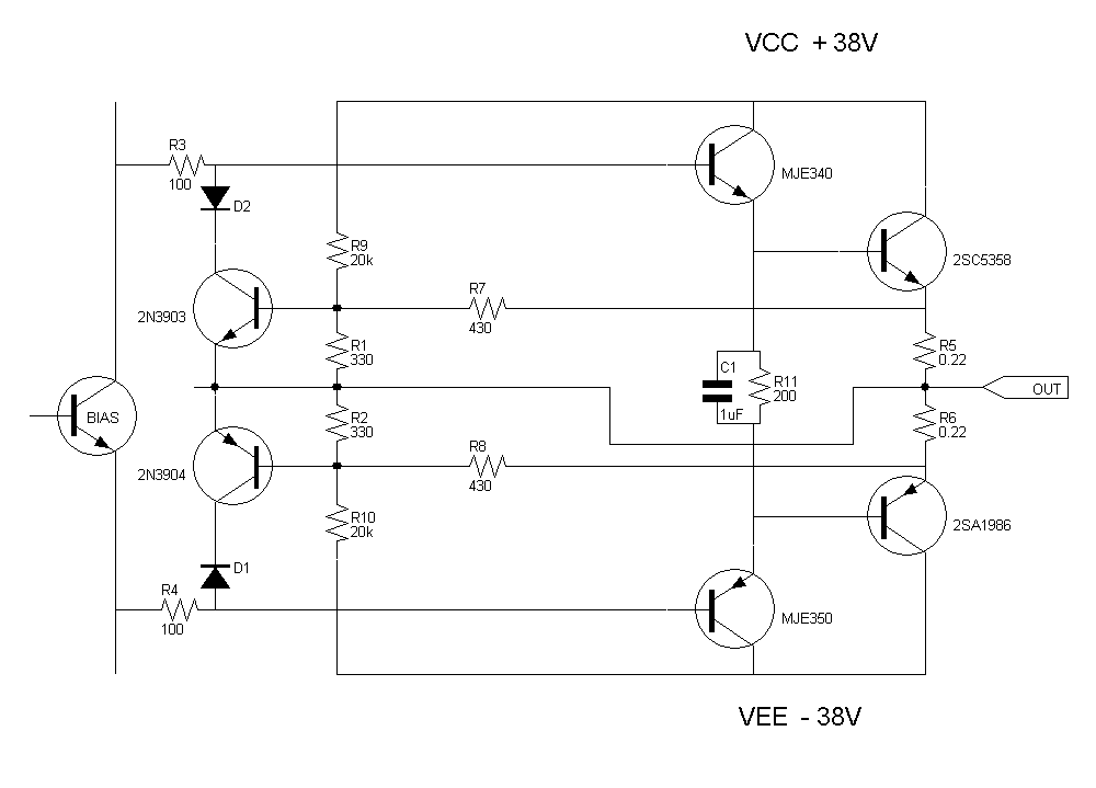

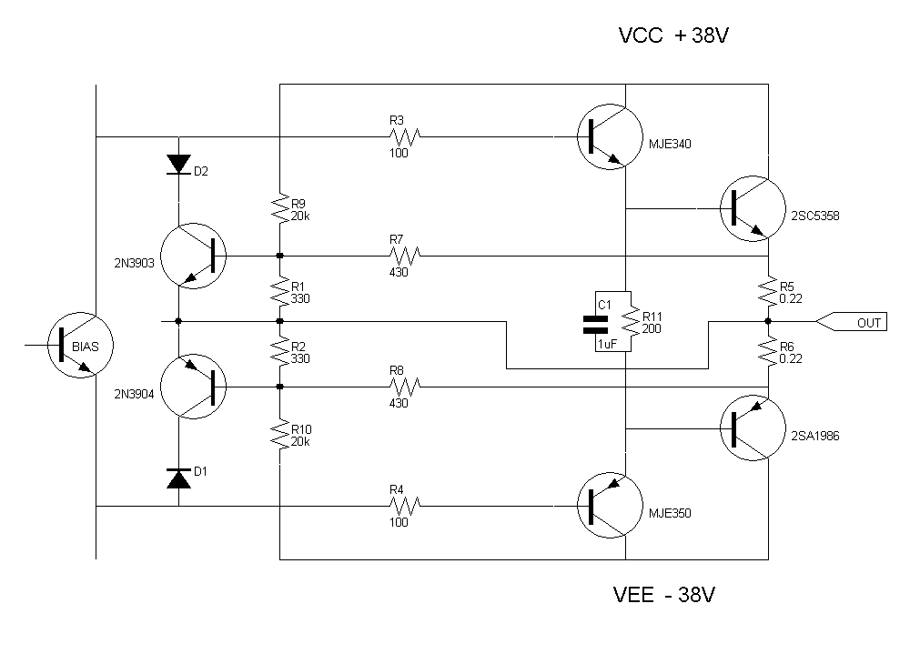

I am also about to build a blameless but I would like to add protection on output transistors. I think the following is correct. Should the protection transistor be connected as shown at bias transistor or at base of driver transistor the other side of the 100 ohm
Hi Audiofan,
the resistors r1 & r2 can have a capacitor in parallel to absorb short term peaks and prevent the protection transistors triggering before they need to.
I have seen as small as 100pF but I think they should be in the range 470nF to 10uF to give the correct delay to suit the SOAR limits for DC and short term loadings.
Can someone give us some guidance on the protection time constant required here?

a capacitor across R1 R2 will slow down protection
a capacitor across R7 R8 will speed up protection
it is probably linked to the match betwen safe operating area of transistor and actual limiting of the circuit.
If we are to close to the maximum operating of transistor we may speed up protection and if we are far away from maximum area of transistor we may slow down protection?
Slone dont use any cap in his 50watt project ( electricity and electronic page 261 )
Leach use capacitors on both sides ??????????
Should there be capacitors in yhis circuit ? I dont know !

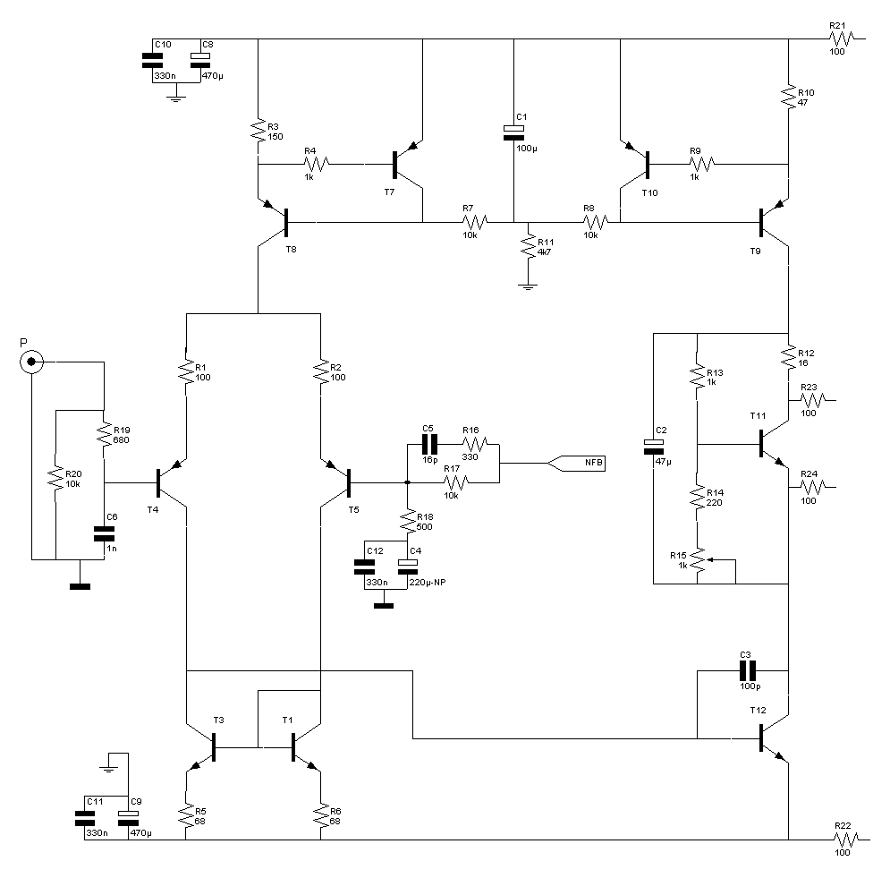

I made a few modification to the circuit according to Andrew comment.
I ad an input filter to prevent RF from gettig in.
I made a modification in CCS
According to me current in LTP is now 4mA an current in VAS is 13mA and both sources are fairly isolated from the other.
Are those modification done correctely
