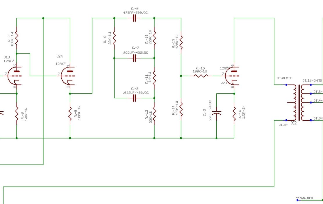

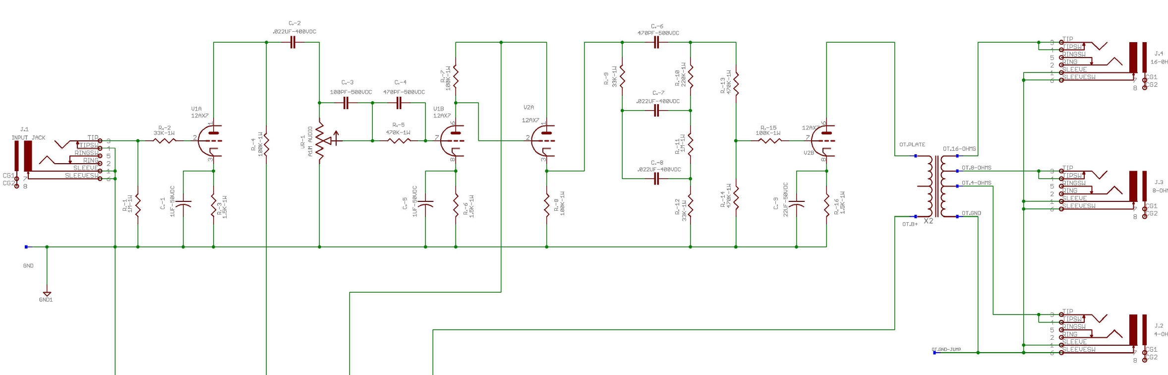

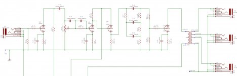

Blackheart BH1 SCHEMATIC.
Disabled Account
Joined 2004
It claims 1W but they probably missed a decimal. I'm posting this because you don't see this everyday. I wonder about the OT they used, I also wonder about the fixed tone stack and, lastly, I wonder what these guys are smoking because I don't get the output stage. Why didn't they choose the 12AU7 or ECC99 as the output tube? Maybe too much power? I'm really curious about the sound of this, was going to prototype it but where do I get an OT with this sort of impedance?
EDIT. Sorry about the pic, you'll have to download it and open it with an image viewer. Originally PDF file and the size was too big to post it as it was.
I'm really curious about the sound of this.

I dont know, but could the output trafo be some form of interstage thing, with gain 😕
I figure the fixed tone stack is a result of achieving the low cost point.
Likely the values are also set to keep things at least close to what the cheapie OT can handle as well.
You could easily mock that circuit up with a typical tone stack. Most certainly You could also upgrade the OT without breaking the bank.

I didn't know this was a 'famous' amp. Yes, you can find mods some of them don't make sense either... like power scaling. An amp with an 12AX7 output tube needs power scaling? Am I going mad? Anyway after reading the manual I gather the output triode won't live long (no wonder) so this it's just a wrong design and my curiosity is over. It's just plainly wrong and stupid.
BTW there was a thread not long ago, in the tubes forum....somebody was asking how much grid current could take the 12AX7 without going bad. Well, buy this amp and find out for yourself. 😀
That amp could actually benefit using a 12AU7 or even a 12AT7 in place of the AX7.
