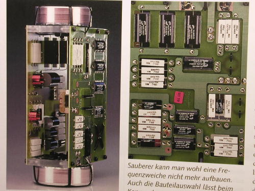

I hope you guys don't mind my pictures yet. Talking about speaker crossovers, here what goes into some very expensive speakers. This are $85,000 Dynaudio Evidence loudspeakers crossovers. As you can see Solen caps and regular resistors.
Thomas, as to your findings I can recommend both Hovlands and MIT RTX, which I used in my crossovers. None of them alone was perfect, but mixed together they sound pretty good. I believe that Lynn Olsen also recommends Hovlands caps for Ariel speakers.
