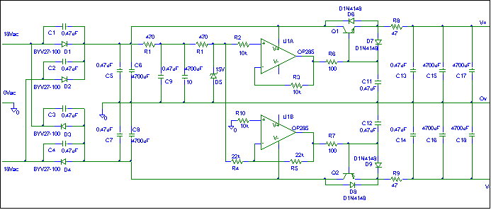

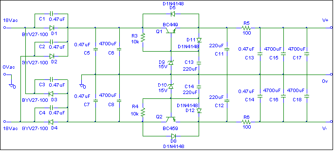

Hi. I have built the phono stage TNT Solidphono.
According to The TNT Solidphono - phono DIY preamp this preamp is similar to Black Cube.
Advises toroidal transformer of 50 watts and 18 0 18.
The rectifier circuit with soft diodes and fast recovery.
Hi Kay Pirinha, I have followed the scheme that is in TNT Solidphono to the letter.
It works very well. Perhaps it has been exaggerated in capacity (about 48,000 uF in total adding the PSU and the preamp), but I repeat it works very well.
