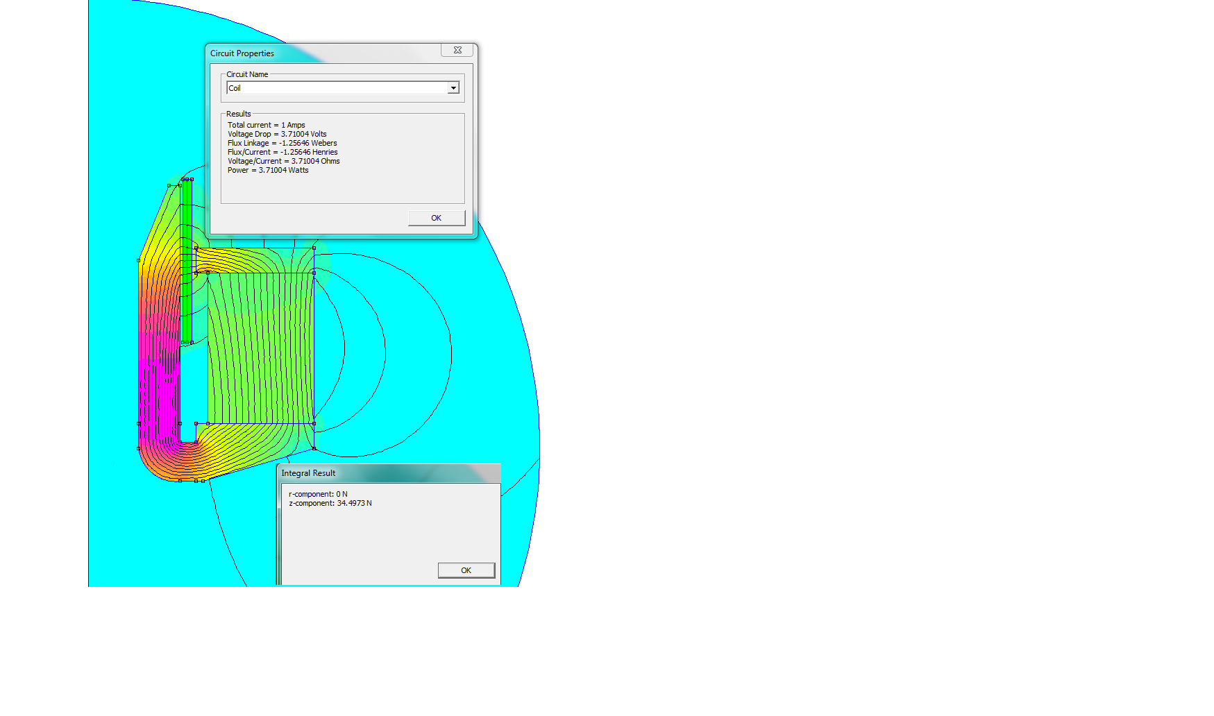

Here are the specs for Subwoofer_C
Coil
OD: 82.55mm
WW: 65mm
Wire Diam: 19 AWG (0.912mm)
Re: 3.71 ohms (Dual 1.85 ohms in series)
BL: 34.49
BL^2/Re: 320.64
Magnet:
OD: 180mm
TH: 20mm
Top Plate:
OD: 180mm
TH: 10mm
Bottom Plate:
OD: 180mm
TH: 10mm/23mm
Pole Piece:
OD: 73mm
HT: 105mm

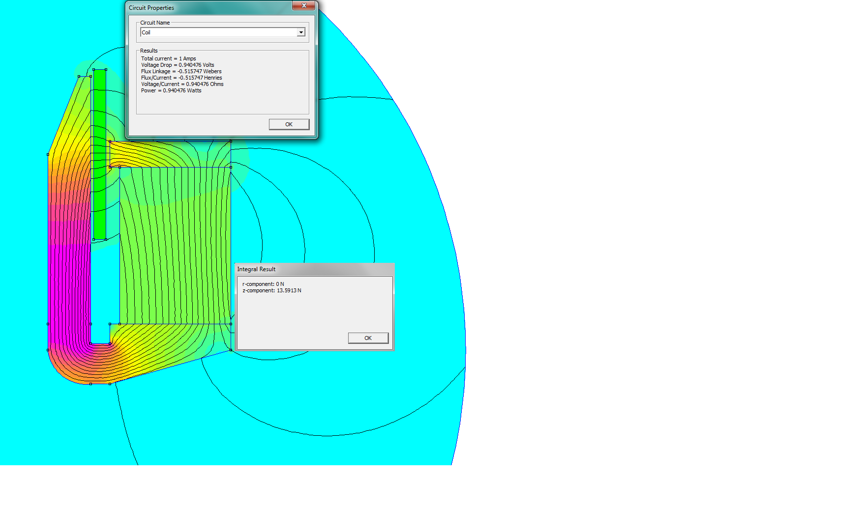

Here are the specs for Subwoofer_B
Coil
OD: 84.6mm
WW: 65mm
Wire Diam: 17 AWG (1.15mm)
Xmax: 27mm 70% BL
Re: 0.938 ohms (single 0.938 ohm)
BL: 14.1
BL^2/Re: 240
Magnet:
OD: 180mm
TH: 20mm
Top Plate:
OD: 180mm
TH: 10mm
Bottom Plate:
OD: 180mm
TH: 10mm/23mm
Pole Piece:
OD: 73mm
HT: 105mm
You can see the FEMM graphs in the attached photos. The motor is not that big but as you can see the BL^2/Re figure is quite large for both of them.
