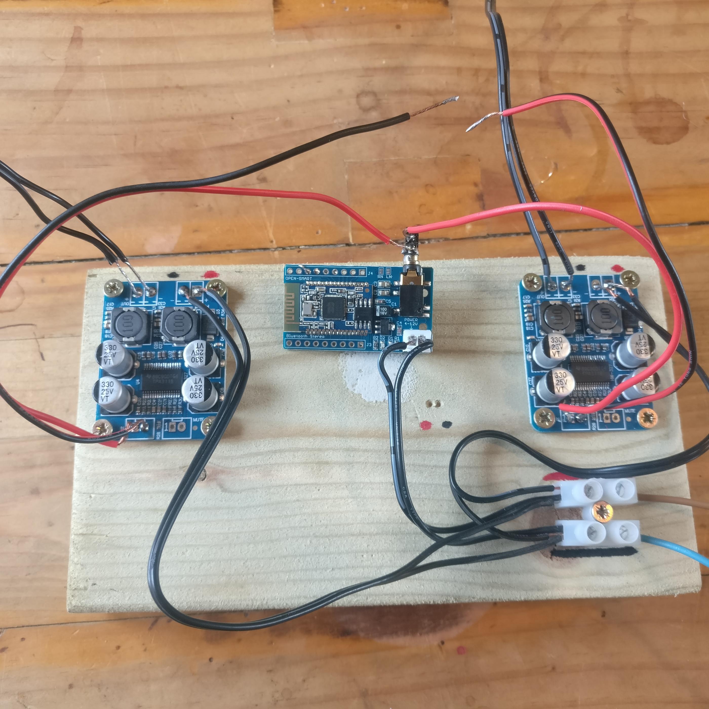

BK8000L and TPA3118 project. Amateur problems.
Just for fun, I've been trying to throw together a Bluetooth speaker.
Basically by trial and error, and gut instinct, I have it working.
Unfortunately, the speakers buzz quite loudly.
Anyone able to advise me? Feel free to laugh... I'll try to add a picture of my (ahem) work so far...
Might help...
Powering a preamp directly from the power amp rails is an issue as power amp rails are not clean but carry distorted version of the amplified signal and mains ripple.
Ground routing is important, ground loops can pickup hum. You have loops from power block to power amp to preamp because you power the preamp direct from the block, rather
than daisy-chaining it from the power amp (yes two power amps makes this problematical).
If you power the preamp unit separately and connect the screen for each audio interconnect you should have a loop-free system.
