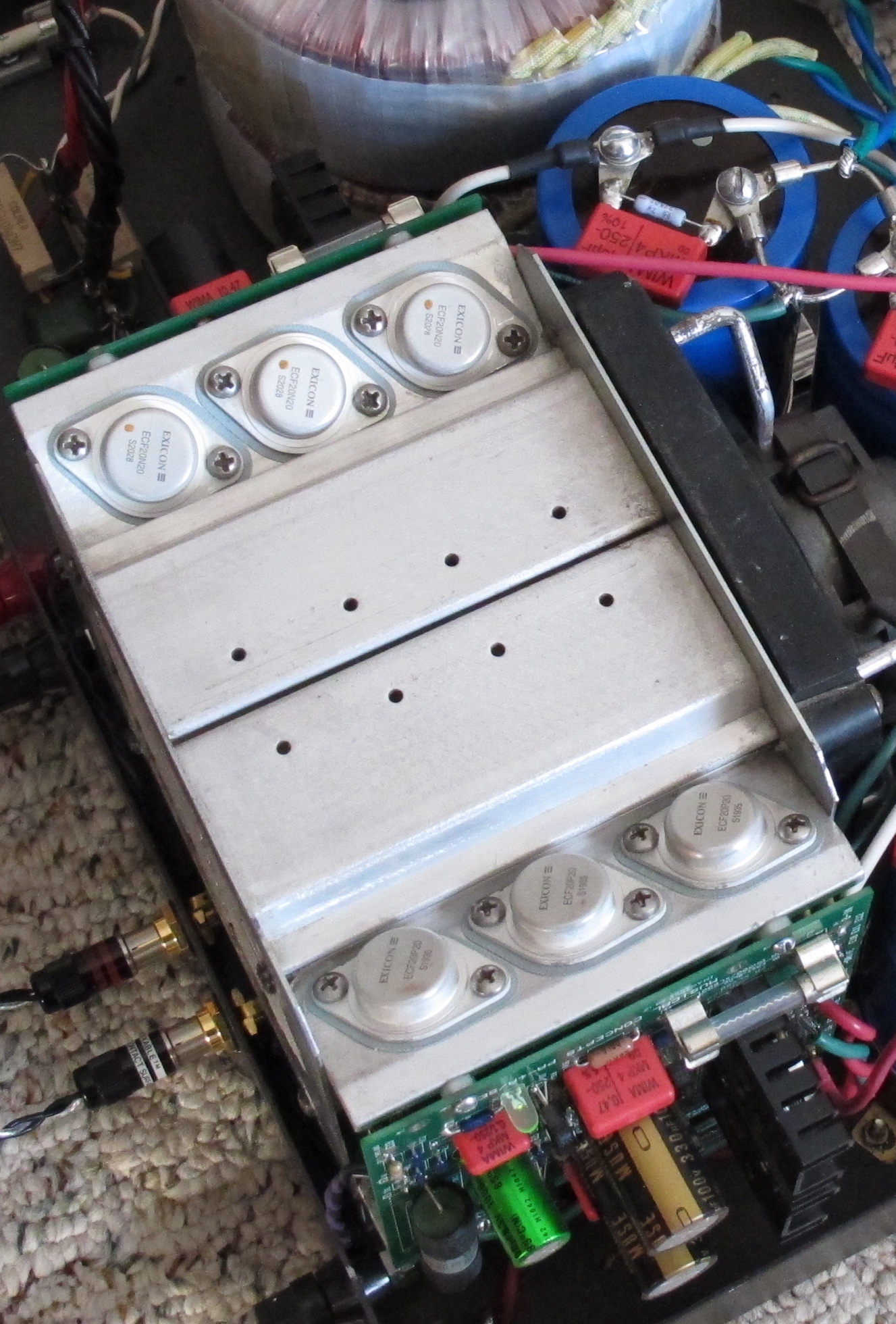

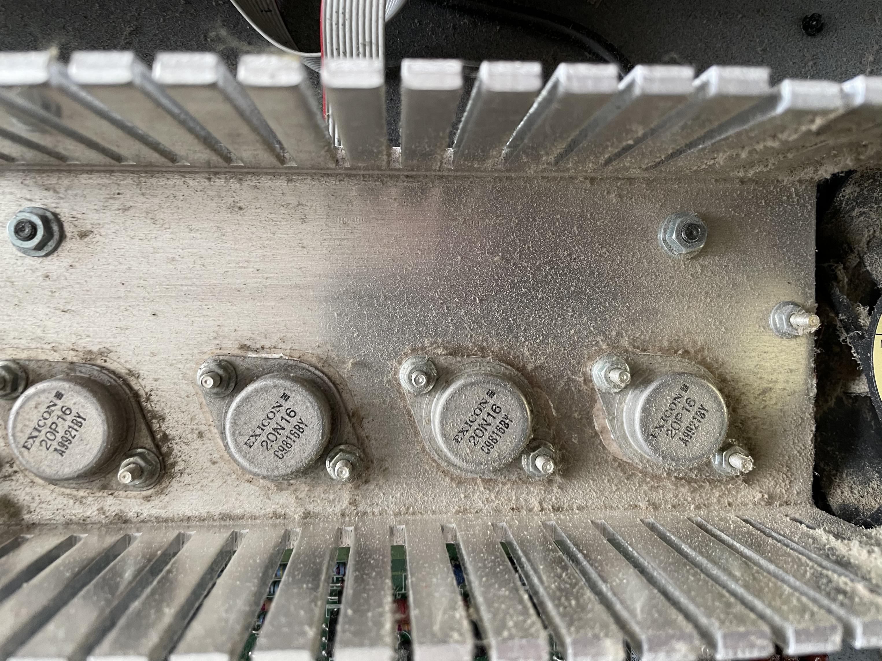

Just noticed one of the power amps has the buzz mosfets in it for these modules. Might be worth a switch at some stage to see if any sonic difference.
Yeah, bet those Exicons sound nice.
Good thing you jumped to the Sil-Pads! Way too big of a pain (*rolling*) with mica+grease.
Just make sure you set the bias pot to minimum -- the thresholds will be very different!

In the semiconductor business this is a well-known weakness of MOS devices I think.I learned that (without incident) the hard way, I was surprised by the extent to which this is so.
Gate voltage specs (threshold, plateau) in MOSFETs have a wide manufacturing spread, and can change somewhat over time, basically being sensitive to lattice defects and stray ions within/near the gate oxide layer, creating embedded charges that affect the electric field across the oxide.
Until they figured out to reduce Na+ and K+ ion impurity levels the gate voltages were subject to large, history-sensitive, changes in use due to sodium ions being mobile enough to migrate across SiO2 in response to gate voltage. More info how this is countered I found here: Mobile Ions
Modern devices are better than older ones, but you basically need to allow for this manufacturing spread, and as I discovered with my original Hitachi-style MOSFET amp, biasing will drift somewhat over the decades - I suggest checking the biasing every decade or so (temperature of heatsinks after warming up on idle is a good proxy).

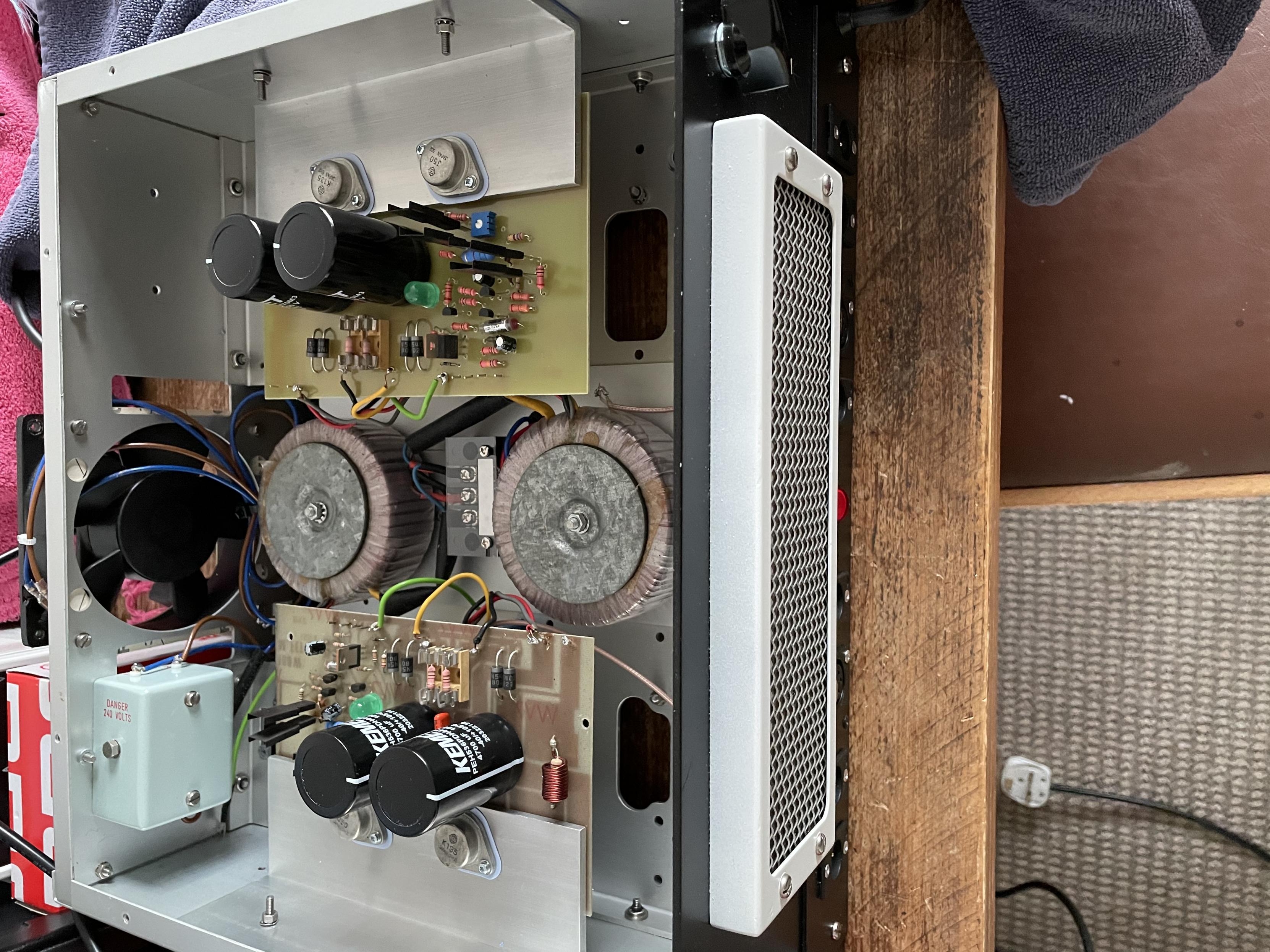

Well all installed but the heatsink is not grounded which think they needs to be. Good news is I’m down to mV on output new pcb but could smell burning then noticed those poor little resistors where starting to burn up. So that’s as far as I got. So got some heavy duty 5 watt resistors coming tomorrow so once there in I’ll fire her up again. Cor be glad when all done.
You don't need to "ground" the heatsink.
If the power line is earthed to the chassis and/or power supply ground that's all you need, Some people use a resistor (between power earth and chassis), some people use a Thermistor ( CL60 comes to mind) and some go to the full extend of using a rectifier for protection.
I just attach the ground ( 0V point) from the power supply after the rectifiers and cap bank to the chassis and never had problems.

Just fitted the fan relays not hooked up yet. I’ll put some 1 amp in there in but then fire up see what happens. Did notice yesterday the LEDs didn’t light up at all either board so assuming the resistors where not letting in enough voltage. Odd one as they lit up before.
Also noticed those heatsinks on the BDs where getting warm. Did not realise the wattage on them. That was good pointer on your part thumps up.

Those resistors shouldn't get too hot when there is no signal applied.
You could still have excessive current and 0v on the output.
Measure the ac volt drop across the 100r resistors.
Sid.
Yes, leave the 100r resistors in DO NOT put the fuses back in yet.
For 100mA (which is more like what you would expect) through 100r you would get a 10v drop and 1watt dissipation.

I need to check the mains connection on the original board as I’m only get mV on the mains input! Other side around 37v. The output has dropped to 1.4 v on new board still to high but better than 40 plus volts for sure. Led I’ve put in wrong way round so it’s no lightning up. Otherside not lighting up due to only mV at mains input of tranny. Taken resistors out running 500mV quick blow. There fine I’m sure if there was major problem they would blow straight on switch on at 240v. So just need to check that mains in on original board put in new led and then it’s getting the bias sorted. Hopefully that will resolve the issue with the output. Worst case scenario is a fuse or resistor across the +/- side of output. Can’t really see what else would be causing it to be in voltage range as opposed to mV. Strange one. But at least me board worked out a okay. Was waiting for a bang ew.
Well and it goes on. So fault on old board. The mains neutral on tranny broke on connector so was not making proper contact hence not full power getting to the module. Fixed now still with 500mA quick blow fuses new board still no led lit up(possibly bias too low) other side led lit up but left fuse blew within nano seconds. So 100r power resistors installed not on new board yet but old board. All lit up. So possible short somewhere.
Now changes to take into consideration. Transformers now bolted to chassis the mounting plate taken out. New heatsinks which have thick sil pads attached. So the heatsinks are no longer in direct physical contact with the chassis as they where previously. So assumption not making a ground connection at all like they where when attached to the original mounting. So why did the fuse blow definitely a short and inrush of current. But that would not explain why the otherside not earthed fuses fine.
Now good news is new board the output is now down to 11.4mV but no lit led!
So question begs where do I go from here?
I can measure voltage drop across resistors both sides but assuming that’s just to get an idea of mA? Now even if we know what those are both sides again what purpose or what or how is that going to help and help with what?
The bias obviously needs setting for sure now I know the Maplin gives a good guide to setting bias but the configuration is different on this module. So is the bias set with the resistors in situ? Then where do we get the mA readings from to know where in the ball park figure.

Bit more resistors put in new board major switch off the transformer shot up in heat within seconds and you could hear the plastic coating crackling. But with fuses in fine still no led lit up.
Transformer still warm hoping that’s not trashed that!!!!
So it’s all gonna go back on original mounting plates and start from there so long as tranny is not trashed!!!!. Not today.
Yes the bias will be set with the resisors in place. There is no other easy way to measure the current in this design.So is the bias set with the resistors in situ?
You measure the ac voltage drop (with a true RMS Meter) across the 100r resistor and do the sums.Then where do we get the mA readings from to know where in the ball park figure.
I=V/R
For 100mA through 100r you would get a 10v drop and 1watt dissipation. (I feel like I'm repeating myself here)

Oh well f..k up there put the mossies wrong way round. What am I doing guys!!!! Heaven knows. Well the transformer is shot for sure getting hardly any AC out of it and the tranny getting hot quick so it’s obviously holding all the load. Oh well. So have a think get a new one probably about 20 quid. Still sit on it.
