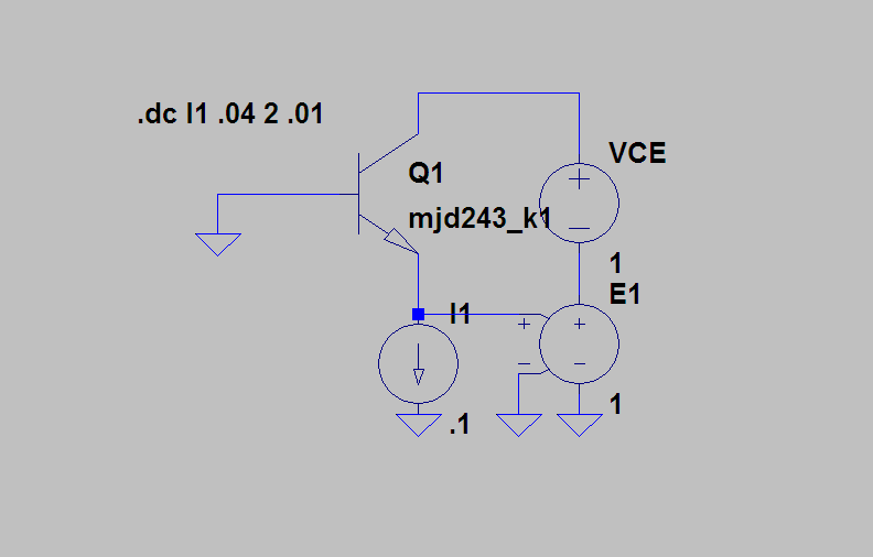

I'm trying to make my own models. Following Andy_C's instructions, I was able to plot hFE vs Ic, but can't figure out what expressions to use for the following:
1. Plotting Vbe vs Ic
2. Plotting B (Beta) vs Ic
3. Plotting fT at Ic = 100mA and 300mA
I'm sure you can help... the spice circuit setup is attached.

For Vbe vs. Ic, just click at the Q's emitter. Left-click on the bottom ruler in the trace window and deselect the logarithmic option (for other graphs the X axis is usually logarithmic, but not for Vbe).
Hfe and Beta are the same in andy's article if I'm correct, and it worked for me usually.
Now for Ft, set up a .ac analysis, right-click on I1 to give it the desired current, and then plot Hfe (Ic/Ib). Ft will be, if I'm correct, the point where Hfe crosses zero.
I can give a file to test Vcesat as well.
What is your aim though with the MJD models? I think I checked and they are surprisingly accurate compared to the throw-away models one usually encounters. (not to say there's nothing more to be desired...) And BTW you may be interested in the BD787/788 which are very similar, in fact they could be the same die, I had a hard time trying to find the difference.
This can get tricky since Andy doesn't describe the relationships simply between IKF, ISE, NE... Just so you know, I have some experience here and can help if necessary. (there are a few things I can't figure out myself though, which makes me wonder how on earth I managed to finish my 5769/5771 models...)
And by the way, I generally use the _k signature on my models to distinguish between them and the old models. It might be confusing if we use the same signature, if it matters.

I think my model is way, way off, but, I'll get there... I couldn't figure out your instructions... could you make plt files, save them and send them back?
I've attached the sim files with the one plt file I have - the hFE vs Collector current.
If I every have a model worth sharing, I'll append it with either KL or K3 😛
Ken L
First, generally the Y-axis is usually not logarithmic, so they might look weird. (to change the law of you axis, you click the rulers at the edge of the trace window, and it brings up a box. And notice I said left-click, not right-click)
I don't know why you're messing with .plt files, I never even knew they existed! All you do is enter the equation Ic(Q1)/Ib(Q1), and you've got Hfe vs. Ic. The X-axis will always be the value of I1, because you're running a sweep simulation and that's the source that's being sweeped.
What exactly did you misunderstand?

I got stuck at Andy_C's Ic vs Vbe and B vs Ic;
step 7. Using the circuit of Figure 11, plot Vbe vs Ic. How do I do this? I'm presuming that I want the y axis to be volts and the x axis to be Amps.
I understand how to change scales, I don't know how to describe a math expression of "vs."
Sorry for being so thick.
Ken L
If you want to change the quantity on the x-axis of an LTspice plot from its default, it becomes a so-called "parametric plot". I'm going to be a bit lazy responding here. In the LTspice help, choose the "search" tab. Enter the word "parametric" (without quotes) in the "keyword to find" box. You should see one topic, "Axis Control" come up. Check out the instructions for parametric plots found there.
So, I figured it out, I was trying to plot Ic instead of Vbe, plotted Vbe and put Ic on the bottom plot. The voltage reads negative, so I multiply it by -1 to get positive and it looks like the plot in data sheet. Do I have this right? I'm measuring the voltage at the emitter of the transistor for Vbe, and Ic is the current at the collector of the transistor.

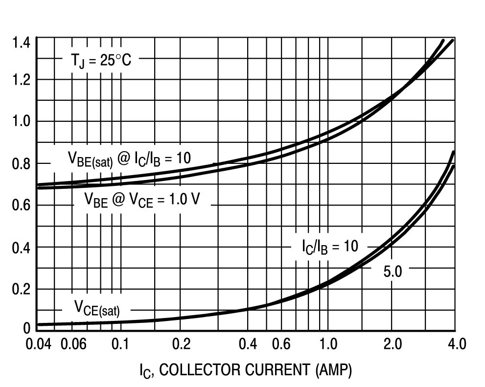

If I have the above correct, then, I running into another issue, the maximum current in the model is somewhere around 3.4A, where the data sheet shows it going out to at least 4A and probably beyond. I haven't found the variable that will move this out further. Any thoughts?
Two variables come to mind, Rb and Ikf.
I suggest you remove Ikf, Ise, and NE from the model temporarily... And follow the instructions copied from Andy's page:
Improved SPICE Models for MJL3281A and MJL1302A - Section 3
  1. Keep the manufacturer’s model values for the device’s forward parameter VAF and reverse parameters BR, NR, VAR, IKR, ISC and NC.
  2. Assume NF = 1
  3. Permanently remove RBM and IRB from the model.
  4. Set RB initially to zero and temporarily remove IKF, NE, and ISE.
  5. Pick an initial value for BF equal to the maximum measured β at room temperature.
  6. Start with the manufacturer’s value of IS.
  7. Using the circuit of Figure 11, plot VBE vs. IC.
  8. Adjust IS so that VBE at IC = 100 mA matches the datasheet value.
  9. Adjust RB so that VBE at IC = 1 A matches the datasheet value.
  10. Using the circuit of Figure 11, plot β vs. IC.
  11. Adjust IKF so the reduction of β at high currents matches the datasheet as closely as possible.
  12. Using the circuit of Figure 11, plot VBE vs. IC.
  13. Adjust IKF and RB so that the VBE values at IC = 1A and IC = 10 A match the datasheet values as closely as possible.
  14. Change the setup of Figure 11 so that the VCE source takes on values of 5 V and 20 V.
  15. Adjust VAF so that the variation in VBE at IC = 20 A as VCE goes from 5 V to 20 V matches the datasheet.
  16. Change the setup of Figure 11 back so that VCE is fixed at 5 V again.
  17. Plot β vs. IC.
  18. Adjust ISE, NE, IKF and BF so that β vs. IC matches the datasheet as closely as possible.
  19. Plot VBE vs. IC.
  20. Adjust IS, IKF and RB so that the VBE values at IC = 100 mA, IC = 1A and IC = 10 A match the datasheet value as closely as possible.
  21. Repeat steps 17 – 20 until both VBE vs. IC and β vs. IC match the datasheet as closely as possible.
If you leave IKF, ISE and NE in you will be dealing with with a multidimensional nightmare... So start with Is to get the Vbe right, and go from there.
We generally start with an otherwise perfect model, tweak the Vbe variables to make it perform like the device at low currents, and then add the high-current behavior parameters.
