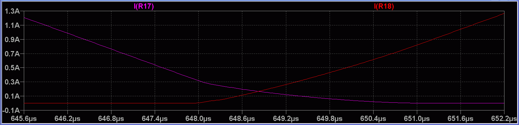

Andrew,
You may not need that much. Here is the (simulated) crossover event depicted by the source resistor currents on a mosfet AB output stage. The pmos (R18) is rather more linear than the nmos (R17), but you can see the transition is well controlled with no sign of ringing or instability. This is into 8R//100nF, a difficult load, at 1KHz.
Quiescent current is just over 150mA.
I feel that modern mosfets do not lose out too much to bipolars these days.
Hugh

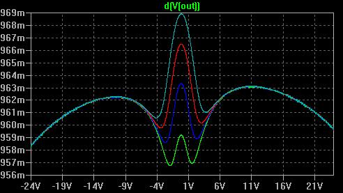

Perhaps this diagram might further elucidate the point, n'est pas? You can see that the crossover 'dysjunction' is in fact unbelievably clean. The whole notion of crossover distortion is somewhat overhyped, I feel.
Hugh
Spiced
It takes a bit of juggling with formulae, but LT Spice can be made to produce a wingspread diagram - a highly graphical representation of semi crossover behaviour at stepped power levels. I know AndrewT has read the old thread this came from.
The benefit of wingspreads is obvious, as can see at a glance how very wide the region is, at about 13 volts with the Toshiba VFETS simulated here.
As AKSA points out, the absolute discontinuity is quite small, in the mVs, but we love to fret about anything that doesn't look straight. 😉

Wingspread assumes a fixed bias spread that reacts slower than the lowest audible
note (usually just to temp) , or not at all. Fast corrections that watch and correct
both voltage and current errors in time with music like Hawksford, Circlophone, and
SRJLH do not leave wingspread to match by chance, but take control and shape it.
Since this feature can be implemented with as little as 3 added components, I think
its a waste of time to worry about a problem that need only exist in legacy design.
I can match MOSFET to BJT with near perfect AB crossings, not even a problem...
