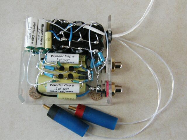

B.J.T.
Buffer with Jfet Transistors. Jfet buffer with Toshiba K170s biased at 4 mA. Borbely topology based on White cascode follower. Point to point wiring with four nines silver with loose teflon sleeving. Corning RN60D resistors, Sidereal, Wondercap, Panasonic HFQ, and Rifa caps. Silver soldered.
H.H.
H.H.

hi harry,
well it looks like it's been months since anyone posted in this thread but i was just doing a search for "JFET BUFFER" and i came up with your little baby here. could be very useful in Son of Dork! how does it sound? it is capacitor coupled obviously but do you find the strengths of the circuit overcome the coloration of the caps?
