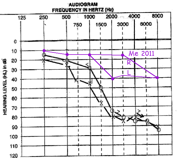

I was going deaf. Faster in left than right (odd but not unusual). See image of my hearing in 2011 (over-laid on my Dad's curve, suggesting I am my father's son).
Mine was progressively but consistently worse over several years. There are other ear conditions where hearing fluctuates day by day. Minor colds and clogs; also Meniere's.
In most lands, an initial hearing test is free or cheap.
