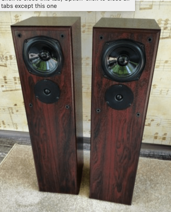

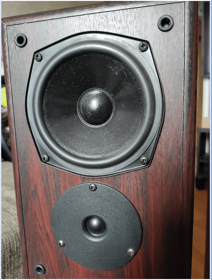

i recently refurbished a pair of Revolver Purdey speakers for someone else. I replaced everything as they were twenty years old and the woofers were visibly cracked and worn. Having completed this project and getting a lot of satisfaction from it I am tempted to take on a new challenge; build a set of speakers from scratch. ( I am good at woodwork and there was very little woodwork in the last project). The tweeters, Vifa D19TD-05, from the last project look to be perfect. They are twenty years old though. Are they still good, or would it be foolish to put them in a new build?
I plan on making a set of bookshelf speakers, the Classix II, https://sites.google.com/site/undefinition/bookshelf-speakers/classix-ii with the Dayton DC160 and the above mentioned Vifa tweeters. The last project involved floor standing speakers but the consensus was that the whole configuration would work better in a smaller cabinet which is why I want to make bookshelf speakers this time.
Looks like a KEF-B110-look alike + the famous 19mm VIFA tweeter in an ML-TL.

It can be done. Ideally a 6.5" is most comfortable crossing to a dome near 2kHz. It might be stretched to 3, and many take it even further... but the thing is the D19 doesn't give you the option as it doesn't like being taken low.The tweeters, Vifa D19TD-05, from the last project look to be perfect.
I would build the Classic II exactly as specified, they’re great speakers. The DC 160 doesn’t like being crossed much above 2,000 Hz and Paul Carmody put a lot of work into the crossover, anything else won’t work properly.
I would sell the old Vifas, as I’m sure someone will want them. I have them in a pair of 4” monitors, crossed at about 3,500 Hz (I think).
