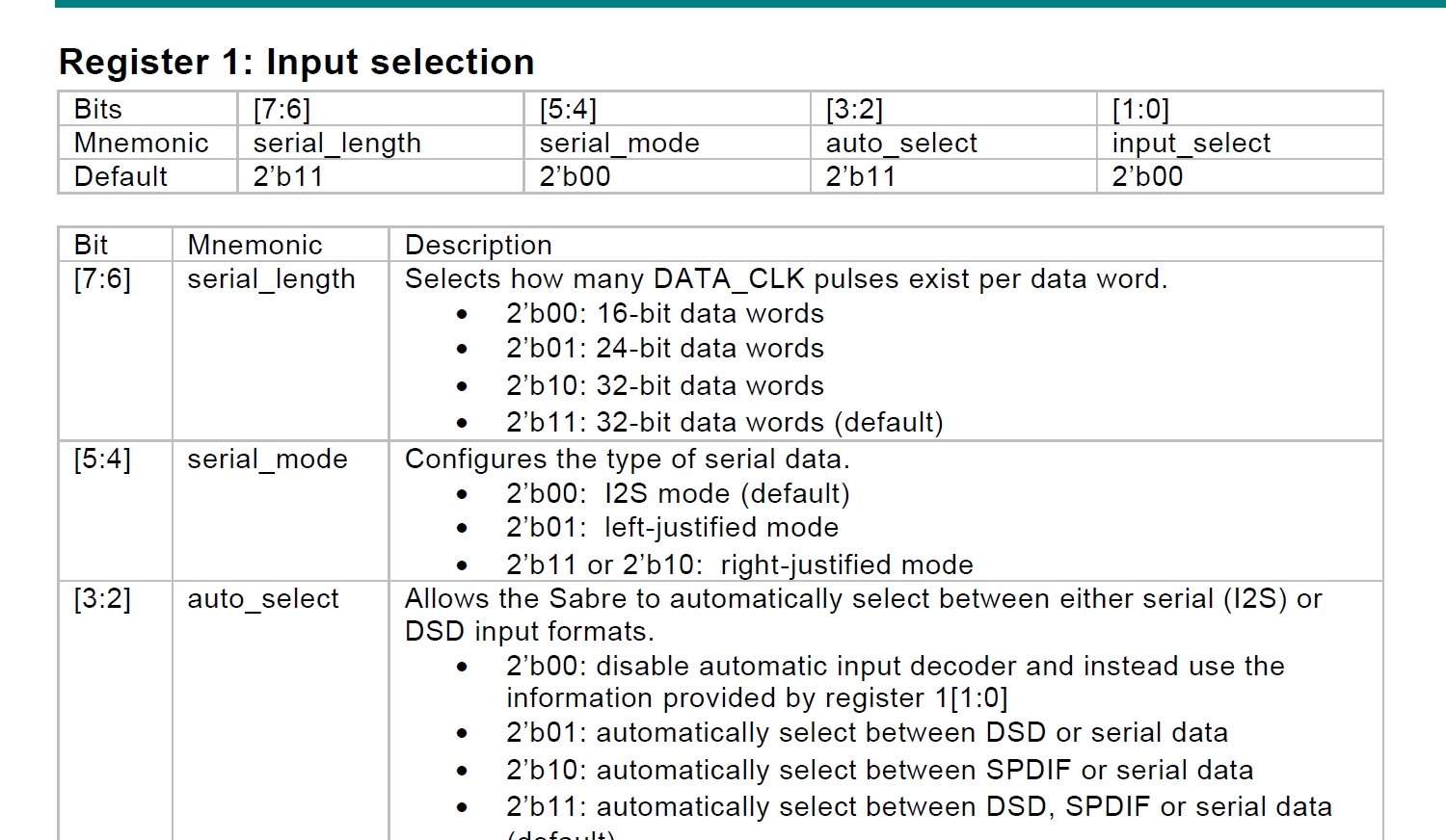

Counting the number of pulses won't give you the bit depth, just the frame size. You can have 16-bit data in 32-bit frames with only 16 active bits. You can also have 16-bit data in 32-bit frames with all bits active. Both would have a 16-bit bit depth.
Matter of definition. IMHO as a practical matter word size going into a dac includes any padding zeros.
Bit-depth of original source file is another matter. There are VST bit meters for that. A scope can be useful too.
Please see excerpt from ES9038Q2M datasheet below. How do you know OP wasn't asking about the meaning in that context?
