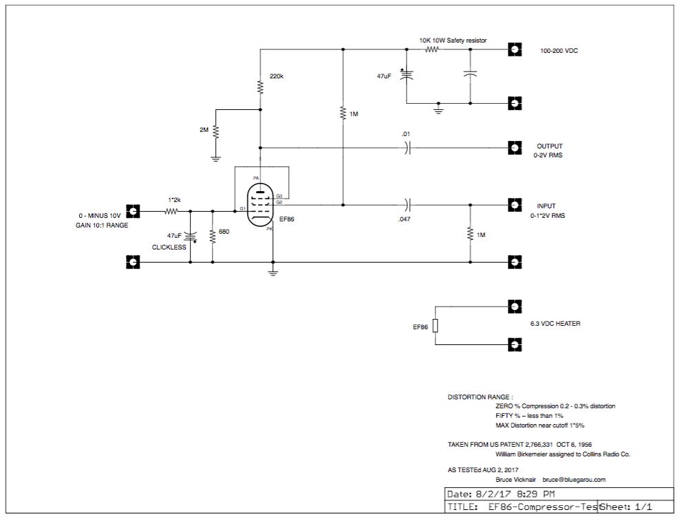

Birkemeier audio compressor
I threw this circuit together and it is 100% functional as advertised.
My proto on bench is using lab supplies for dc filament, variable bias and variable B+. I've tested B+ 50-275v.
Don't have a 6BA6 at the moment so used a sharp cutoff EF86.
It works fine too. Only difference is control range is more narrow.
Problem is can't get distortion below 2%. Interesting it remains fairly constant across the compression range.
Circuit from expired Collins patent 1956.

In a compressor VCA, the "bias point" is set by the sidechain, as demanded by the amount of gain reduction needed at the moment. Direct-heat is a minor detail. Generally the type of tube curve is critical, and it is futile to wish to use this or that tube.
jfetter -- the Birkemeier patent claims the Plate Current is "constant" as the control voltage varies (for some unspecified P and G2 resistances). Is that the case?
It matters, because conventional AVC/VCA worked single-ended "thump". Gain is varied by causing a large change of plate current. In audio limiters, the attack time is equivalent to a low bass thump. Some compromise must be made. The high-end is push-pull to cancel thump, but transformer balance and heft are critical. Non-transformer drive and recovery are either less happy or more complex. A VCA with very low current shift over a large gain-range could be super-interesting.

Its still on the breadboard and yes need to understand more about it .
The dc shift on anode is indeed low. Had to think about it some more. The low-z control is maybe a hint. It almost operates as though the signal is summed and shunted on g1-g3. I have analyzer software but this ckt is still in functional test.
After its fully understood will use auto test pulse, dist and sweep plots.
I use a manual bridge dist analyzer and scope during early circuit vetting.
Then as more refined move to pc.
The control voltage can be low impedance-- we got opamps.
What range of CV is "useful"? When too negative the tube cuts-off and output is too small to use.
When you sweep the CV from zero to that low limit, how much does the plate voltage change? (Mention the B+ too.)
Ill check as soon as can get a moment. Thats an easy test but can't do it till Wednesday.
I remember it was at least minus 12v for cutoff.
Thats why said minus 10v. B+ was 140 but its not critical.
