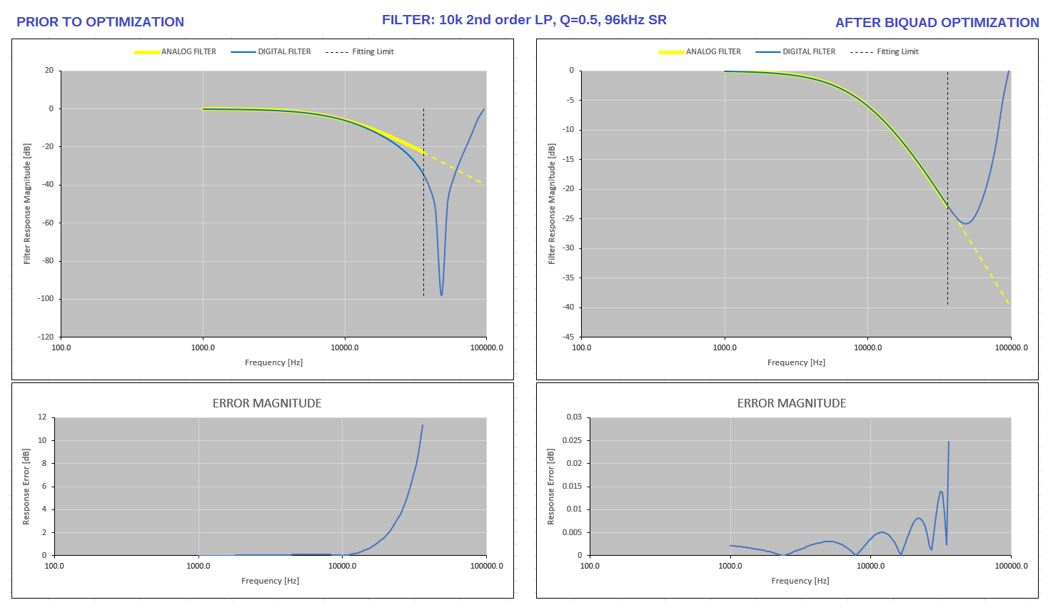

Sorry to bug you again but I got the correct response just two pole low pass at 10K, 96K sampling Q = .5 but the coefficients make no sense.
I wanted to give your filter a try. I used ACD to generate the input values. These are:
analog coefficients:
a2 = 0
a1 = 0
a0 = 3947841760
b2 = 1
b1 = 125663.7061
b0 = 3947841760
IIR digital coefficients:
b0 = 0.06422539
b1 = 0.12845078
b2 = 0.06422539
a1 = -0.986290852
a2 = 0.243192411
Results:
OPTIMIZED IIR FILTER COEFFICIENTS:
b0 = 0.064543481
b1 = 0.173126494
b2 = -0.010531462
a1 = -1.049711599
a2 = 0.276921804
The above values were obtained when the optimization was carried out between 1kHz and 36kHz. I moved these up because of the higher sampling rate. I can only assume that your starting point was too far off for the SOLVER to get a stable result.
This particular filter shows why this is mainly (for audio) a problem with 44.1k and 48k SR. Here, when we have moved up to 96k SR the deviations in the "unoptimized" IIR digital filter are getting to 1 or 2 dB only by 20kHz or higher. It's been well demonstrated that even if you claim you can hear up there (not many can) there is no sensitivity to changes in the response of only 1 or 2 dB. With the lower sampling rates, the deviations move down into the range of hearing where they can start to be noticed. Hardware and software that can do 44.1 and 48k SR IIR filters is now getting more common and inexpensive but the same can not be said for 96kHz SR. Since I want to use a more affordable solution, I am left to tweak the IIR filter in order to get it to do what I want.
Pics attached:

Just a follow up. I dragged out my simulated annealing Python code and yes the answer in post 21 is a good local minima, certainly good enough for any reasonable purpose.
It took 7 or 8 tries for me to find the global minima which is better but sort of needless resolution. To jcx's point, I don't use the coefficients as input to the search but use the poles and zeros in both s and z domain. It then becomes trivial to search only inside the unit circle.
I might also add that that with finite poles and zeros there is no possible exact fit but (I can't prove this) the global minimum seems to be the only one with the most ripples in the residual error. See my pic of the 48k RIAA solution.

I agree that if I had the transfer function in the "poles and zeroes" factored form it would be very easy to determine if all poles were inside the unit circle. But don't have that. What I have is the coefficients, which I can generate for a wide variety of filters, basically all the filters that one would want to use for a loudspeaker crossover. It is POSSIBLE to factor the resulting polynomials into the factored form, but that is more coding effort than I want to do at this time. Since the optimization can be run on the coefficients directly that is the easiest to implement without adding a bunch more code that may or may not work well. I will keep it in mind, however, for later.
Also, I don't see a real need to find the global minimum. How do you know you have that anyway? Practically speaking one needs the filter to be "good enough" and there certainly is a lot of wiggle room in how you define that. For instance, if you simply change the maximum frequency of the interval over which the optimization is conducted the "optimized" coefficients will change because the problem has been reformulated.
As I mentioned a couple of posts ago, clear limits can be established for the magnitudes of the coefficients in the case of a stable system. One can use these to constrain their values during the optimization, and I might investigate this as a way to insure stability even in the case that there is gain.
