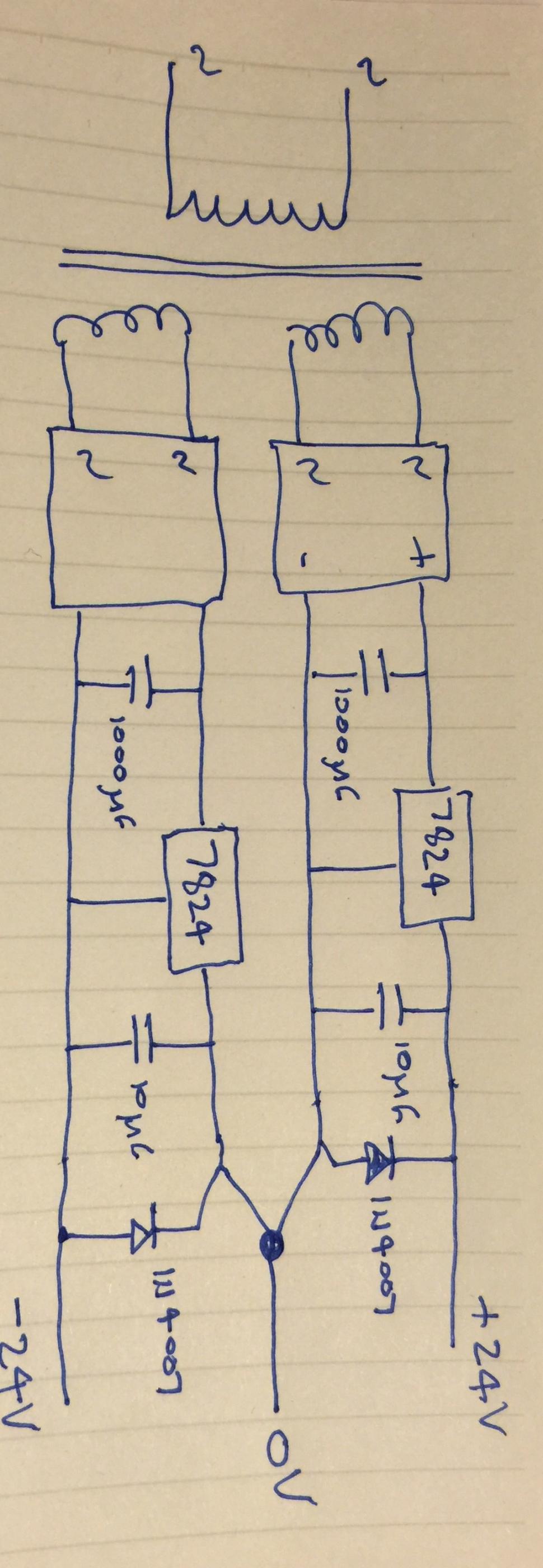

The Sparkos products look very good. I don't think their opamps will best a 4562 or 797 and some of the newer opamps out there. If they are using TPC, then there is no reason why their PSRR should not be very good either. Remember, although most opamp output stages are class B into heavy loads, they are assuredly class A into typical =>10k loads.
For your regulator, if the total current draw is reasonable - 10's to a 100 or 200mA max, then using a single output winding AC wall wart can work. However, if you are looking for the best performance, I would build a decent power supply in its own housing with pre-regulation and supply DC into your main audio board which would then have local regulation.
You can use 7824 for the pre-regulators and 7818 for the on board regulators.

What is the advantage of using the same regulator (78xx twice), once for pre-regulation?
All of my two channel preamps will be well under 200ma, and even a 6 channel mixer could fall under 200ma.
So I'll think on whether or not to do a dedicated supply box. The idea was to have a generic solution for most of my future builds.
Many 3pin IC regulators have pretty terrible performance above 100kHz.
Interference that gets past the isolating transformer, then passes through the regulator with little attenuation.
The HF garbage can reduce the performance of the analogue circuits that depend on a clean supply.
Adding a good pre-regulator topology can very significantly reduce the interference that passes through to the analogue circuits.
+1. That 'pre regulator' strategy can be as simple as C-R-C, (say 4.7-10ohms between two modest reservoir caps) - and do an admirable job wideband if laid-out well.
