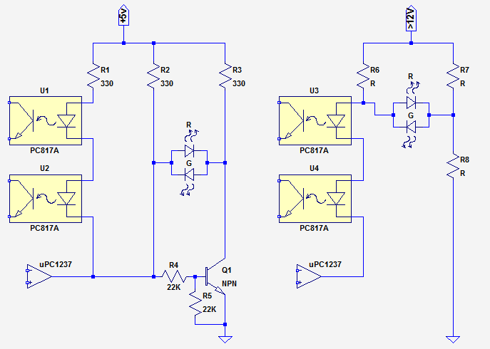

Here is an example with a NPN, current through the LEDs = 10mA (can be adapted by scaling the resistor's values).
On the right is an example using only resistors; to be able to use it, you'll need a comfortable enough supply voltage, 12V or more should be sufficient.

If you look at the schematic i posted, the mosdriver isn't connected to the 74HC14, not needed.And with the HC version 10mA led current is easely reached with parallel outputs.

Yes, I noticed amendment, but please realise I'm using the 74AC14 device now and due to past issues with driving mosdriver plus other devices from same signal I presumed it would be better to have some form of buffer between what is 'essential' and 'indication' levels of function.
I was considering abandoning any 'fault indication' due to potential compromise last week. Now I have solution... cool... thanks to all.
Device cost is not an issue.... I'm not in production of 10,000 widgets.
High speed, High reliability of essential and indication function ...with
Low component count and board space the priorities.
So, it follows, given the de-rating of output device, [50% loading]
What merit is there, if any, in parallel connected invert gates driving the panel indicator LED other than using these redundant outputs in a hex package?

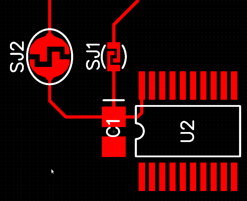

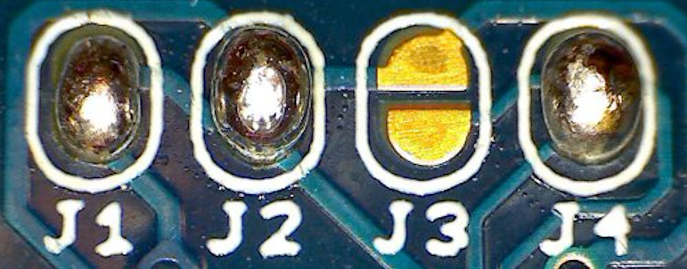

Arrange the PCB layout so that it's especially easy to try both variants of the circuit. Either by making a solder-bridgeable open circuit, or by laying out an intact trace that's especially easy to cut without injuring anything else nearby. Then try it both ways.
(Or perform the experiments in vitro using through hole components on a solderless breadboard, if you feel your perceptions and measurements in the lab are a good predictor of your perceptions and measurements in the audio salon on the finished gear.)

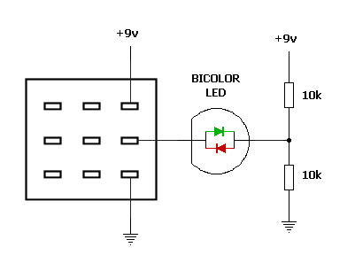

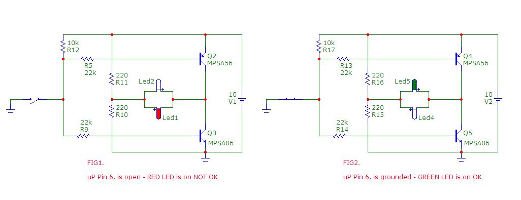

Took your advice Gareth, here is my take on the second para of post#1. You would have to calculate the resistor values depending on your supply voltage and the current you will allow through the LEDs. Hope it solves your problem "Shh its me"
Obviously when the power is off then no LED is on. 🙂

Regrettably you didn't read properly the first line of the first post
Yikes you are right. I only read the first half of the first line! Please accept my apologies.

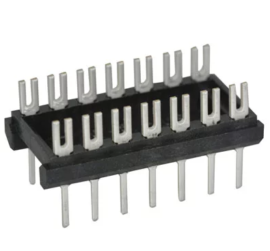

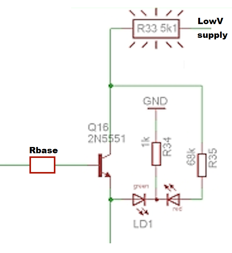

If you mounted the components on a DIP header like we used to do in the good old days of wire-wrap ('cause the only WW sockets were DIP sockets!), you could use the first 3 rows to mount the BJT, and the remaining 4 rows to mount the four resistors. Voila it all fits in the footprint of a 14 pin DIP. However the 68K resistance of R35 might make it a bit tricky to match the brightness of the left and right LEDs. The right LED gets, what, 180 microamperes?

I'd be tempted to put it into Spice for the circuit conditions you have available and then tinker around to find what works - I'm lazy (I think you remember that !!). The circuit I posted was an excerpt from a dc-protection circuit and the resistor values were dictated by the surrounding circuitry - I think the collector was fed from the +ve rail of the amplifier so it was 40V or so. I like that DIP idea, keeps it simple.
This is similar to a circuit I considered and tried.
The 'problem' I have with this is the load of R10 and R11 [220 +220 ] across supply and more so the 'dead short' presenting if both transistors receive an oscillating base signal.
To prevent this 'dead short' I changed PNP to NPN and NPN to PNP, so if such signal occurred no conduction at all.
