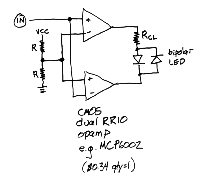

If you use a digital logic IC to drive the LED {and indeed that is exactly what I would do, myself}, there are a few constraints that need to be met or else it'll fail and possibly catch fire
Then wire up the logic gate IC to form an H-bridge, where you drive the left end of the (LED + series resistor) with Signal, and the right end of the (LED+series resistor) with SignalBar. If you happen to select the TC4428 integrated circuit made by Microchip, this becomes especially straightforward: all you need is one single 8 pin IC, because half of it is inverting and the other half is noninverting. Nice!
- The IC's output-High current and output-Low current must both be large enough to illuminate the LED brightly. That probably means IOH>15mA and also IOL>15mA.
- You must power the IC from a constant DC voltage source that's within the IC's specification (5V for TTL, 3-15V for CMOS, 4.5V-18V for TC4428)
- The input signal you apply to the IC ("Fault/OK") must meet the I/O voltage specification of the chip. Can't apply a 30V signal to a TTL chip!

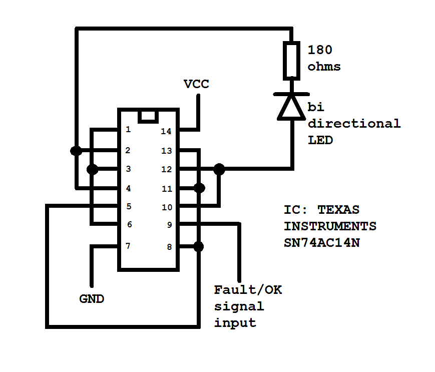

The 3rd best way to design this circuit, is to use the Advanced CMOS ("AC") line of logic ICs from Texas Instruments. They have plenty of grunt: IOH=24mA and IOL=24mA, so they can drive most panel indicator LEDs to full brightness.
The diagram below uses the hex Schmitt Trigger inverter device called SN74AC14N. Mouser.com has many of them on the shelf, ready to ship, at a low price: (link). You could down-regulate your amplifier's high voltage positive supply, to the necessary +5VDC, using a 5.6V zener diode, a MPSA42 high voltage NPN transistor, and a 20K resistor. Just be sure to connect a 100nF bypass capacitor within 0.2 inches of the AC14's VCC pin. It is a very Very fast digital chip and needs stiff supplies or else the fast transients can make it self oscillate. You don't want that.
Observe the very low parts count: one 14-pin IC, one current limiting resistor, and the LED itself. I'm deliberately not counting the +5VDC voltage regulation parts, because all of the best designs need a voltage regulator of some kind.

MarkJ, you have done all the work, but would it be too much to ask you to explain the logic that drives the LED in either direction?
Do you know of a tutorial that shows how to draw up a logic table that gets to the required interconnections?
If you redraw the circuit using the logic symbols found in Figure 1 of the attached 74AC14 datasheet, that will get you 95% of the way to the end goal: understanding what's going on. I've also attached an application note that highlights many of the reasons why Schmitt Triggers are righteous and praiseworthy. There is also this article on Wikipedia that explains Schmitt Triggers, and this video on EEVblog.
I've attached the Motorola/ON_Semi datasheet rather than the TI datasheet, because I think Motorola has drawn their Figure 1 better than TI; Motorola's datasheet makes it easier to understand what is going on, IMHO. 74AC14 ICs from Moto and from TI are perfectly compatible and perfectly interchangeable; I just happen to prefer one datasheet more than the other. Please feel free to download TI's datasheet (and also Toshiba's datasheet) if you are curious; you won't find any inconsistencies but you will find different styles of communication.

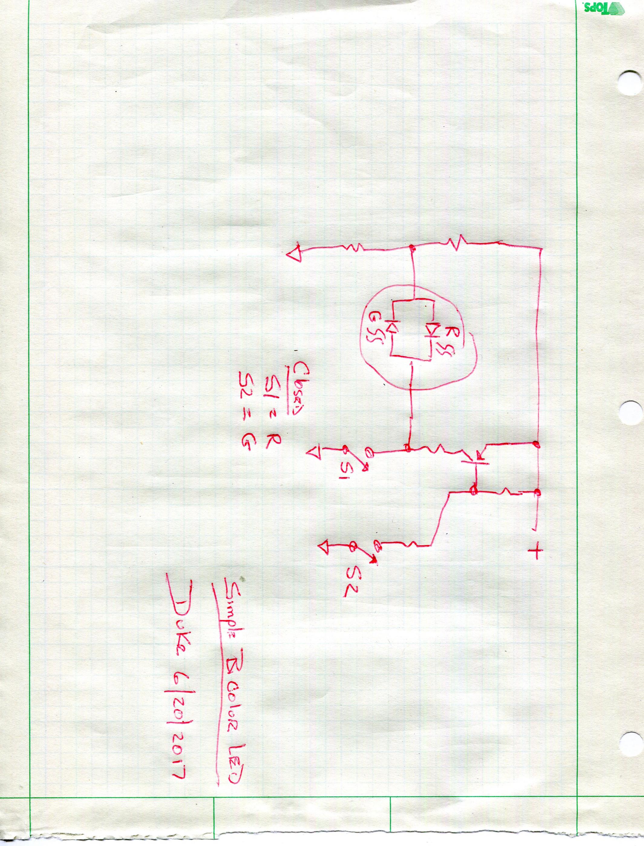

Hi Guys
Food for though.
Why not take my basic circuit in #2 and remove the PNP and connect the resistor to +? LED is RED or GREEN when S1 is changed. No active parts.

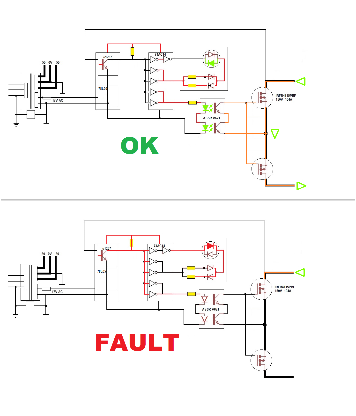

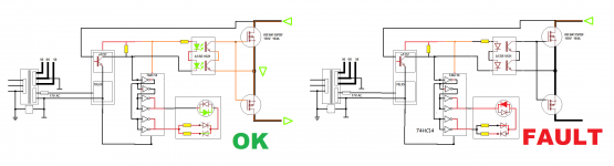

This is simplified application circuit showing u1237 'sinking trigger to drive 'relay' into ON state. amp module omitted.
With opto instead of relay coil load I was getting opto {standard LED in socket to test} dimly lit LED in an OFF state. TR circuit removed no [I suspect] trickle via Tran Base driving the damn thing.
Anyhow - 98% of the way explaining logic levels there..
So, the BiLED circuits prevail.... what about the Common Cat or Common Anode [3 lead] type?
Easy adaptable into circuit below.
But thats where I was running into trouble trying to TR drive it.. Was using NPN and PNP for each LED feed.
