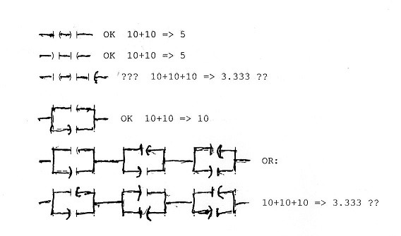

The problem with back-to-back (seperate or integrated (bipolar) is that for 2 x 1V = 2V of signal neither is a diode so you get the series capacitance: i.e. two 22uF gives you 11uF.
But above 1.5V in any direction one becomes a diode, so you suddenly get 22uF, with a diode. I.e the capacitance varies non-linearly with the voltages we are most likely to listen to.

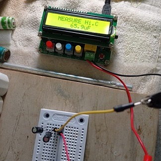

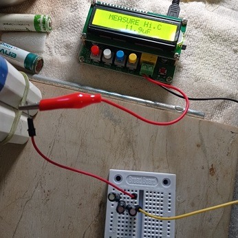

I measured this with bias, no bias, floating and with the electrolytics in series rather than back-to-back:
So the biasing has a small effect (this is steady state, transients presumably are greatly helped). The test was at 250Hz, leading to 5dB attenuation so upto about 5V across the caps, 10% of their voltage rating.
