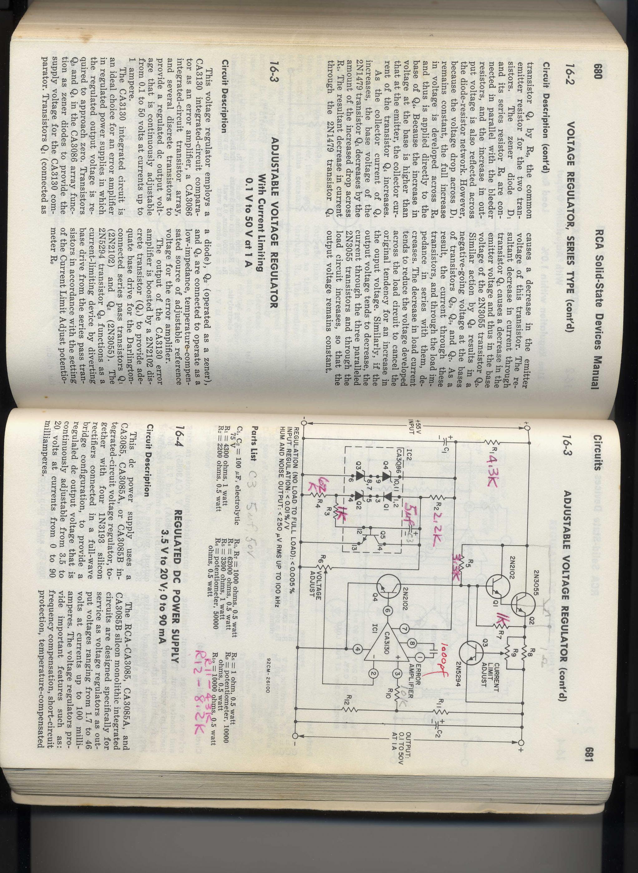

Hi all!! I found a 0-50v, 1A power supply circuit in a RCA SOLID STATE DEVICES MANUAL SC16, pages 680-681. Has anyone here had experience with this circuit. It uses CA3086 as a zener reference and a CA3130 as an error amplifier. Someone said that the RCA line was taken over by Harris Intersil??? I know this is old but I haven't seen anything that will go to + and - 80v. If I wanted bi-polar positive and negative tracking voltages to 80 v, then I was thinking about using mj15003 and mj15004 as the pass transistors. But what is the advantage of having bipolar bjt's versus just building two identical power supplies. It must be tracking ability between the two. I would appreciate any advice and or pointing me toward a an article that is more up to date than 1980. I've looked but they are always Lm337 and LM317 and that's not gona cut it to 80v. Thanks Ray
Thanks, Enzo and Andrew. Yes, the RCA circuit has current limiting adjustment and yes I would like that very much. I would like to know what is the advantage of a mirror imaged bi-polar PS where the - side is pnp and the positive side is npn versus building two identical PS say with both npn pass transistors and connecting them where the bottom one puts out negative voltage. My HP power supply does this and is not mirror imaged.

RCA power supply in solid state manual
OK, I looked at the Jung article and I didn't see much of anything above 18v. I'm sure there are more up to date solutions than this one but I live far from an engineering library. I looked at the Linear Technology at the LT1083 but again nothing that would go to 80 volts. I will build two identical power supplies and connect them where the bottom serves - 80v. But how do I get them to track obviously with some type of opamp circuit. I will use mj15003-4 and the modern mj transistor cor the 2n2102. But I really unsure as to the reliability of the cmos or dmos harris opamp and transistor array.

A major problem of wide range, high voltage/current linear regulated supplies is that unless you use them near their max. voltage, the dissipation and construction cost become enormous. This is why you see so few high voltage linear supplies and those that are about, usually only offer low current.
Jackinnj's suggestion to use a variac or multi-tapped transformer is adequate and much simpler, whilst it could still track voltage reasonably and can easily include the all important current limiting, since amps seldom need voltage regulation but do need this for amp. testing and setup.
Randy Slone published a good, basic and relatively inexpensive adjustable limiting dual supply design. It's on p389 of his "High Power Amplifier Construction Manual" (Mc Graw-Hill) with recommendations for use. This is an older title but easily read and cheap from Amazon etc.
IMO, tracking is nice if you get it for free, but completely unnecessary. I run twin Kepco supplies on my bench and the ability to run constant current is a huge feature I use constantly (no pun intended). You don't just want current limiting for protection, but also the ability to run at an adjustable constant current setting.
Just for fun, download some Kepco, Lambda, HP and similar supply manuals and study the schematics.
