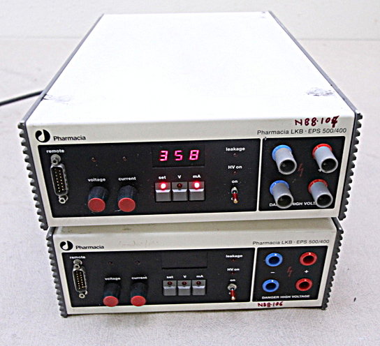

Here are some measurements.
Pharmacia LKB EPS 500/400 unit:
Requires less than 1 mA load to activate (ie, has a no load safety shut-down).
Also has a leakage indicator and shut-down. (a ground fault interrupter safety, detects stray current going to ground, like used in modern kitchen outlets, super safe)
500V, 400 mA, 200 Watt max specs.
Weight 9 Lbs.
Dimensions: 3.75" H x 8.625" W x 16" D (including heatsink and knobs)
(Height not including rubber feet on bottom, another .25") Uses up bench space, but could stack multiple units.
Power switch on the back is very hard to switch. Does have an easy standby switch on the front panel. V and I knobs are small and un-comfortable to use.
Only one digital readout meter, button switchable between actual Vout, actual Iout, V knob setting, and I knob setting. (the extra knob setting readouts are nice, but it definitely needs an extra Vout meter operating 100% of the time)
Has current limiting, with LED V and I mode indicators. Current limiting just turns off the converter, somewhat slow for the Vout to decay.
Euro style deep recessed mini banana plug output terminals (electrophoresis style)
Operates at 28.5 KHz using a flyback converter design using Philips TDA1060 controller chip with a heatsinked TO-5 driver transistor. Single switching transistor, TO-3, (probably bipolar) Heatsinked on the back, no fan. Two resistors on PC board getting rather hot (board browned around the 3 Watter)
Electrical OUTPUT NOISE:
20 Vp-p 60Hz (full load, 500Vout)
4 Vp-p HF switching noise (full load, 28.5 KHz)
Common mode noise: 8 Vp-p CM at 120 Hz, 1 Vp-p CM at HF (28.5 KHz)
Has no line input line filter (60 Hz 120VAC) except two small AC caps to ground. Just rectifiers into 2 x 680 uF DC Caps
Has no output HF filter except 4 x 22uF DC Caps in series.
POWER CONSUMPTION: 11 Watts no load, 33 Watts with 15W load, 218 Watts with 187.3 Watt load (delta = 30.7 Watts loss)

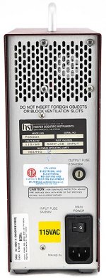

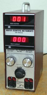

Hoefer PS500XT unit:
No safety features. ( just recessed standard banana plug electrophoresis jacks)
500V, 400 mA, 200 Watt max. specs
Weight 6 Lbs. Has easy carry handle on top.
Dimensions: 10.75" H (+ 1.25" for handle and rubber feet), 4.125" W x 10.125" D (including knobs) Minimal bench space used, nice. Easy portable.
Power switch on back, and also on the front (rocker for PS500X, timer knob for PS500XT) No easy standby switch. The 500XT timer knob version does NOT have a definite OFF detent!! Even rotates around past the off position to ON again! (dangerous!!) V and I knobs are big, comfortable to use.
Two LED digital meters, actual Vout up top, and actual Iout below that)
The I knob sets current limiting, but there is NO LED indicator when running in current limit mode. (annoying) And the current limiting just turns off the converter, it takes 10 seconds!! for the Vout to decay without additional loading.
Recessed standard banana jacks for output.

SUMMERY:
The Pharmacia/LKB unit needs a 2nd digital Vout meter, that is always operating. There is room on the front panel for that addition if the two extra output terminals are eliminated. Unit runs quiet, could be used as a stationary power supply for a tube amplifier, IF the Electrical NOISE problems are fixed.
The Hoefer unit needs added LED V and I mode indicators (at least an I mode LED) added. No provision for obtaining this signal from the controller chip unfortunately. May be able to tap off a crude I mode indicator from the LM358P OP Amp measuring the output current for the controller. (unit does current limit according to the I knob setting, you just can't visually tell when)
The easy V and I knob controls are well suited for bench top use. But needs an easy standby switch added for safety. The fan quieting mod is essential!! I changed the stupid timer/knob to a toggle switch with a BIG insulated toggle handle. (no more need to read the manual to figure out how to turn it off in an emergency!!)
Both units need added line input filtering AND HF output filtering. ESPECIALLY the Pharmacia LKB unit!! Common mode HF output filtering too. Most bench switching supplies use a full C - L - C - CM choke filter on the output. I've noticed that Xantrex XHR supplies also have a shunt Mosfet across the output to pull the Vout down quickly (1 mSec) when either the Current Limit or Over Voltage modes activate. This -could- be added to these units IF an I limit signal is available. Especially useful after adding more filter Caps, since those will further delay the output voltage decay. Might save some tubes from melting down occasionally.
