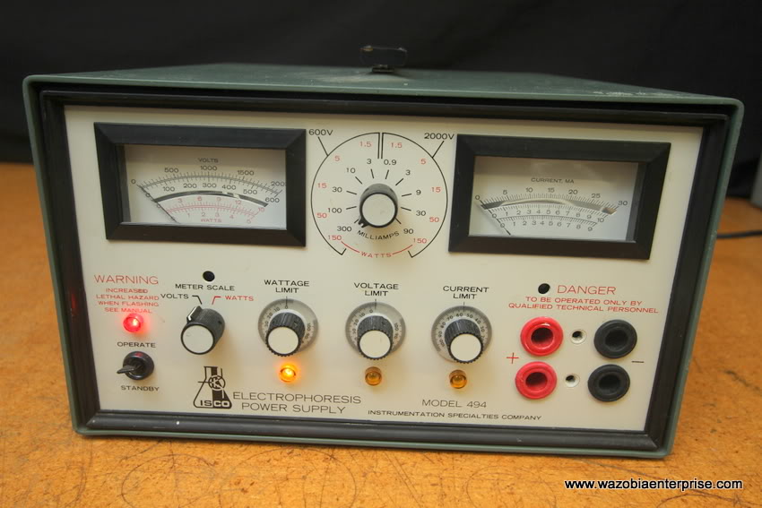

There is a thread on here about an older type one that has been successfully modified by several people. I don't have a link but believe it was the Isco 494.

I had an ISCO 494, by now many samples probably need new capacitors, but it was capable for relatively high voltages. I used it solely for tube testing and got rid of it years ago.

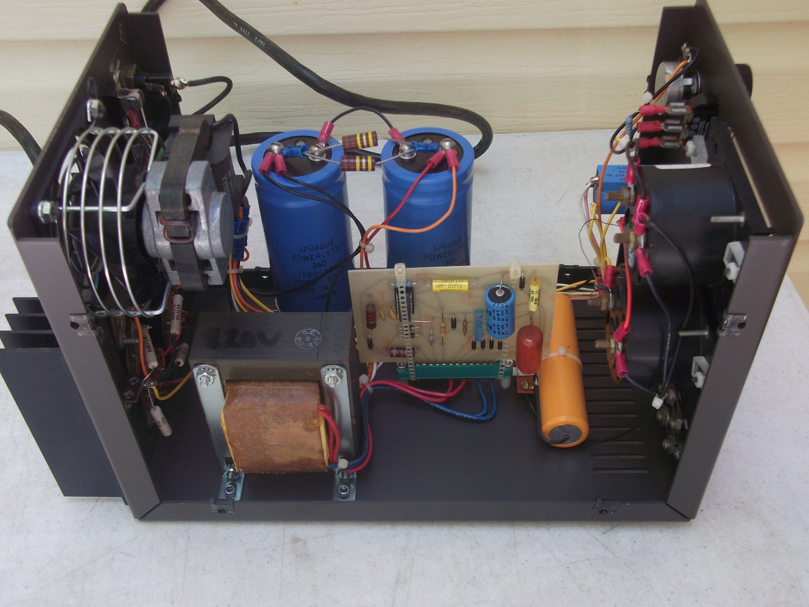

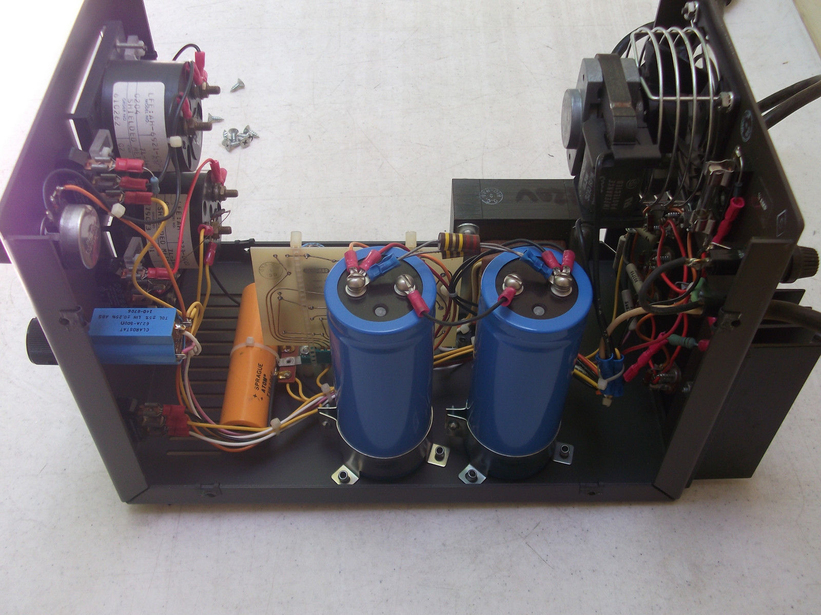

I found a listing for this Bio-Rad 500/200 that shows the insides.
Being rated at 500V 0.2A, I guess the xfmr is about the right size for a linear regulated power supply. Odd place for the fan though, unless there are air passage holes under the heatsink.
Did anyone try this for a power supply? A lot cheaper and more capable than the usual Heathkit power supply.

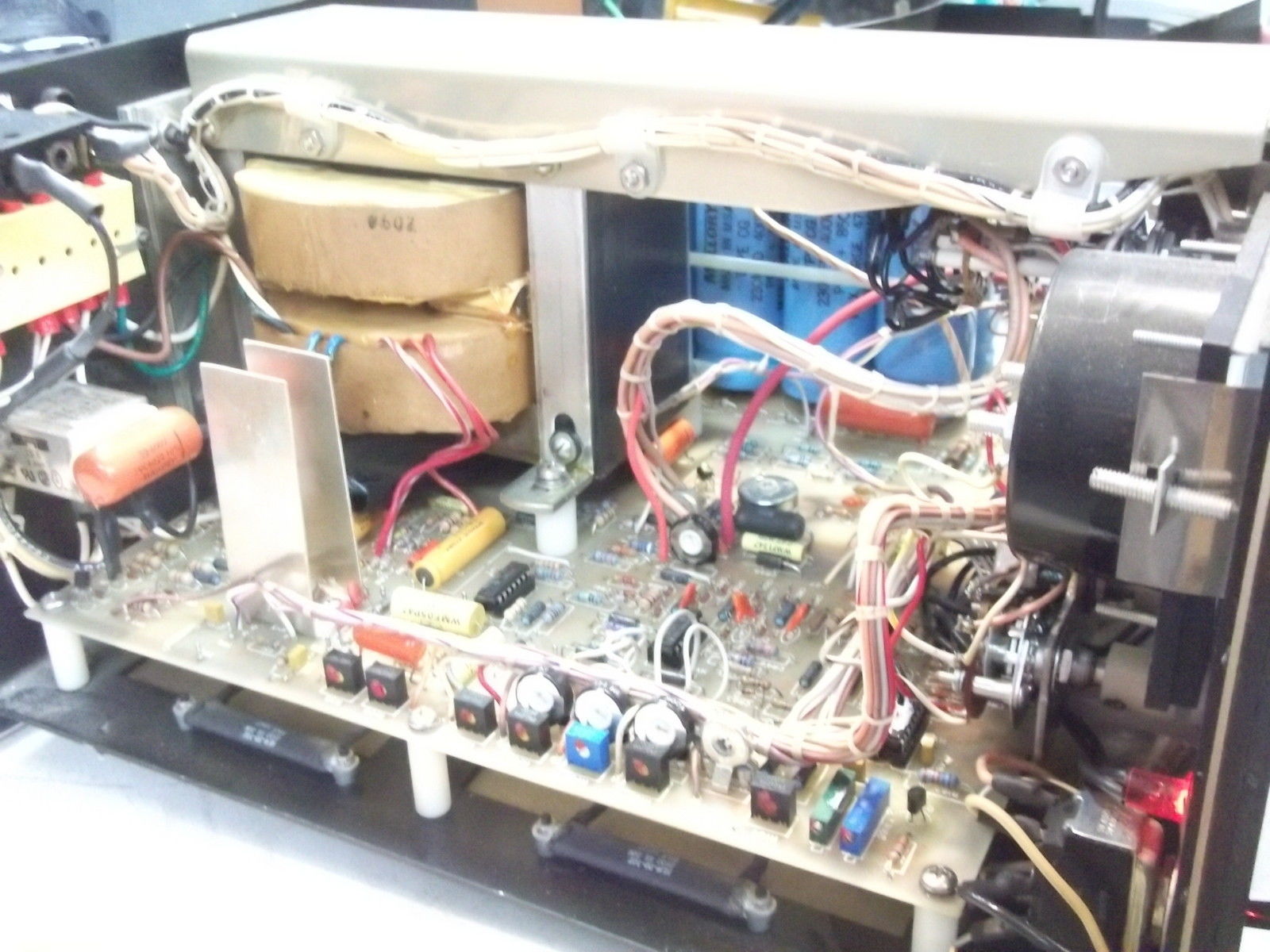

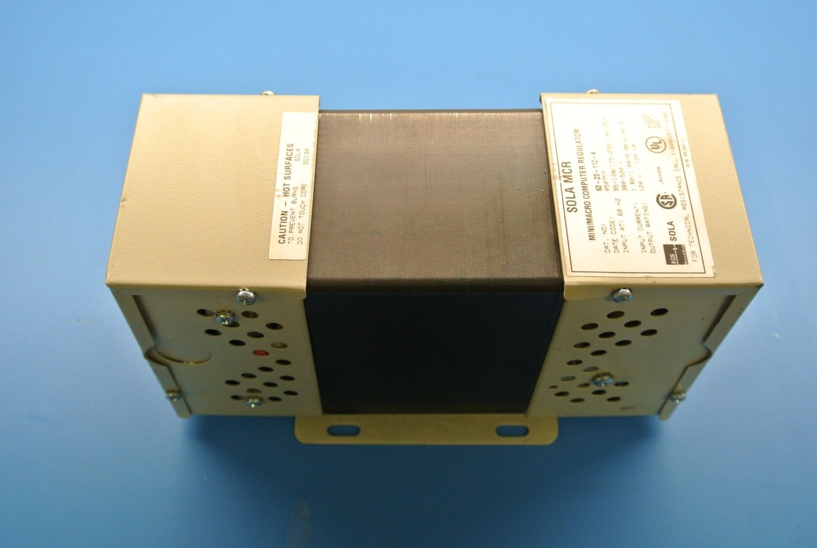

Those ISCO 494 power supplies are still on Ebay. Look a lot more complex. I see a constant voltage xfmr in there, so line V regulated. They are even cheaper than the Bio-Rad, and higher power.

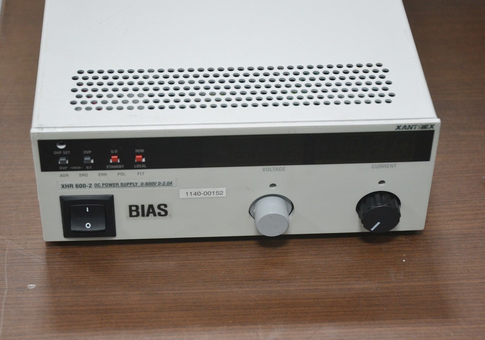

I wonder what tube requires around -600V bias voltage from a 2 Amp supply?
I just got one of these Xantrex XHR 600-2 units in -not working- condition for $120. I usually have good luck getting them to work. But there are several layers of dense circuit boards in there if it's not your lucky day. I see the sense lines connected wrong, some hope.
Speaking of constant V xfmrs (like SOLA CVS, MCR etc type), they have a 600V winding on them for the resonating capacitor, and it is a regulated V (from magnetic saturation) square wave. Would make a nice foundation for a HV power supply. Not too expensive, but you have to add a regulator if you want variable V. (the older CVT type buzz/hum a lot, the newer CVS MCR are quiet)

I have around six electrophoresis supplies of various sorts, including a working Isco 494, a 250V supply from Hoefer, that Bio-Rad 500/200, and a few others including a hulking Dan-Kar 3kV monstrosity that probably has no protection whatsoever. I was interested in a cheap, no-frills supply for evaluating tube amp prototypes. The first one up wins...

The previous Xantrex XHR 600 supplies I've gotten were from during the dot-com collapse when sellers couldn't sell used stuff fast enough on Ebay. Non working ones were like $50 to $100 and good ones were around $300 then. Now the Ebay prices look almost like they're for new ones. 😡 (about $1800 new I think)
The trick is to find one listed as "not working", but most sellers won't admit to that, they'll just say "not tested". A long search to find one cheap now. I do see Sorensen LHP power supplies (re-labeled Xantrex XHR units) go for cheap occasionally. There are Sorensen XHR supplies too, but people are onto to those as being Xantrex XHRs. A bunch of LHPs went for $29 recently (check sold listings). But those are usually lower voltage models.
The XHR 600 is actually using a HF xfmr with four 150 V windings with rectifiers and caps for each, then series DC connected. So a 150V model could be easily tricked into being a 600V model by rewinding the HF xfmr. A cheap 7V LHP could be converted too, with an xfmr change, but that would require more extensive circuit info to re-do the voltage sensing and current sensing. And there are two sets of those, one for the control circuitry, and another for the front panel meters.

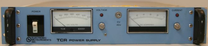

One can find EMI TCR-600 supplies for reasonable prices usually. I've seen them for $50 to $150. They are similar to the HP6448 600V, using a triac 60 Hz phase control. Heavy, probably noisy like the HP, slow regulation. I think the ISCO 494 is a 60 Hz phase control unit too. At least they are efficient.

I wouldn't get any of those phase controlled monstrosities - they're scary. Ask George - he has the HP variety that takes eons to make up its mind that there's a short on its output...
Yeah, those 60 Hz phase control monsters are good for fireworks. With your tube amp blowing up first, THEN the fuse or circuit breaker popping. Kind of like a "foundation coolers" fire department. One could add a linear current limiter I guess.

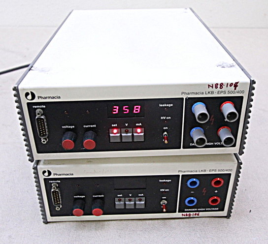

Here we go.
$99, 500V, 400 mA, digital readout, analog V and I knobs, 9.5 lbs, reasonably compact 10" W x 4" H x 17" D (especially if 2 or 3 are stacked ), and looks like it could include a ground fault interrupter (leakage)
(and remote? If it can be programmed for V and I with readbacks, it might be use-able for a PC tube curve tracer?)
There's even one on sale (and working) for just $50! (in Calif.)
I'd like to see what is in these things. With heatsinks making up the case itself and 10 lbs, it could be a linear design, but more likely a HF switcher.
I think I'll get one just to find out.
