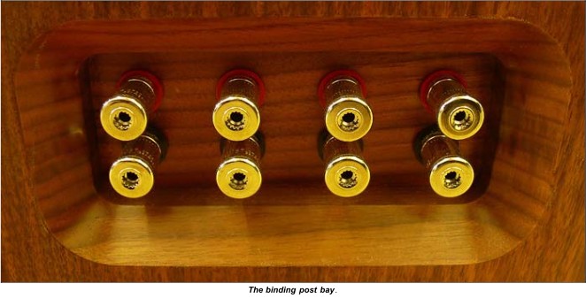

... with this nice upgrade @polk
Goodbye Binding Post Cup. 1.2tl's - Page 2
Notice @vox olympian the space to maneuver around the binding posts with your finger tips. Good design and a lot to be said...
The vertical +/- they are too close to each other for my taste, tough. After all they look nice also (important because usually they are in the back, some in the front, and from here you almost know what is going inside, dynaco's apart...)
(vox olympian pic)

I would assume from looking just at the picture above of the binding post that they are spaced for standard banana plug distances. I know most people here would not think of using a banana plug but people still do that, it is convenient if you are disconnecting the connections for some particular reason often enough. That is why you see the small diameter hole in the center of the center portion. Just try and attach some of the ridiculous terminal ends on many of the so called audiophile cables, all the room in the world won't help with many of them.
Pano,
I always space my binding posts for banana plugs. If someone wants to use them then they can without problems. I have never found that the spacing is to close to attach a cable to them if they are good enough to work and allow the binding post to tighten down on them. I have used some extremely costly cable ends that are a major pain in the rear, I won't name names but they would take a vise grip to tighten up on them..... I use banana plugs also when I am just doing a quick setup, so much more convenient. What I have heard but have not confirmed is that in the EU you can not use the correct spacing for an American dual banana plug standard as there are countries using ac power connectors with the same spacing. Anyone know about this fact or was that just a proposal?
yes, that's right, banana plugs (single or dual) are forbidden for audio use, as the overcautious european bureaucracy fears that someone (kids?) might plug them into a mains outlet. But: you may not sell them for audio use, but privately, in their own homes, everybody uses them.
