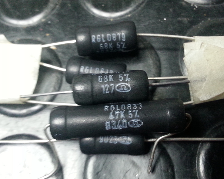

After long listenings, i chose to leave Rhopoint resistors, as z-foils were a little bit "screaming" in certain songs. The same for grid stoppers.
In anode position i found Nirvana using some old Neohm NOS Wirewounds: after quite a break-in, they deliver incredible soundstage, imaging and detail, much better than Tantalum, Amtrans or any other i tested. Just like lifting a veil...

Thanks a lot...can you post a picture of the Neohm WW NOS Resistors ? Maybe I can find some on ebay...I am using typically Mills-NS series...but have the impression that wirewounds are very transparent, but give as well an edigy-metallic sound to the music, so the opposite to warm timbre.

You can find a pic attached. They need a while to break in, after that they sound very good, with incredible 3d image.
They're very open too, so they will reveal every source defect, included HF excess. But Mills WW are on a different, lower level in sound quality.
