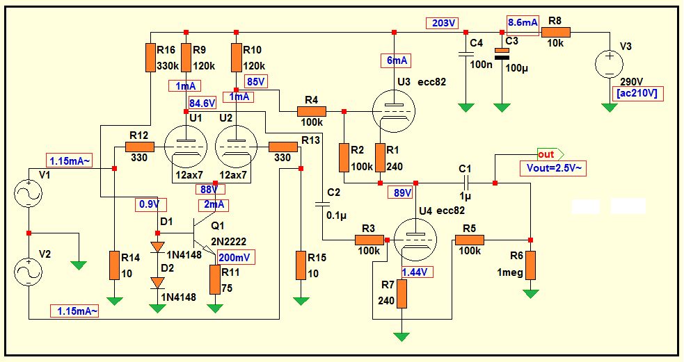

I use the Unbalancer also for a DAC with 4xPCM1704 with great result. For the first stage I use ECC83 (RFT made) and for the second stage ECC82 Tungsram.
For the I/V resistor I use 50ohmi 0.1% two 100ohm in parallel, at the output I have 2Vrms
The other parts are good quality components like 0.1u Vishay and 10u Solen capacitors
In the photo is the previous diagram, only simulation
In the final version only the input resistors have been changed from 10 to 50ohm.
