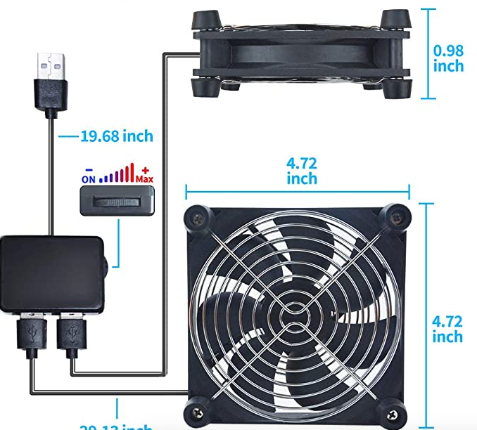

I'm not a fan of noisy fans. That's why I bought one like this:

It depends on how they worked out the fan size.
Maybe it was just thrown in.
Or maybe it was worked out.
Or maybe they tried it and it worked ok ?
I have a Marshall 100 watt guitar amp that is a TDA chip amp with same size fan.
The big mistake was to have the fan blow air in but no output vent !
The case is far from leaky.
The in vent seems to be the out vent too.
