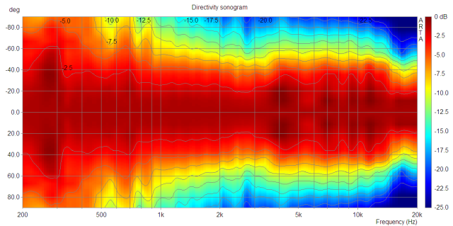

i was a bit too short and general. for example SIegfried Linkwitz and Earl Geddes were both obsessed with polar response, but the first guy understood the full picture a great deal more. their speakers did not even remotely compare in imaging and neutrality. Nathan was flat sounding and no different to a typical econowave. locked in by somewhat high crossovers, large cones and large baffles. the summa even used 15" subwoofer drivers for a large portion of the midrange. id rather have an old school 500hz horn like in the 3-way cornscala than that..
here is the polar map of two types i owned, first looks nicer, that doesnt automatically mean it will image better, but atleast its better than a comparable sized box that beams and widens thruought the range and doesnt match dispersion around the crossover.
so polar response, baffles and drivers that are respectable in the range you want to use them.

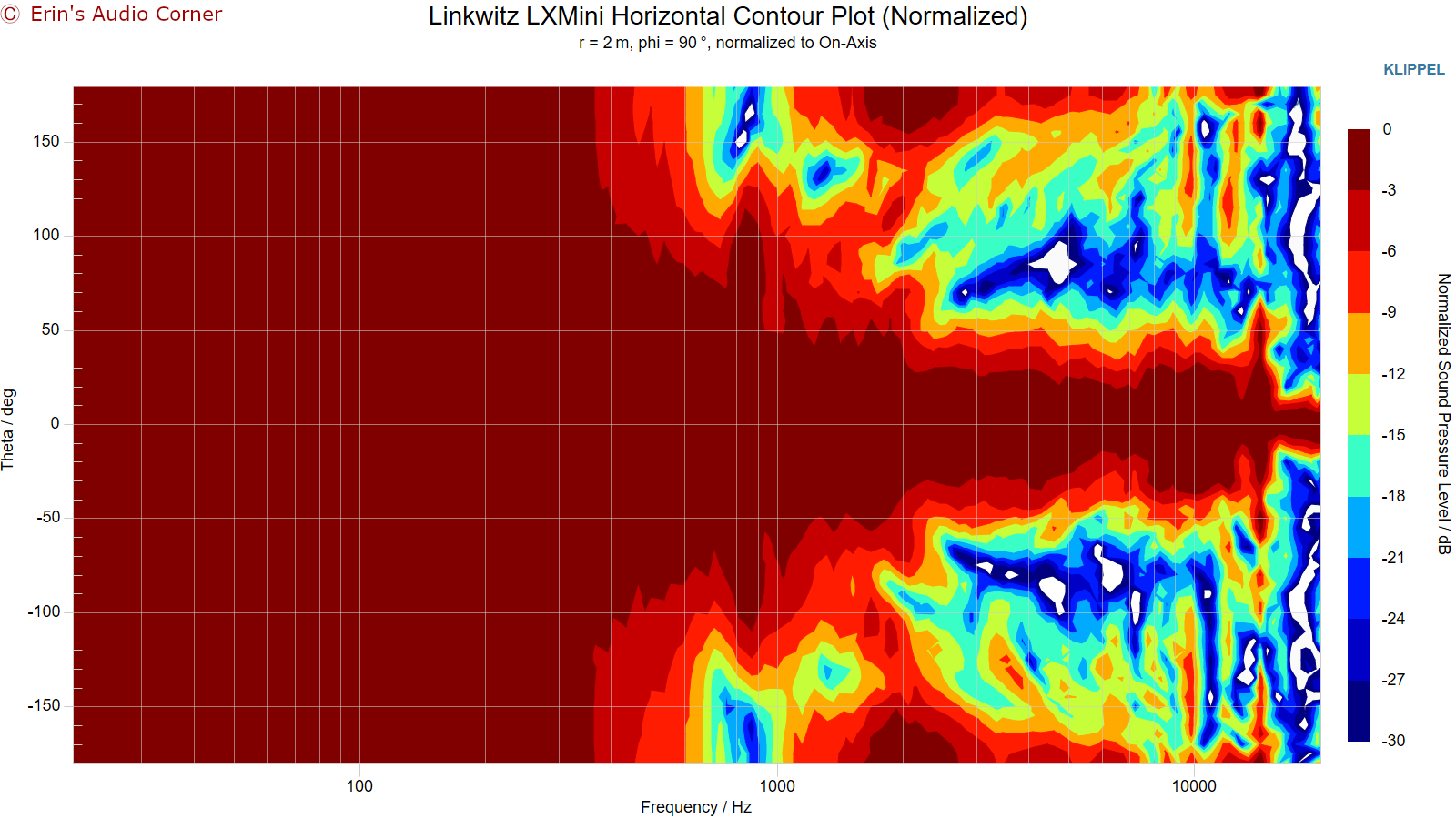

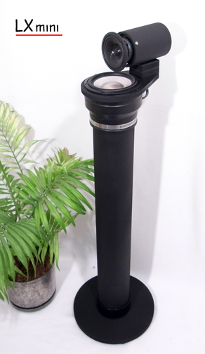

Something else I'd add is listening distance. LX Mini is a cardioid "point source". The drivers are spaced close together. The Nathan is a two way with a large separation. So even if you had the same room and source but used a listening distance that favored the LX Mini it would be more revealing than the Nathan. Furthermore, if one speaker was truly better at imaging it might require a lot of work to actually prove it because you'd have to control all the variables including the listener (e.g. sample a large number of listeners in the same exact conditions).
https://audiosciencereview.com/foru...s-rainmaker-speaker-review.40906/post-2185195
So, evaluate your loudspeakers by listening in mono, and, if they are good, show them off in stereo or multichannel. If you think that one loudspeaker is more “revealing” than another, there are many factors at play, and it might just be a passing coincidence in the combination of loudspeaker, room and recording being auditioned. The powerful influence of recordings and rooms as variables would make this a challenging research project. There are NO standards in the music recording industry – another theme of the 4th edition.
As Greisinger pointed out with evidence, the way we locate the source is frequency dependent, meaning the position of the woofers is less relevant.LX Mini is "point source".
Thank you for putting point source in quotes. While I know what you're saying, it isn't the term to describe it and it has picked up superfluous meaning.
Closer to coaxial systems make it easier to get a smooth cross, however in the hands of someone with the knowledge of Geddes that advantage is not needed.. So there's more talk to be found than description of the problem.
Even a coax is not a point source, and a coax has greater acoustical anomalies than Geddes speaker. He has been called to defend that position regularly.
Do you know what frequencies Greisinger identified as important for localization? I haven't seen his statements on that. I've only seen his discussions on what he called proximity.
The shift in significance is usually quoted as 700Hz and also affects our sensitivity to delayed sources.
Interestingly I find it just as necessary to mind diffraction below 700Hz, but the challenge isn't related to localisation or timing effects, but smoothness of directivity index.

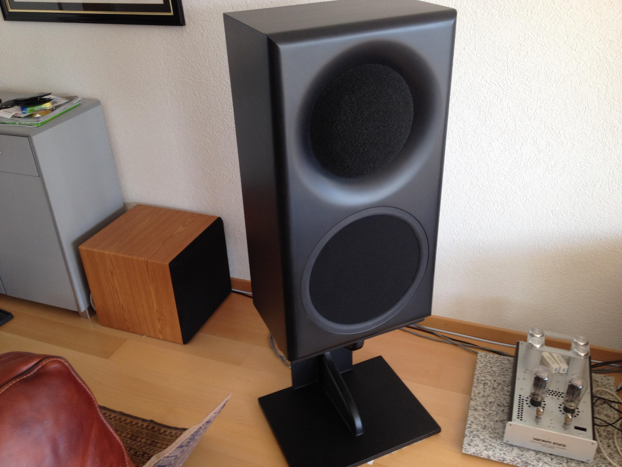

Bigger midranges/speakers have better imaging?
Yes. This is Extremely obvious. 🙂
Really large speakers gives a full size sound image of the accoustic guitar and singer between the speakers.
Really small speakers gives a doll house sized sound image of the accoustic guitar and singer between the speakers.
…And remember, i did not yet mention other extremely important aspects such as: Lifelike dynamic capability and lifelike full range bass capability. With extremely low distorsion. As a function of small or big speakers.
