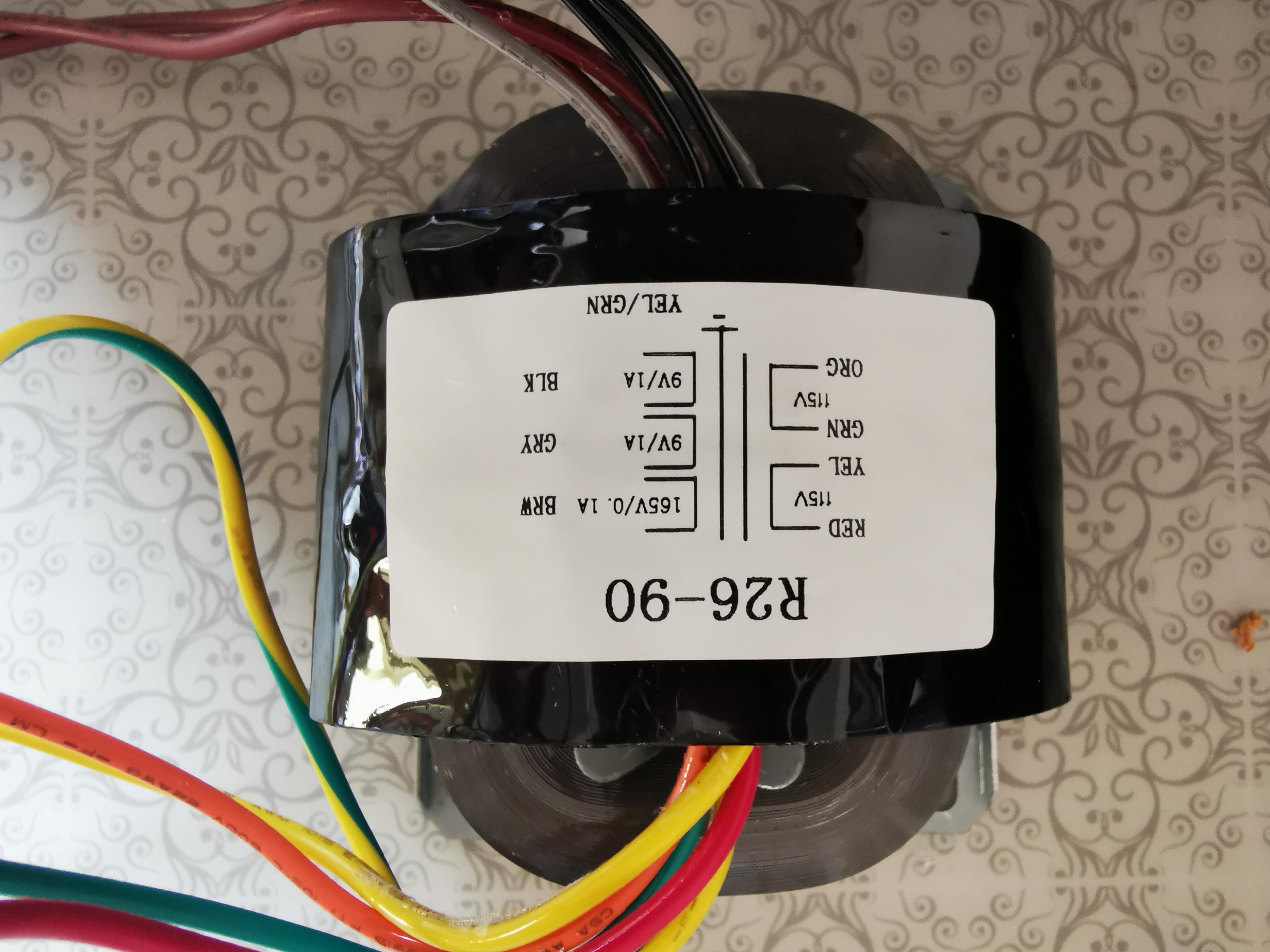

I finally finished my build. At first, things worked very well - no hum only a big sound and a smile on my face. After 20 min the beast shot down. all lights went out. NO music.
After 10 minutes I turned it on again and to my surprise, everything worked again for 15 minutes
Could it be the transformer that is defective in some way ( Audiophonics)
I do have another transformer(r26-90) but I am not sure how to mount the transformer. It has two black wires and 2 brown wires labeled 9V. Do I put 2 wires in zero( one black and one grey) ??????
Regards Jeppesen

Connect it and messaure it.
It seems that brown is 165v
And grey is 9v and black is 9v.
but connect it and messaure it.
That voltage will go down when you connect it to the PCB so that it draws current.

Yes, you centre one black and one grey. I assume that's a typo when you say brown labelled 9v, the brown are 165v.
I have the same traffo, but didn't use it as the voltages are all over the place. (Have a look a post 165 in this thread)
As Ryssen says, connect it and measure voltages.
