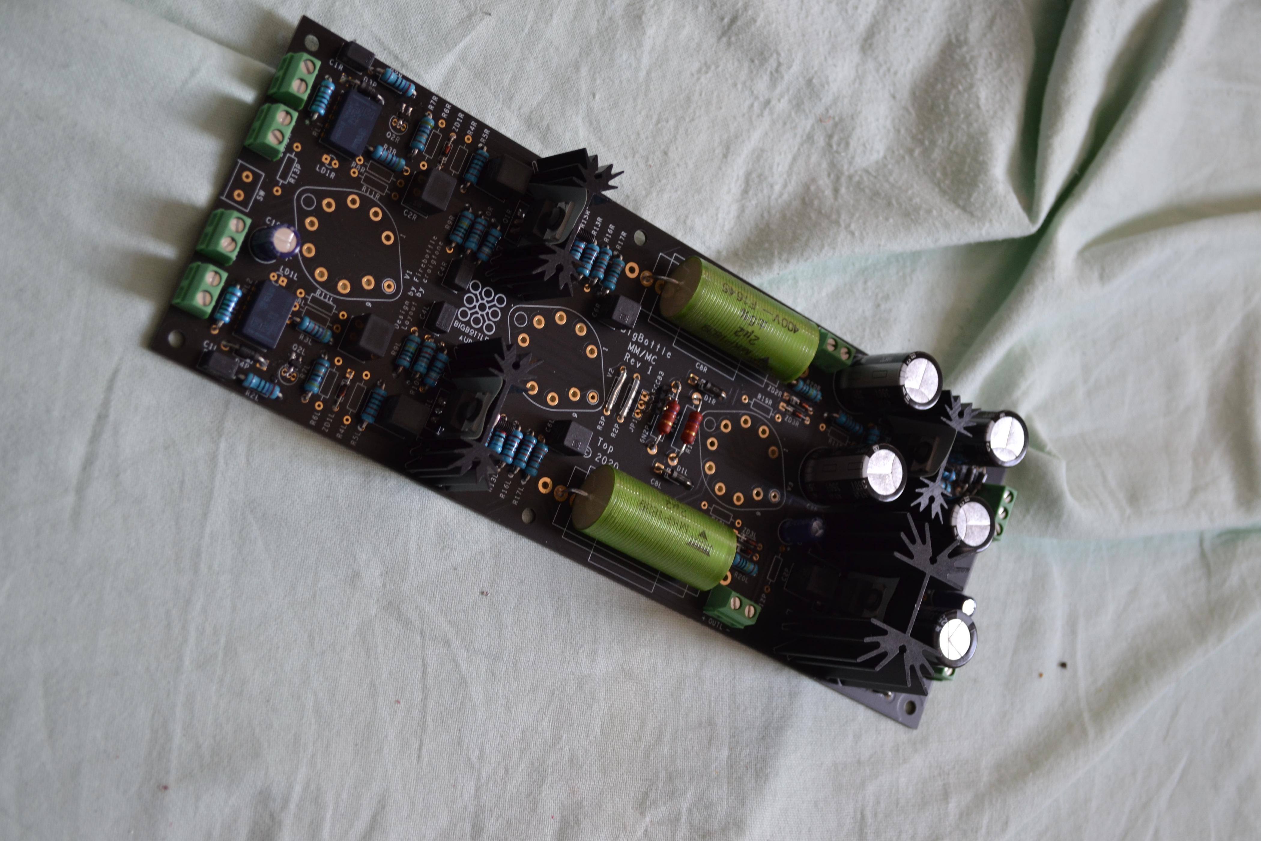

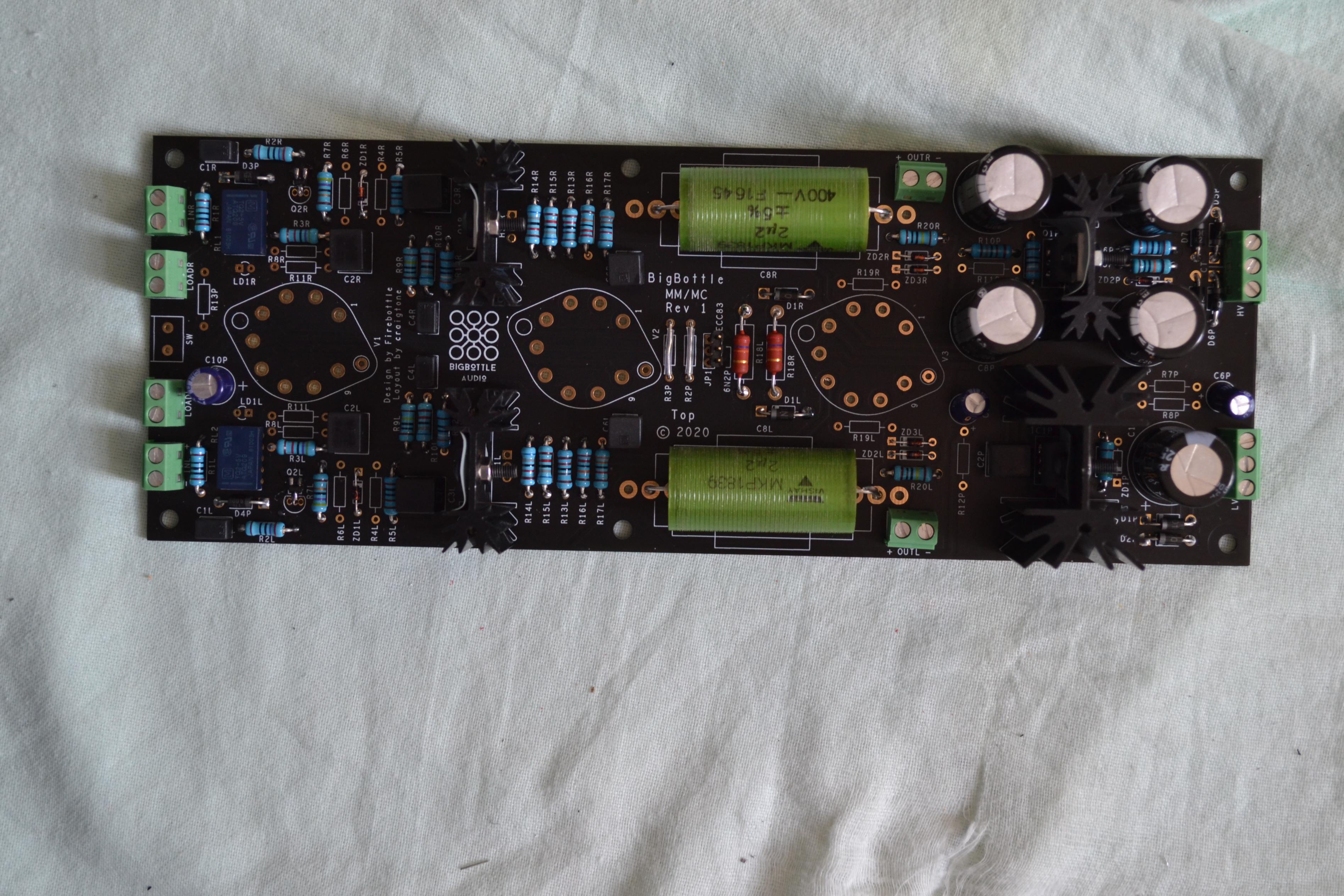

Good man!I've made a start
.View attachment 831139
Hopefully the transformer will be here at some time next week. Hopefully before full lock down.
