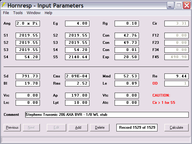

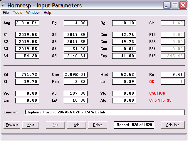

And yet the math implies something quite different to me. 😉 Regardless, just 'running the numbers', a pair of Classic BVR alignments, so play with different vent dims using a parabolic flair if you want a slope board construction (two parallel, one sloped):
GM
