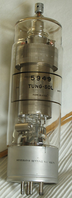

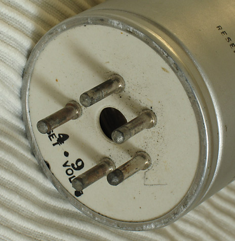

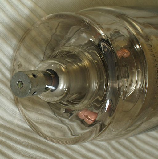

I have more tubes in my collection, a tripple anode triode with carbon anodes, very nice looking
peranders said:...but what do people use them for really, other than collectors items?
I pulled one out of an old oscilloscope. It was used as a linear ramp generator for the sweep. Having such a nice HV swing, it only needed a buffer to drive the horizontal plates high capacitance at microsecond rates.
I have sold the tube on eBay and only two guys in the whole world were interested, a very special part I would guess.
What is the purpose of 25kV and 500 A?
