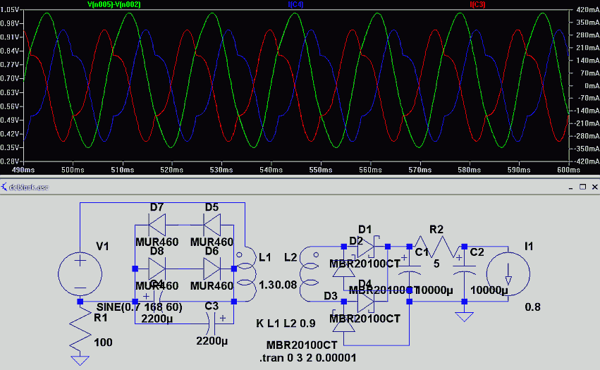

I'm missing something here. In simulating this circuit, across the caps there is an approximately sine wave with DC offset equal to whatever the mains offset is. So if there's some long term DC offset, one of the caps is on average exposed to more reverse than normal voltage.
I've attached a screenshot of a simulation of a 20 W supply.
I can't tell if your tone in that post is sarcastic, but I'll asume it's not. I find simulators can be useful, while of course being aware that it misses many things and can give wrong results.
V1 is the AC source; I put 100R to ground since in houses here neutral is tied to ground at some point up the power chain. The green trace is the voltage across the capacitors. The AC source I set to have 0.7 V DC offset. The blue and red are currents through the capacitors; one is inverted probably because the simulator assumes direction is determined by the polarity of the electrolytic.
The stuff on the right is bridge rectifier into CRC filter and load, just to simulate a typical audio load on the transformer. The transformer itself is the two coupled inductors; transformer parasitics are not simulated. The graphs displayed are after the circuit reaches operating point, about 2.5 seconds after poweron.
With the current setup, DC offset across the primary is only a few mV as opposed to the 0.7 V of the AC source. Decreasing the capacitors quickly increases the offset, however. This is only a 20 W supply here, which is why these small caps work.
It's not on the plots. It's specified on the V1 source: SINE(0.7 168 60)
The 168 instead of 118 V since LTSpice uses peak amplitude instead of RMS. You can get RMS and average readings for plots by doing Ctrl+click on a plot's label, it will integrate whatever section of the waveform is in the current window.
The LTSpice file is attached. Don't forget that in the display you can enter various expressions, which is how I got the green trace.
The simulation runs faster if you change the coupling K to 1 instead of a fractional value (0.9 in this case), and increase the timestep in the .tran analysis from the current value (I had it low so I could zoom in on peaks to check their exact value; without this number they were not sampled enough and jaggy up close).
