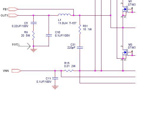

the load that I'm planning on using this amp will be indeed 2 ohms.
the original recommended inductor value (in the daasheet) is 11uH but then jan said to wind the toroids with 26 turns so I did and measured 10.04uH. I thought "hey, it would be a shame to waste the litz wire and 1uH might not make much difference" 😀 so I stayed with it. but I still have enough to redo if necessary.
edit: do I still keep the zobel circuit and not have to change anything on that?

tried the 0.47uF caps.........
with it, the output sine wave drops from 5V peak to 2V peak.
BUT! the caps heat up a bit, just warm to the touch and idle current of the amp goes way up. with the caps on both channels, my current limited supply can't provide enough current. might have to live with the higher sine wave output.

Can you draw up a schematic of the output of your amp and how everything is connected?
If the ESR of the caps you used was pretty high then the large ripple current flowing through them will cause them to heat up some. They were film caps, right?
yes, they are film caps. 200V 0.47uF which look like yellow rolled ones but oval shaped.
the slight heatsing is not much of a hassle. it's the much higher idle current that bugs me. :xeye:
I don't have any drawing, just the schematic of the chipset in PDF file.
the PDF file is too big to attach so here is the output filter portion of the schem from the PDF.
I basically wired the 0.47uF caps across C10 in the schem on both channels.

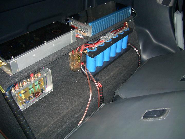

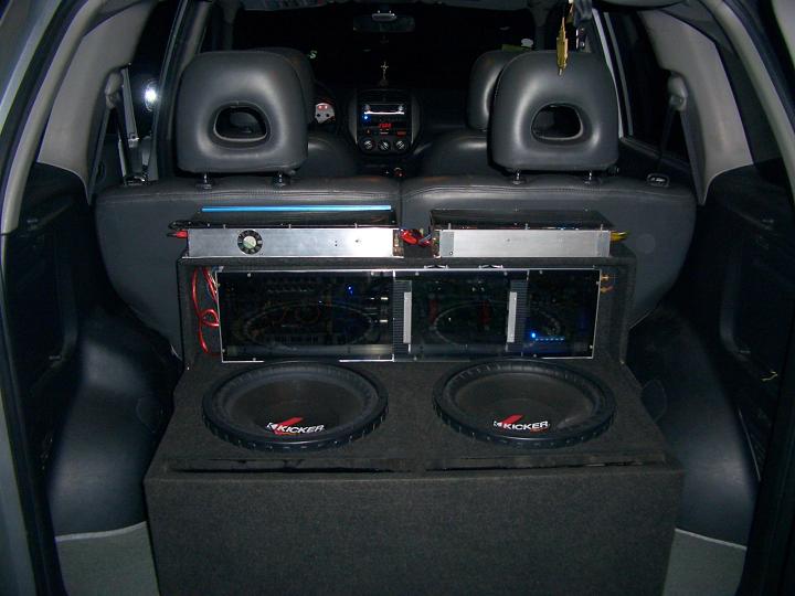

UPDATE!!!!!!!!!!!!!!
I was able to complete 90% of amp8 yesterday and have done a little bit of torture testing.
I'm not yet sure how much power I'm getting from the amp but my car's alternator and battery are starting to give up. It blew a 40A fuse like popcorn and the 60A is still holding up. though the amp cuts off some of the time due to low voltage most possibly due to the batt and alt sagging. I got a in dash voltmeter and I can see it drop to 12.4V (13.8V at no music) with the engine running at idle.
the main SMPS seems to be holding up well since the fets ,rectifier diodes and main toroids are berely getting warm.
I'm guessing it's putting up some power since my subs are beginning to smell after a minute or two. they are both dual 4 ohm coil wired in series to get 8 ohms per sub then two wired parallel to get 4 ohms. then they are bridged on the two channels so the amps are basically running at 2 ohms each.
the mosfet heatsinks are running hot but are still manageable. the driver chip stays the same temp at idle or at high output, the zobel resistors get burning hot (guessing about 60-70 degrees C) and also the toroids. the toroids are getting a bit too hot for my liking so I'm thinking of rewinding them again but I'm gonna have to make my own litz wire since I don't have enough left.
I'm gonna rewire the toroids with a bit more turns to lessen the residual at the outputs since this thing is already an EMI nightmare when a drum core inductor is connected to a scope to measure EMI radiation around it.
