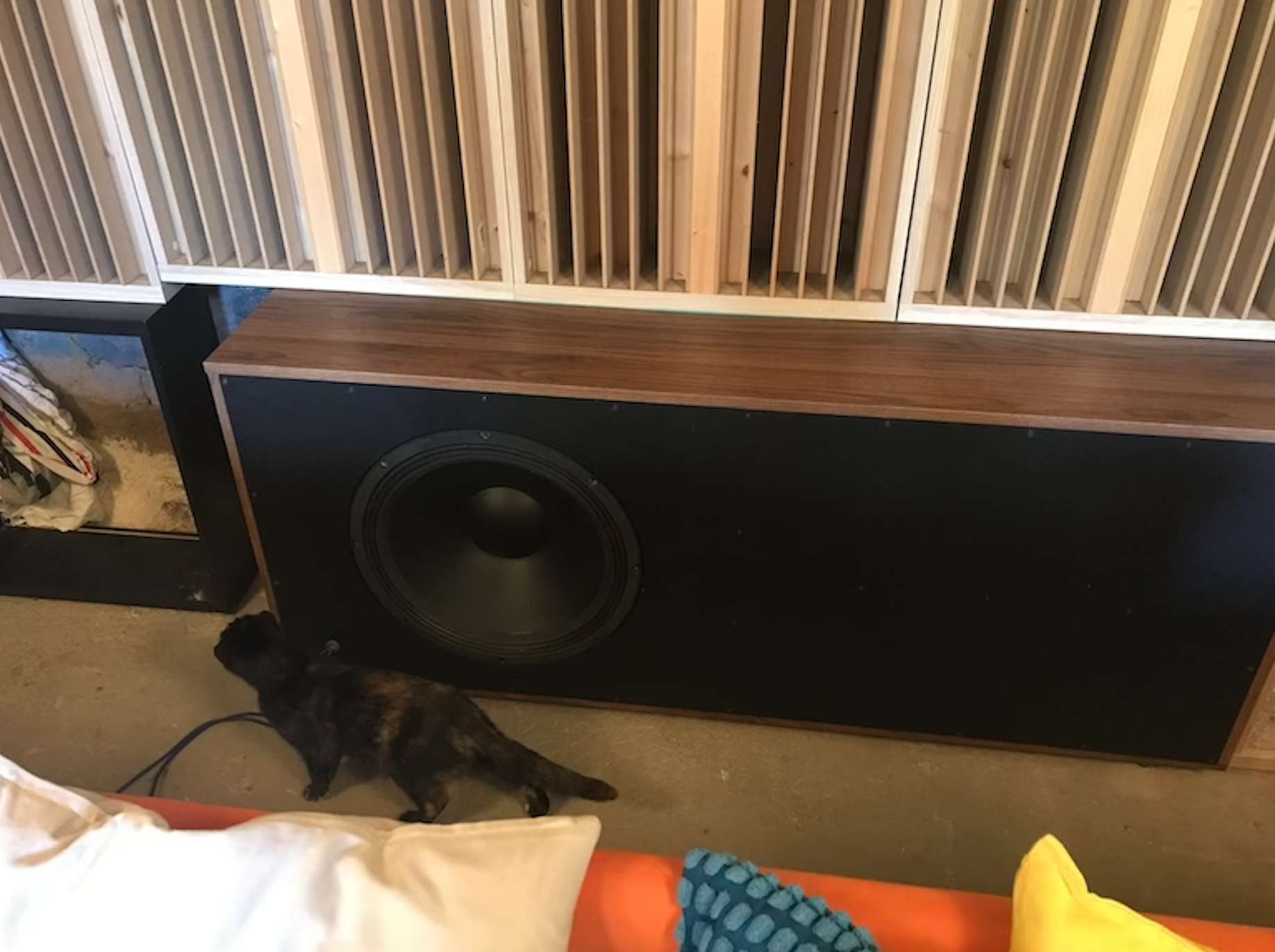

Went to see them in real, and realised even the big one could do it, this one, 159x64x46cm, 468L. :
Got one, some mdf, some valchromat and let's go.
Like previous stuff I've just built a box within a box, 18mm glued all around inside, 24mm for the back, half the baffle doubled in valchromat, bracing with scraps, kind of light. The good surprise is that the radmanso is full particle boards, no honeycomb core on this like on many others, so nearly 4cm thick particles + mdf at the end.
The baffle is removable so I could add more bracing later if needed (I already found a spot that may need it).
And I could try 1 or 2 drivers, even clamshell isobaric if the box is still not big enough 😛
It's around 330-350 L. I'm guessing. Yes I did some sims but, they're just sims…
I of course did few mistakes again, my very first move was one! While sanding the inside of each panels for better glueing, I messed up and sanded the wrong spot of the panels, the edge that would have been visible outside. So I couldn't get the recessed baffle like I initially wanted.
Damn' what an idiot. So the baffle is now flushed, I'm sure it would have looked much better with the recess (like the mains).
Maybe I'll add a fabric grill, I'll see, it's fun to see the big driver too.
Then the valchromat was finished with tung oil, for a nice dark contrast.
Some details are left for later like the right cable, neutrik connector, better driver screws, replace temp wheels once in place to decouple a bit etc.
Not sure I’ll use the original steel stand that comes with it, it’s sturdy but will add 20cm in height.

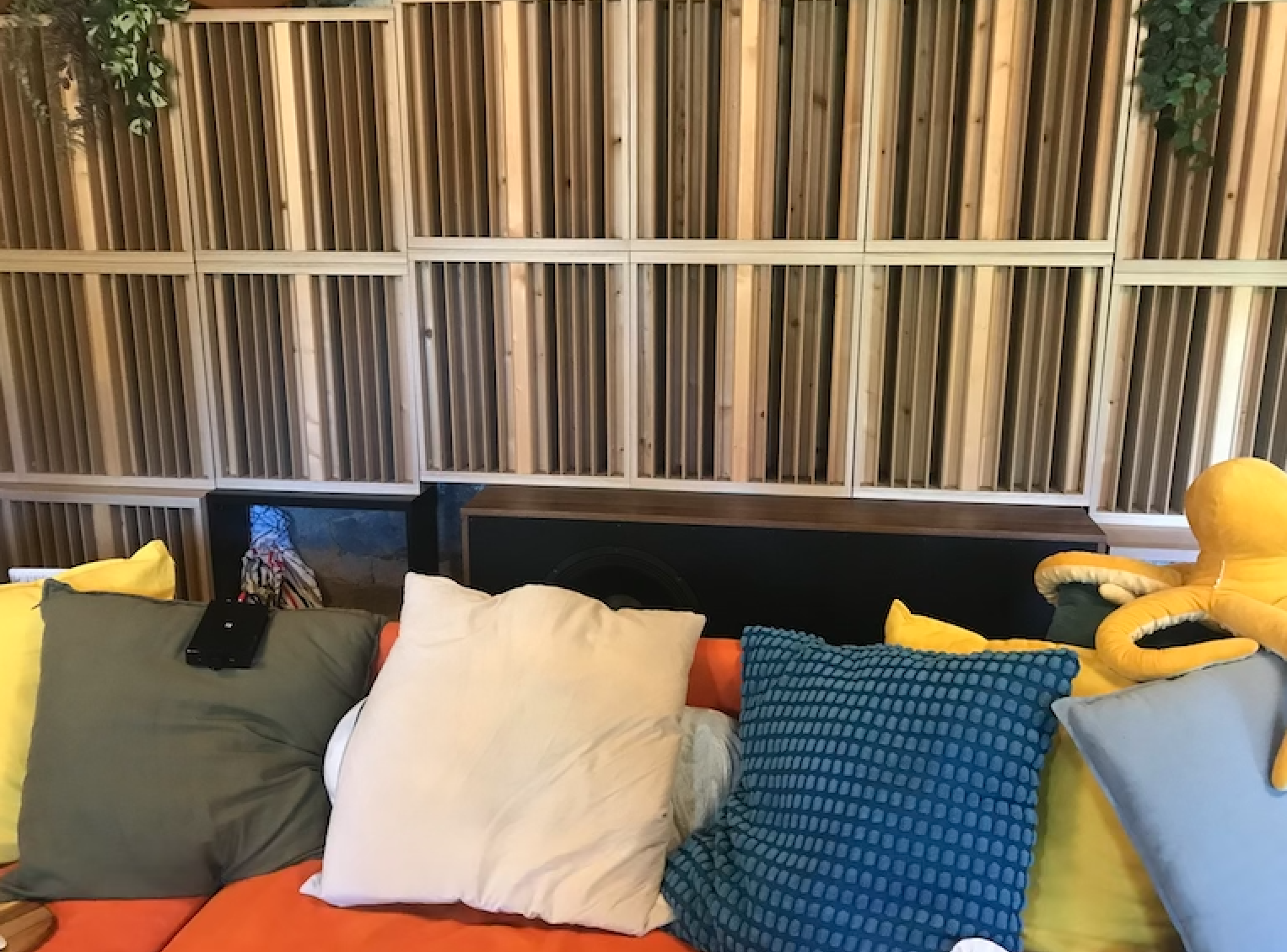

Started the integration yesterday.
Bit of a pain to remove all diffusors to place the sub, centered for now.
With two I will spread them apart a bit, symmetrically or not from MLP.

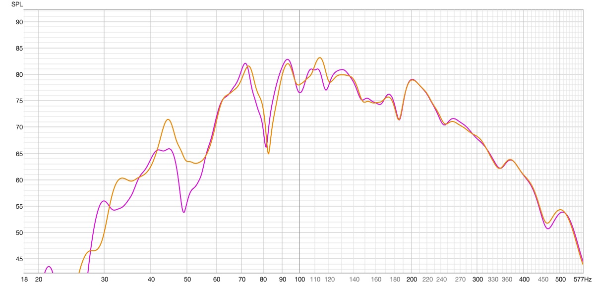

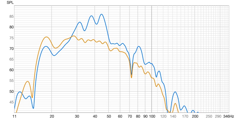

Anyway, nearfield and MLP sweeps:
I'm guessing the large dip between 50-70HZ comes from a mix of ceiling and front wall cancellation (2.7 and 5m.)
Should be manageable with 2 subs and a bit of EQ.

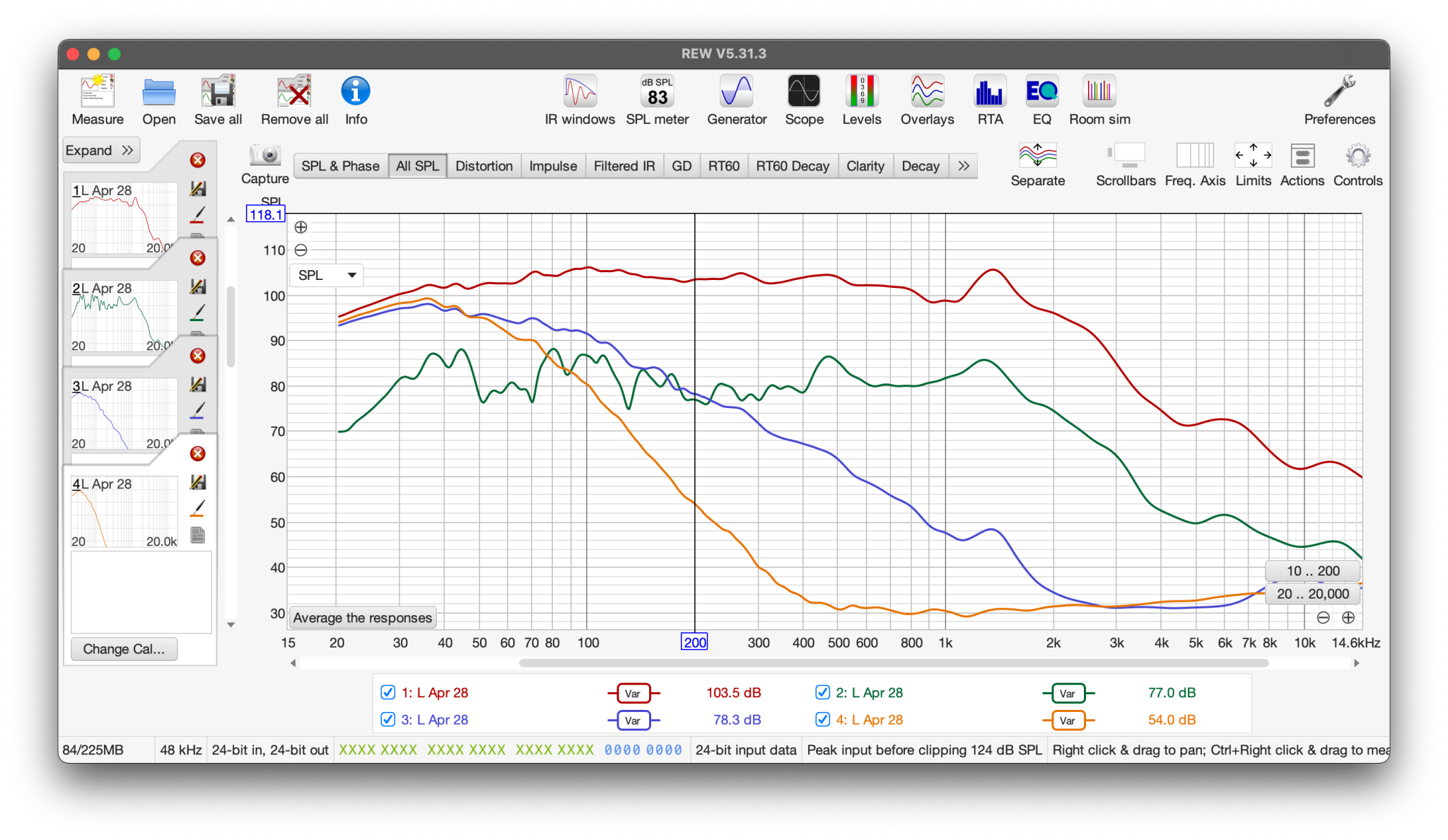

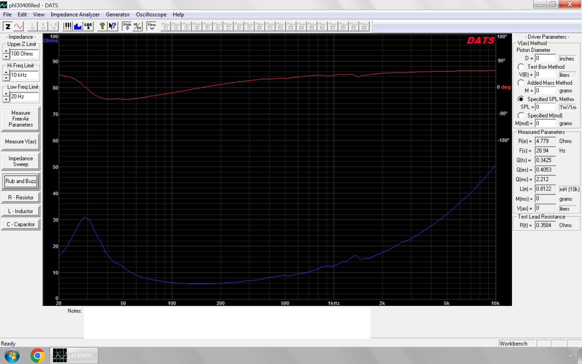

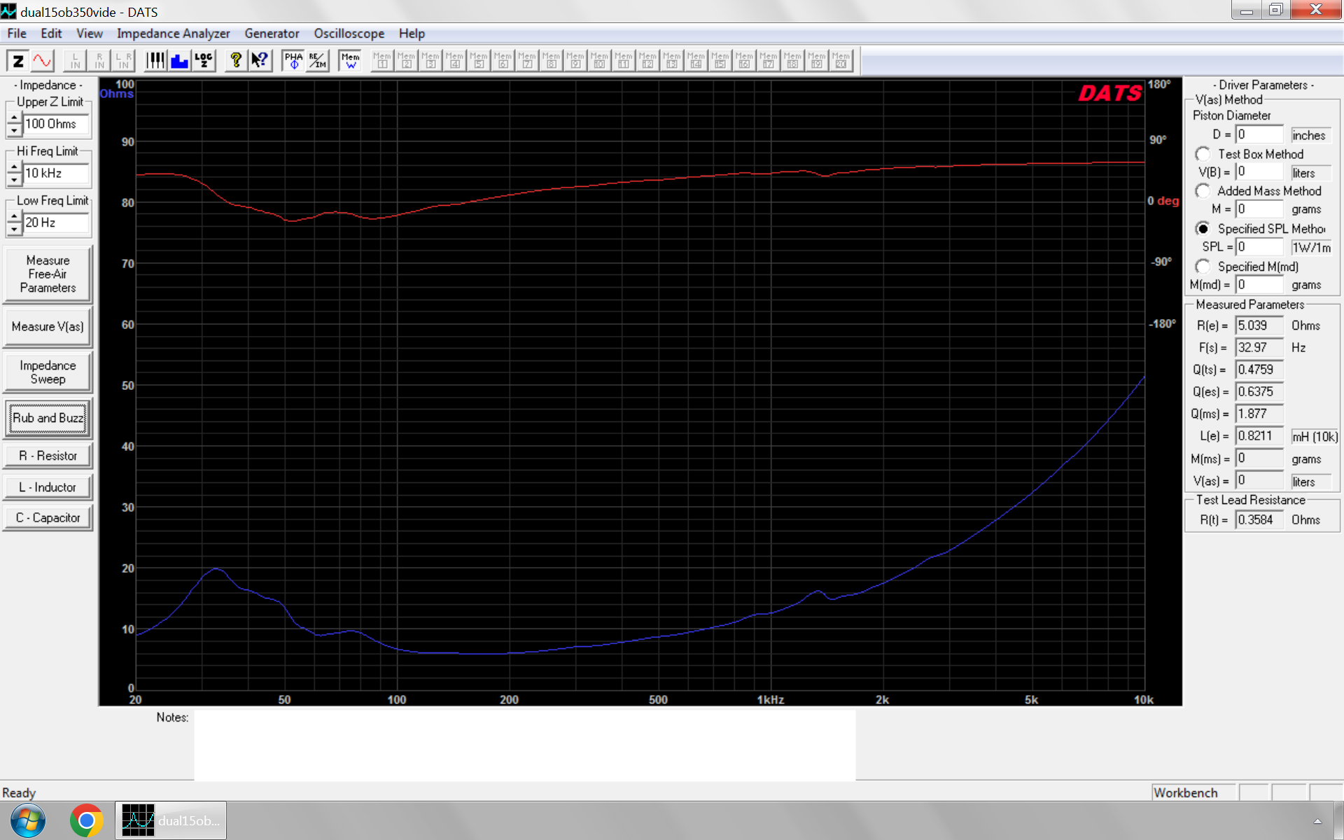

Also some DATS measurements, out and in the box:
I selected the driver with the lowest FS of the four, 28HZ when all 3 others were around 32Hz, similar Q for all, at 0.35.
The in-box sweeps shows a little messy impedance.
8 polyester cushions inside, it's a bit of a pain too to remove the baffle especially now in vertical position so I won't adjust that soon.
Only when the second box will be ready once I displace everything again.

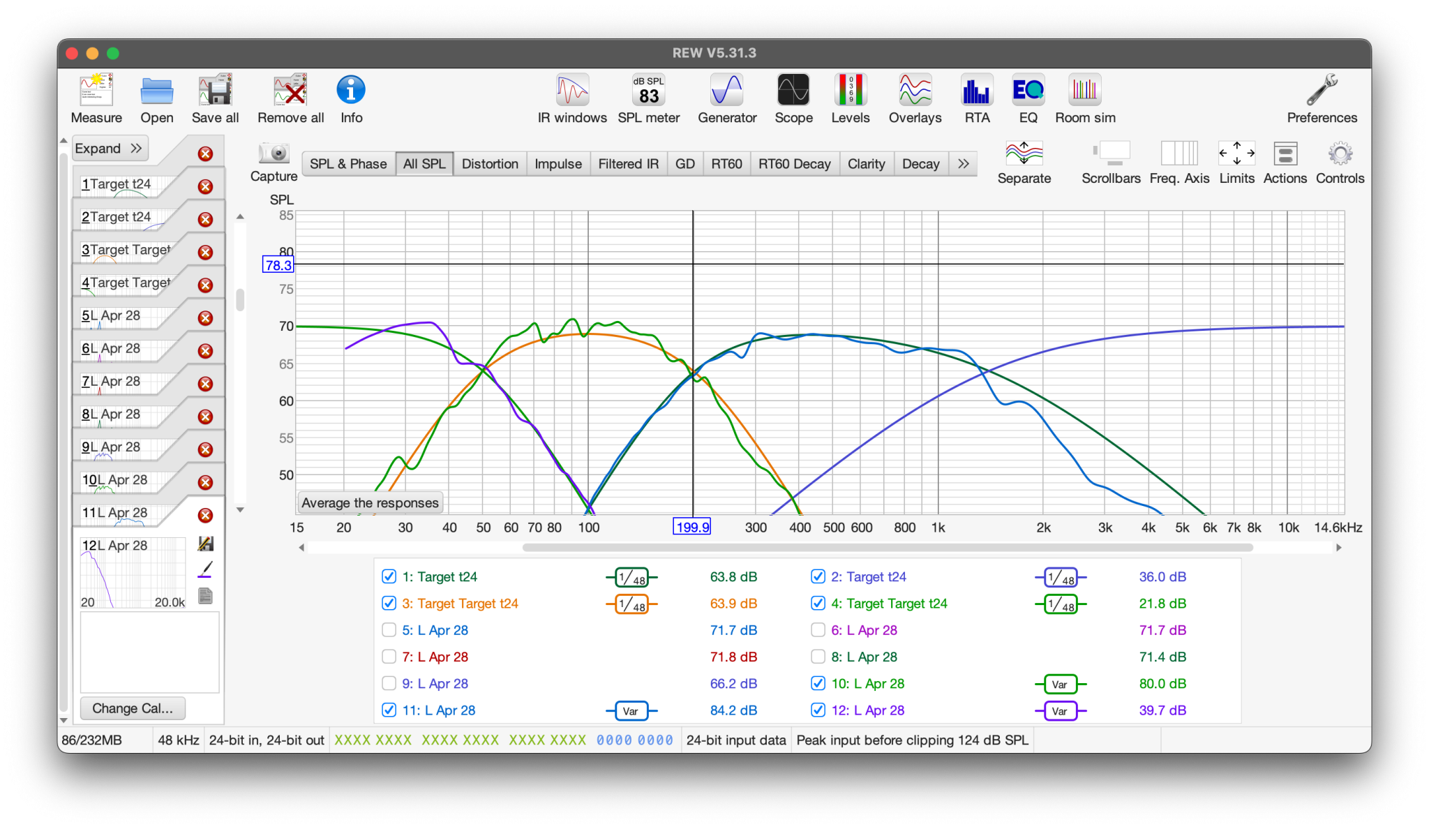

Then started the XO work, ended up with 50Hz at 24db LR, acoustic.
Tried some overlap and it was not bad but I would need more time.
The sub has severe eq cut and I tried to minimise EQ use on the main woofers.
In fact I now don't EQ them at all and it sounds good.

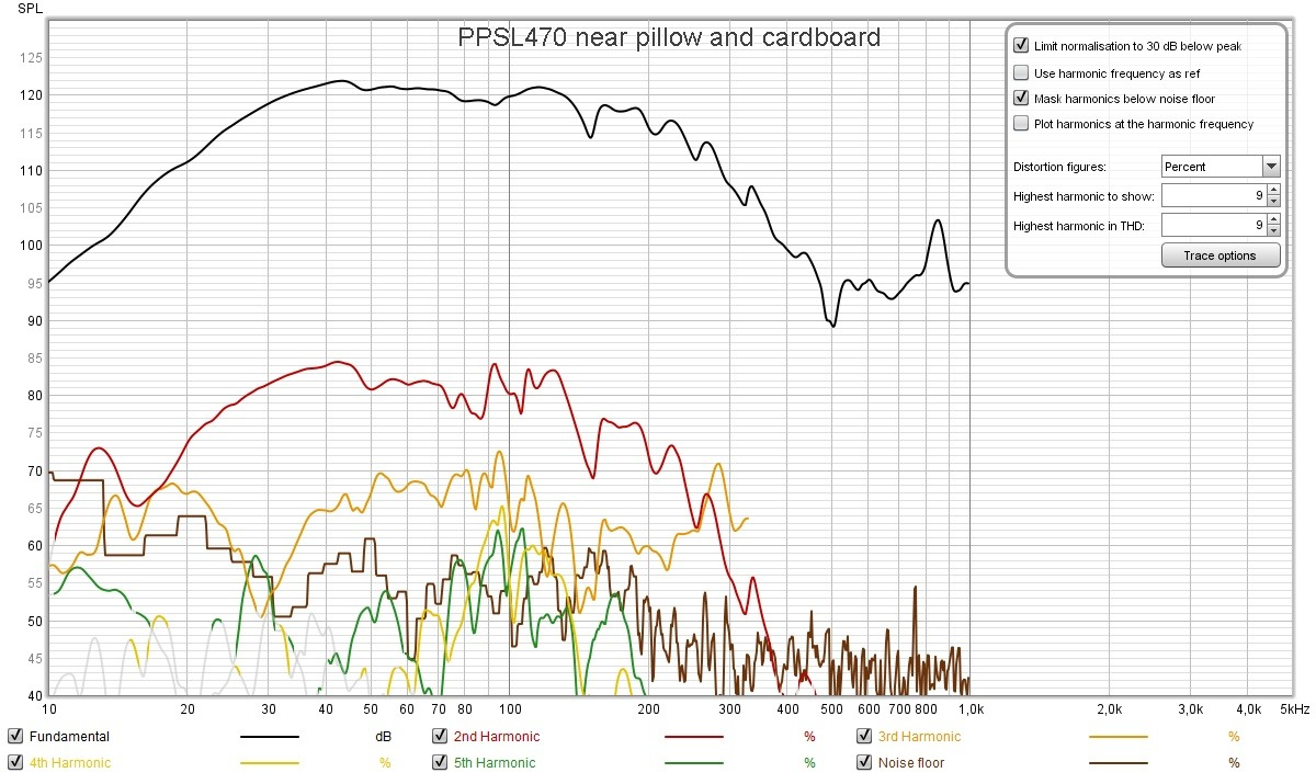

Took the following screenshot during the process, these are not MLP sweeps, but nearfield to track the targets.
MLP sweeps were of course a lot messier:

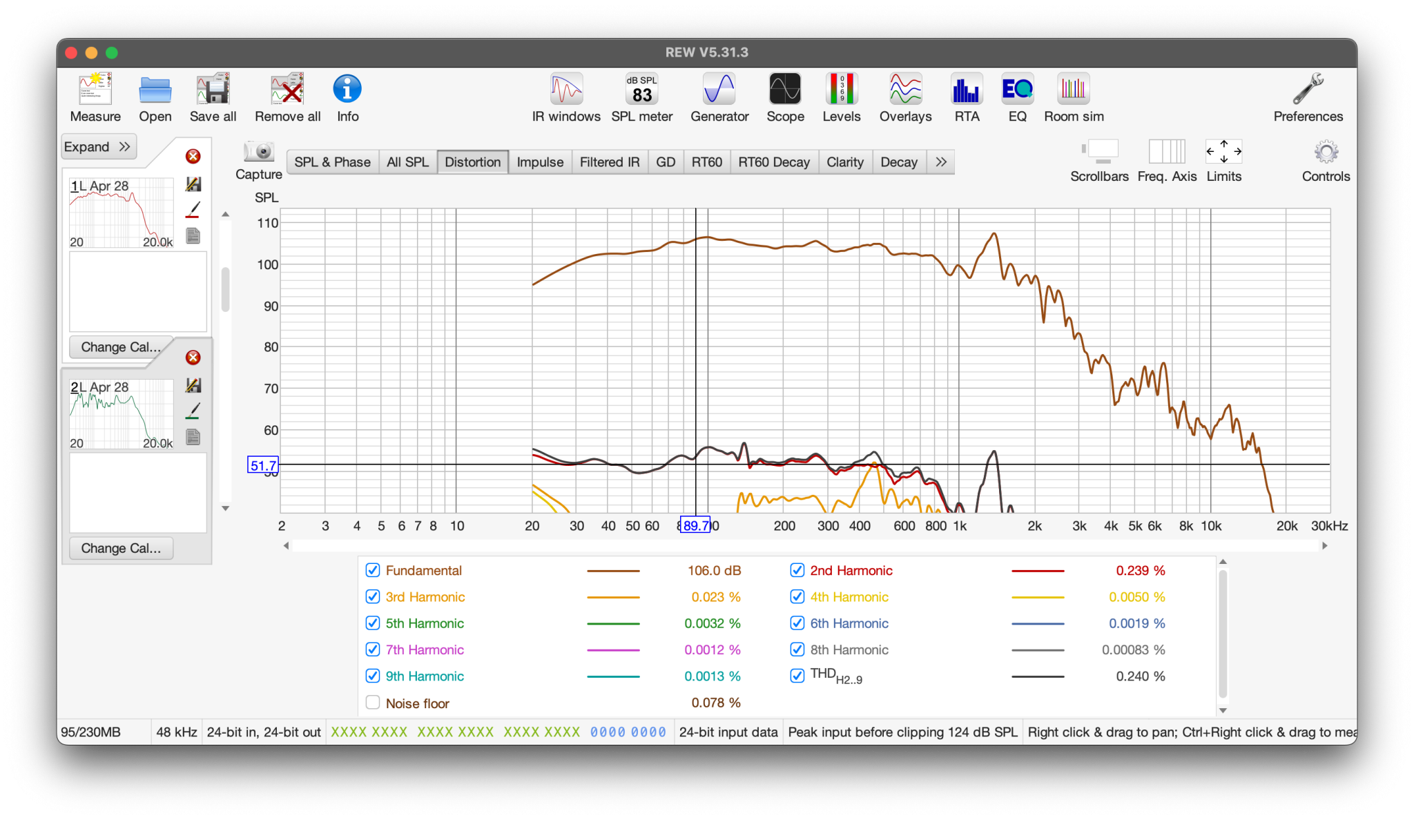

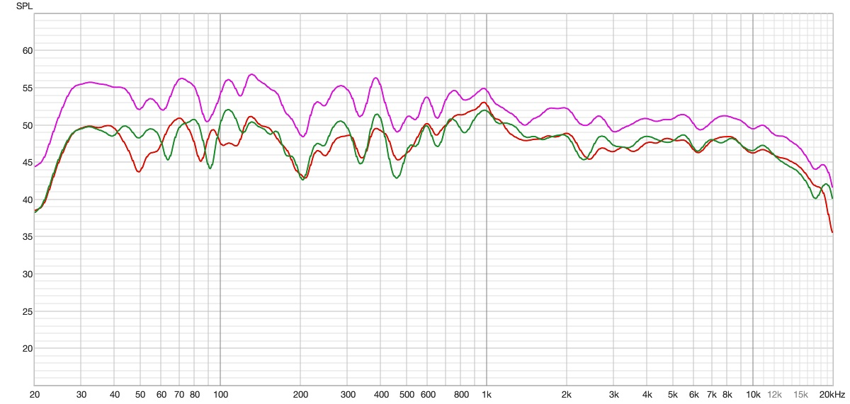

Got my REW back!
It was something related to java and the dialog box/folder rights, had to use REW dialog boxes and not OS.
Surprisingly AI was very helpful here.

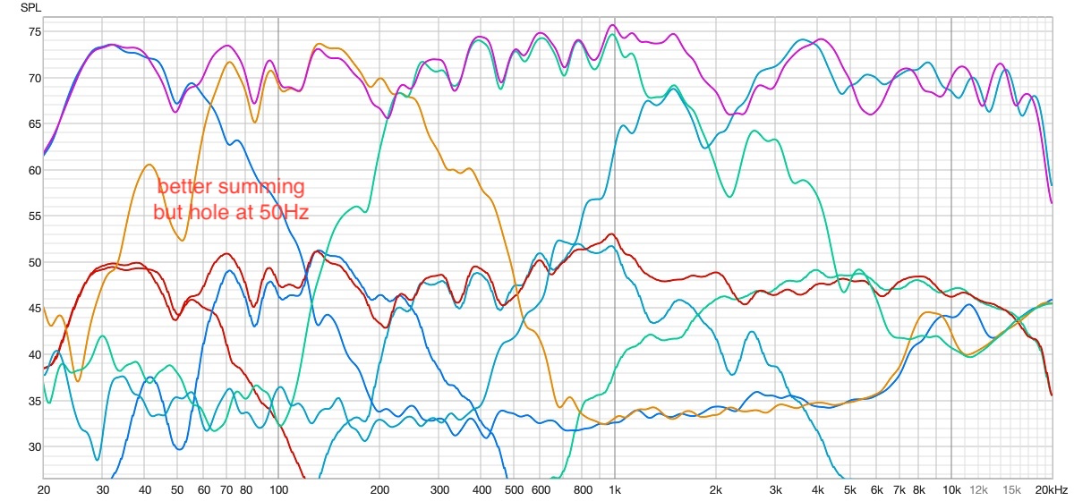

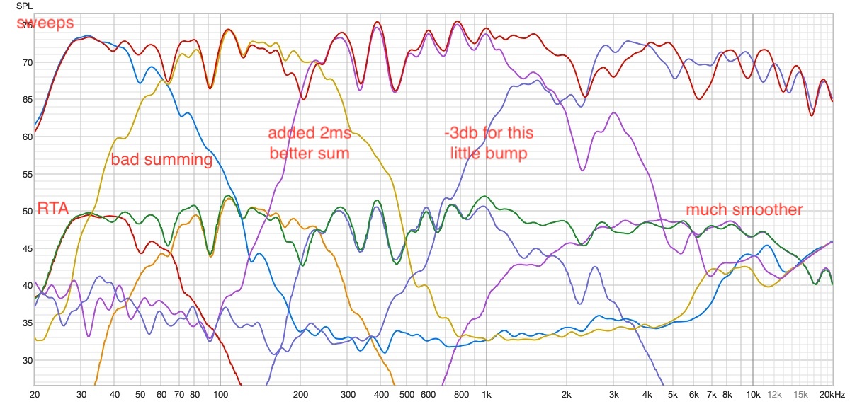

So to illustrate the issue I'm facing with the sub integration, here are few pics, I used RTA MMM too for once.
So one pt sweeps on top, rta at the bottom, house target off
I tagged what I did during the session, not visible yet:
  • sub: lot of eq needed like -15db cuts, little dip at 50Hz but kind of ok
  • woofers: both suffer a dip at 90Hz but the left one has a severe one at 50Hz, can't figure out where it comes from
  • mids: no eq but I realised they could use a low q cut at 1Khz, the house target might have masked this a bit
  • horns: rta are pretty smooth, I have to not forget the sweeps are not representative, especially during future time alignment
RIGHT
LEFT

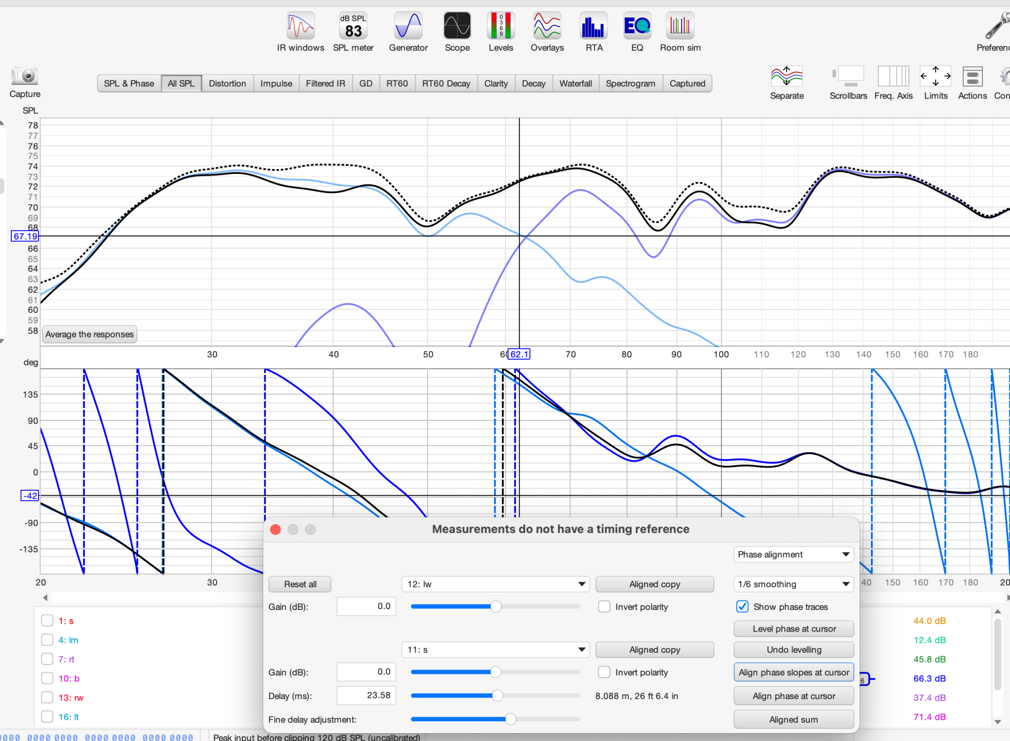

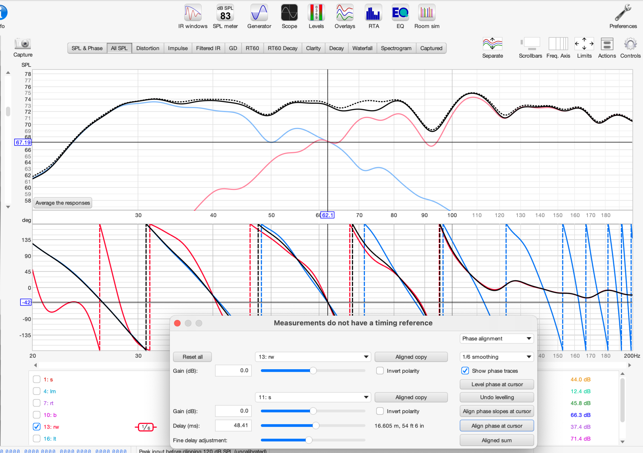

For now my issue is with the sub integration with the woofers.
Using tape measure the sub delay should be 6ms, and it sounded ok but I finally preferred 0ms, summing was not perfect on both but a compromise.
Rta left/right and both:
But playing with the REW alignment tool to get it perfect, it asks for 20ms on the left and 50ms on the right!
I'm very surprised by the amount of delay, but I never had GD in mind while doing this.
I usually just use distance + reversed polarity technique but maybe I was always off by few cycles in the past on all my systems!

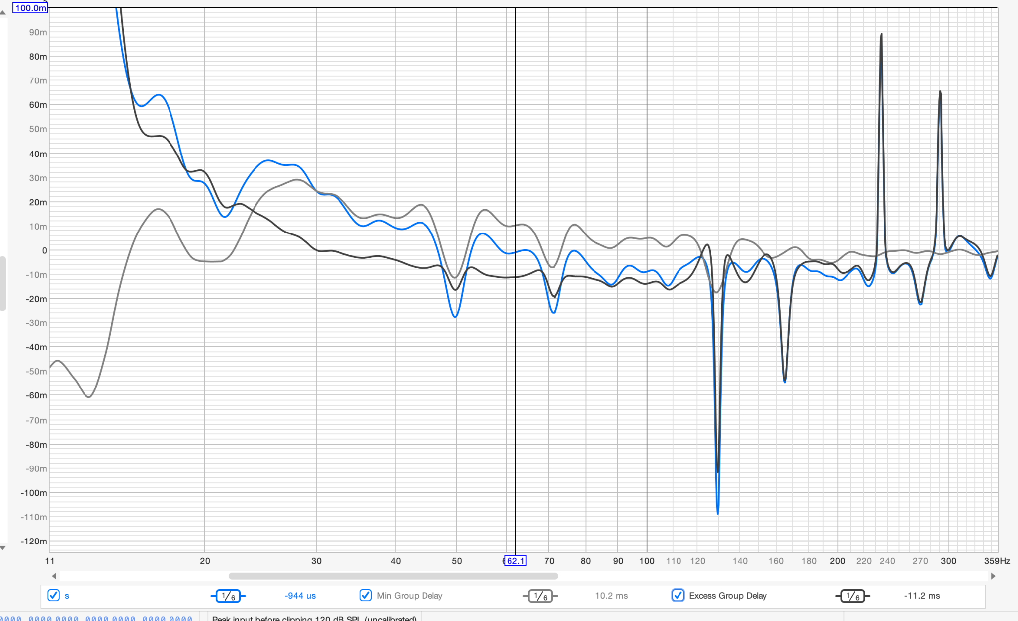

Here's the sub GD, I don't know if I did it right here:
But I can see a large swing in delay between 50 and 60hz, right where I cross.

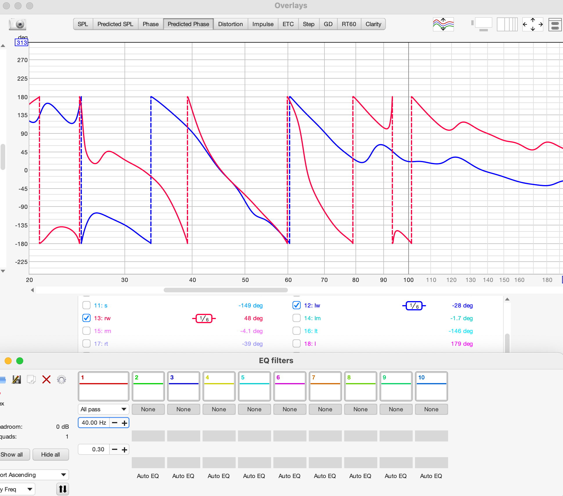

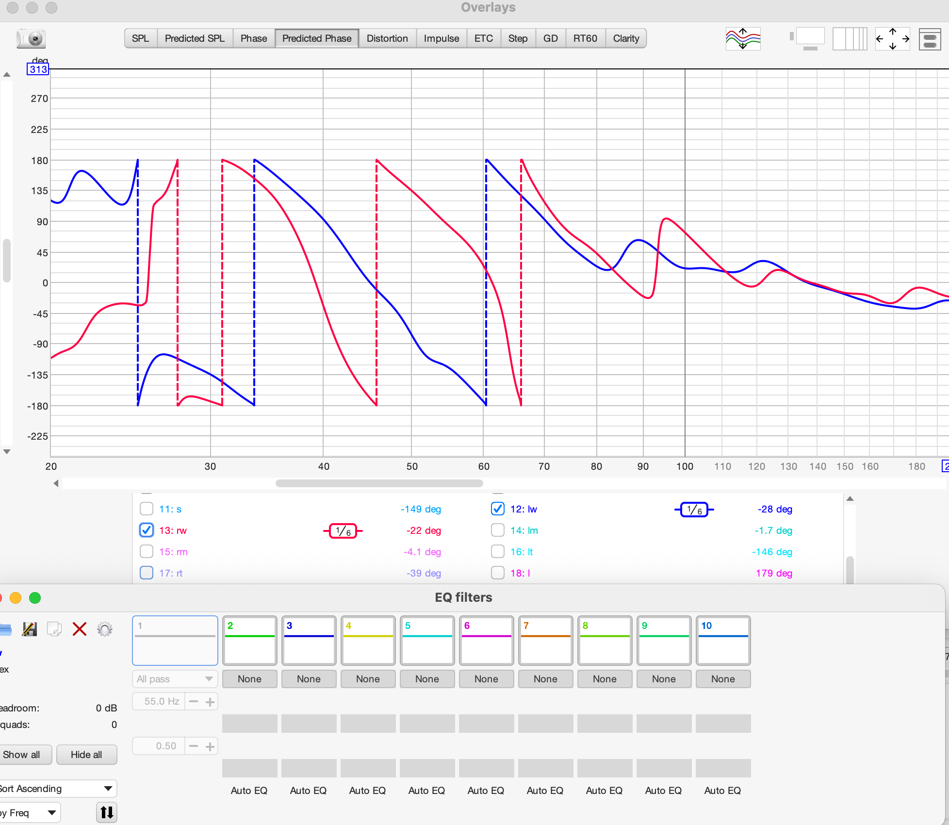

Maybe I should:
  • just pick a different XO point
  • try an allpass filter on one of the woofer for phase to better match
And here I'm trying all passes filters, here clearly I don't know what I'm doing.
Played a bit with the numbers in rew eq and predicted phase.
I had really no idea of what I should start with, but I can see that on the left woofer (LW) I can align it with RW with a low Q all pass at 50Hz.
Well if this is really what this graph means:
off/on

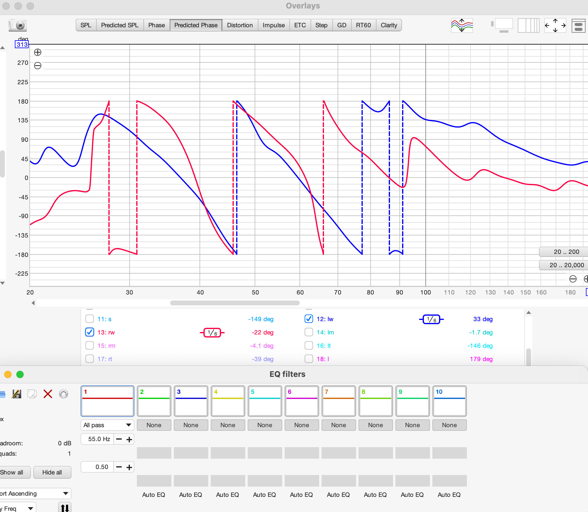

Or I can adjust the RW instead:
I still have to implement these to test, but during the process I tried a few numbers kind of randomly and it seemed to have an effect.
Sum was not perfect but it got better, now I have to understand of the all pass filter really work, to define the right frequency point and Q.
The really low Q of 0.3 I used should have a large impact on the entire bandpass right? is it too low a Q?

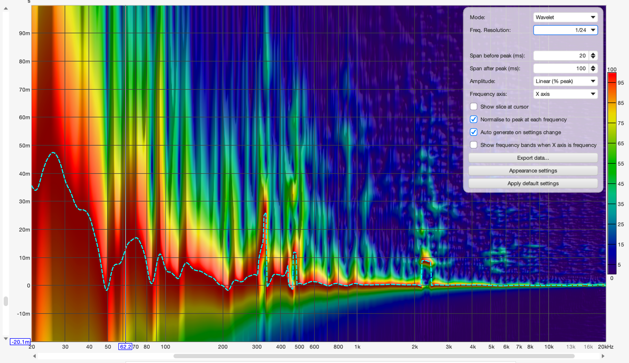

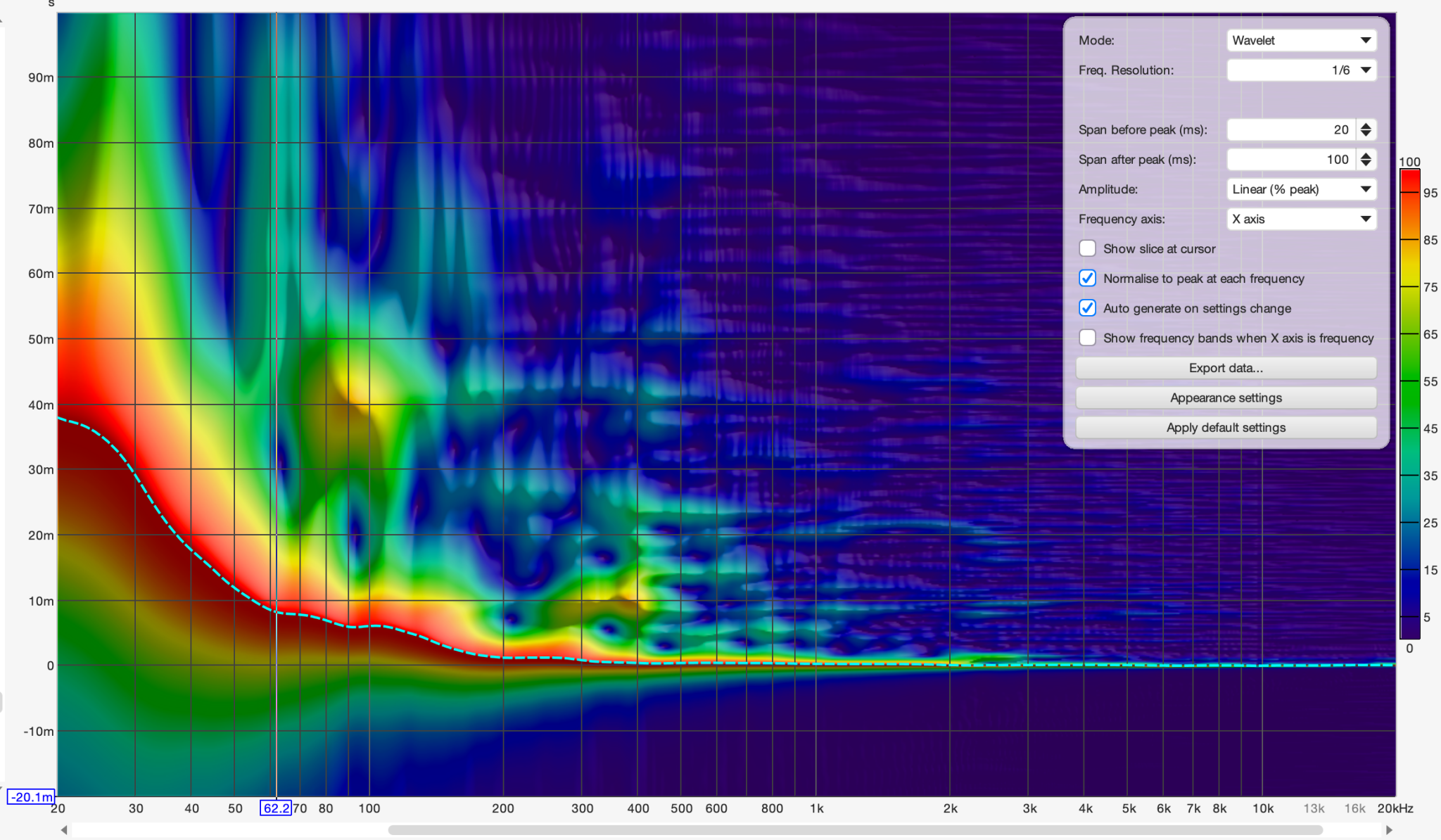

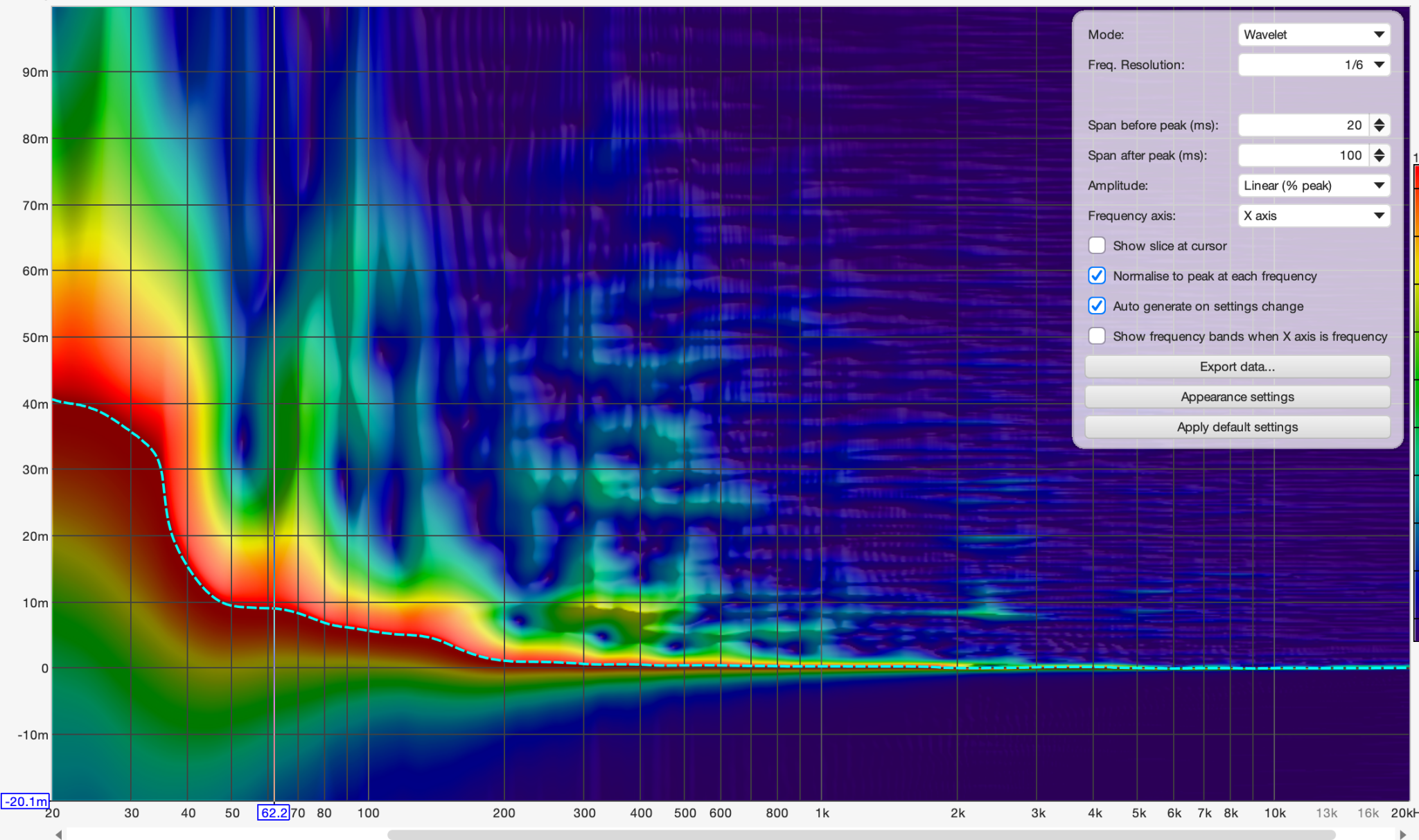

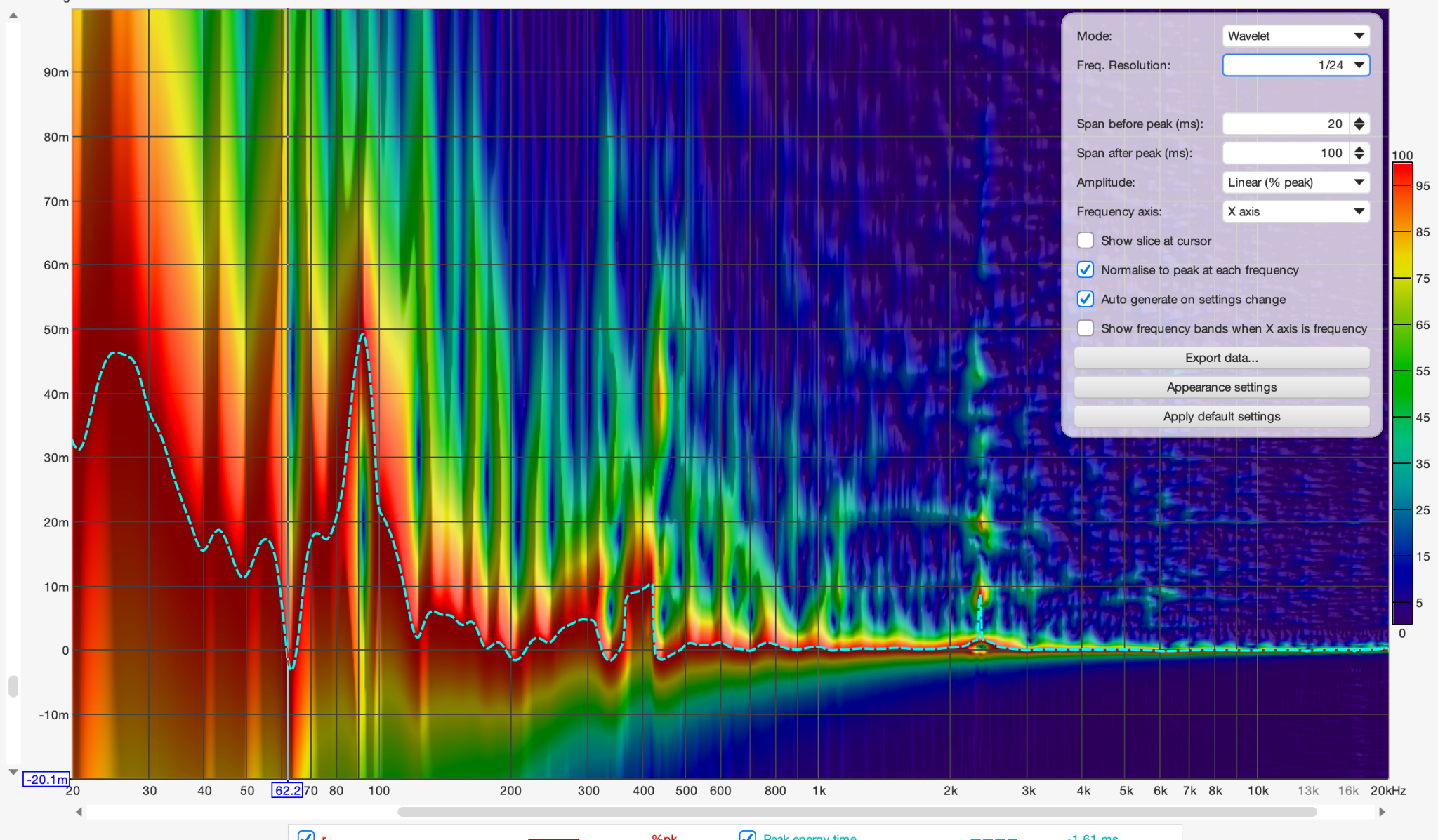

What I don't understand too is that with 0ms delay on the sub, I get these spectrogram, left than right:
  • maybe I just don't use the right parameters in rew eq for the all pass?
  • or I measure wrong and it's not representative?
in 1/6, pretty smooth, I can't see how adding 20ms would help here
in 1/24, oh wait, here are my 20ms swings!
It sounds no bad at all right now with 0ms, and I can keep it like that until I add another sub, no need to optimize yet.
But I need to understand so I'll be ready later.
Also one great lesson, check with RTA first! Even averaged sweeps are not that in line with the hearing.

The room has 3 doors on the front left corner.
2 left doors are for small storage spaces, and top one to the outside.
I had the habit to close both left doors for listening session, top one is often left opened to the garden.
The speaker is 2 m away of the corner, kind of like this, top is front wall:
+______
+ S
- wall
+ doors
S speaker
So I measured the left woofer with each door opened/closed and the combinations.
I expected the outdoor one to have the biggest impact but not, it’s middle one that really has an effect:
purple: all doors closed
orange: middle door opened
At least I know now!

My HT sub has two Dayton 15" yach in 360liter sealed. Only problem is bad position in the room, separate subs would smooth modes...
Unfiltered nearfield response
Reactions: grosso
MrKlinky, they are PA drivers, well if the label is important they're from SB Audience.
But they have an unusual low FS for PA, and are dirt cheap.
I had 12" and 15" regular sub in small boxes before, with a lot of EQ they worked, and of course needed much more power like 500w.
But since I have the room now I wanted to test a lower Q, to put a final end to this question (here I went so low I could add another 😛).

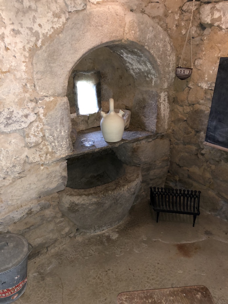

As I also want to try Infinite Baffle in house (after great result in car).
I have a sort of opening that I could leverage maybe, it’s a « saloir en pierre » where they used to store meat in the salt, I guess a stone salt cellar in english.
Pics when I arrived in the house:
It would be shame to not restore and hide it, but I can’t stop thinking about it, I’m sick 😛
Wow 360L in 10m2! More insane, so do you keep using them? I see that you measured them recently.
Mine is centered for now and it’s not the best place for sure, but the dips are not that bad by ear.
I wonder if I should build 1 or 2 more, either another one the same size, or 2 slightly smaller so they could be more optimally placed.
It’s mostly cut and xo to shape it, with a little boost below 28Hz, near-field:
Amp is a little fosi v3 on 32v, and based on the impedance reading it should push around 20-30w at max.
I need to measure the voltage to see where it is at regular level, probably not much because it stays cool.
But adding one can't hurt, if only for the smoothing.
Still there, but not much use because kids have moved away. Volume is 235 liter x2. The aim was to go low with low distortion, not max spl. But for sure they can make the furniture shake, rattle and roll...
I like LR2 around 80Hz best, lower group delay. Measuring for xo is difficult because of room modes and long gating required for 40-120Hz. I finally put a main speaker right next to subwoofer and measured them at about 30cm.
Yes I did try to overlap at the beginning, treating them like 2 subs but didn't get it right.
Mains are not that happy below 30Hz and it felt fuller but less precise, but maybe I just didn't spend enough time on it, it’s still on the list.
Also tried shallow slopes on both but the sub is very nervous and I could still hear it above 200Hz (it’s very close to me).
Whatever I do I think I need to first fix the phase discrepancy between L&R at 50Hz.
I want to try the wavelet method used here (video posted on ASR https://www.prosoundtraining.com/2025/03/21/mains-sub-alignment-a-different-take/) Very clear to illustrate what is going on there.
Once fixed I should be able to compare all methods.
