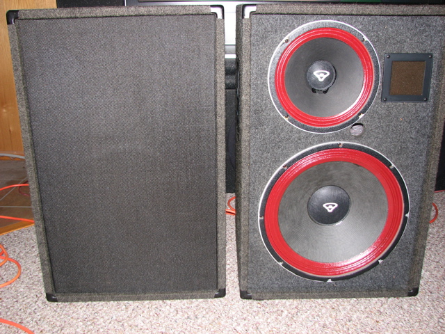

I have a set of Cerwin Vega's with 12" woofers and they are run full range. I think I'll play around with some kind of reflectors to try and change the dispersion, and get some readings on what can be done.

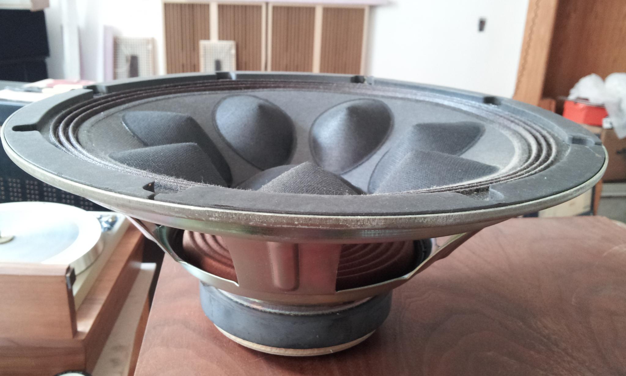

That may not be the best way to improve dispersion.
The video was a total fail if you listen to the HF.
If you listen to the mids, it worked.
This may be a better solution:
Its been around since the '50s. You can play around with the shape of the opening and measure what gives the flattest on-axis response. I've used rectangles and ellipses, both with the long-axis vertical (as is the JBL). Make one out of cardboard and give it a try. When you find the shape you want, make it out of Masonite and attach it firmly. I did this for a guy using a JBL 2226 for his mids (which were crossing too high so his 1" Radian drivers wouldn't blow). The improvement in the midrange on drums (especially the snare drum) were quite obvious. We took the cardboard and just painted it black, nothing fancy.
The 12" JBL uses the same technology, the 10" does not really need it.

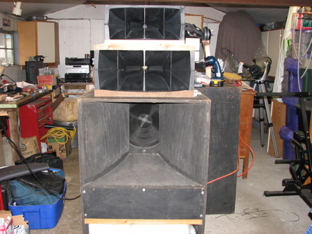

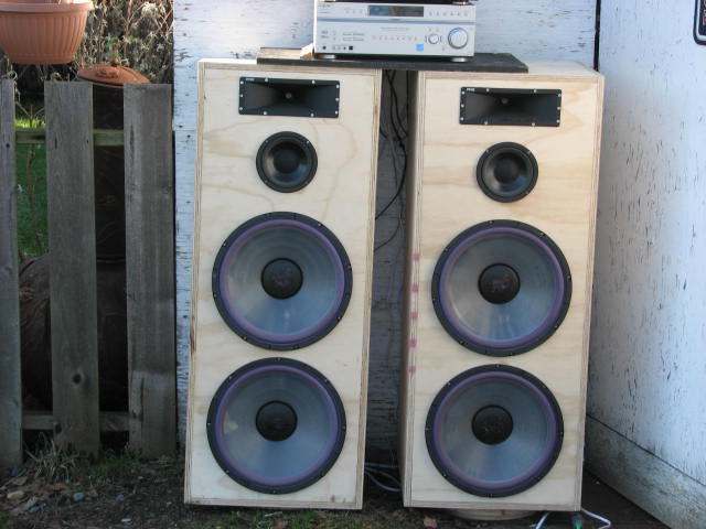

I use the D250 in the midrange horn here and an entry level Selenium CD in the tweeter horn. Both do a decent job for party time.Another good midrange compression driver, this one is made by Selenium
And if nothing else works in the recycle department then Cerwin Vegas will fit the bill. These MV-15 were $100 a pair from a bar that was changing it's inventory. I'm sure there's something out there you can find with a few phone calls. If you google, you'll even see that same picture from my sun room. 🙂
