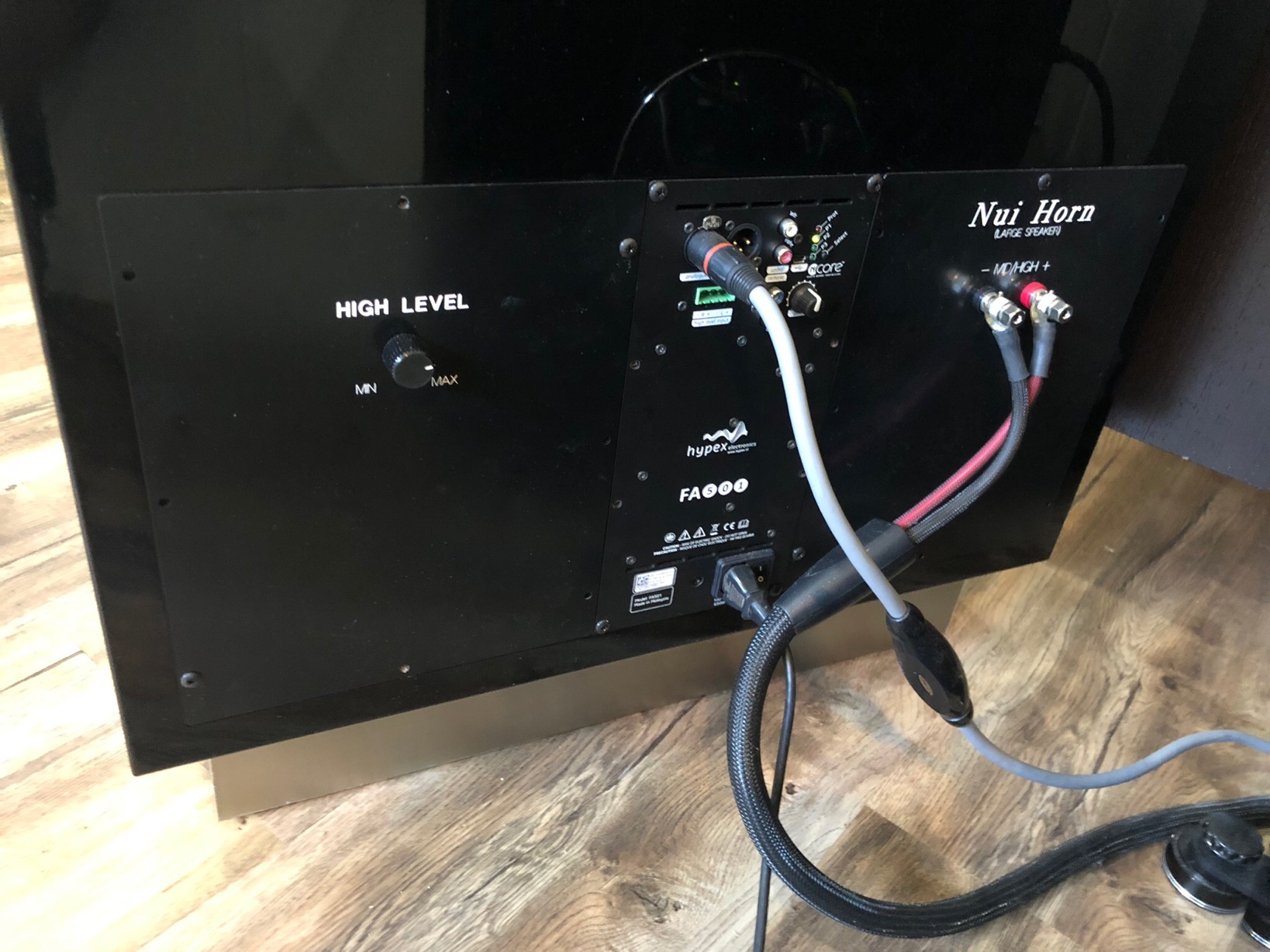

I have yet to finalize adjustments on the Hypex (yes, running the Hypex for the 18’s), haven’t even set the gain, just running on Troels’s settings.
I also installed an attenuator for the compression driver, I have left it centered.
For the mids and highs I’m running the Babelfish J’s I built. I also want to try out the KT 150 amps I built soon too.

So about adjusting the compression driver. I installed Troels L-pad option. Purchased a pair from Fostex.
Today I spent about half the day playing audio. Since I’m over the 100 hour mark, I played with toe-in, adjusting the compression driver, and minimal adjustments on the Hypex, really only the volume.
Seems I get the the best soundstage with the baffles toed in slightly, pointed to the imaginary people on my right and left, respectively.
Volume about 50% on the Hypex.
And not sure what adjusting the L-pad on the compression driver is supposed to change. But this adjustment was the most beneficial of the day. At its most lowest setting the treble seemed muddy, at its highest setting is sounded clinical. It seems I’m happiest at about 3/4 of the way toward highest setting.
I have to say I’m really surprised at how much difference this adjustment can make.
This corrected the discomfort I was feeling at higher volume.

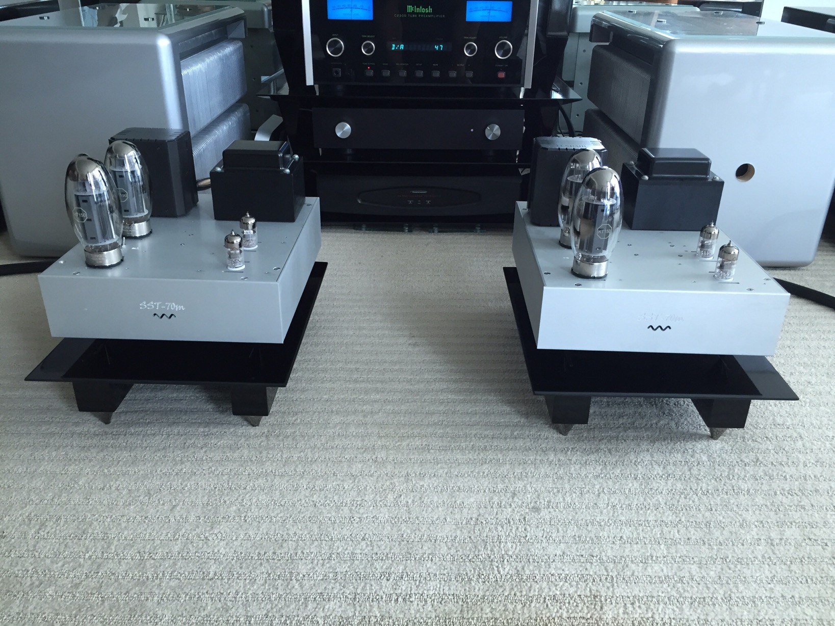

Here is a pic of my KT150 amps I built, circuitry and boards by K & K Audio. Looking forward to trying them out on these speakers. Probably wait a couple weeks to fully get used to my Babelfish J’s.

will be good to hear what the tube amp can do...I heard Troels G- Glowmaster tube amp when i was in his place to hear the Loudspeaker...very good sounding amp
you have some really fine gear to use with your speaker,,,
Best Bjarne

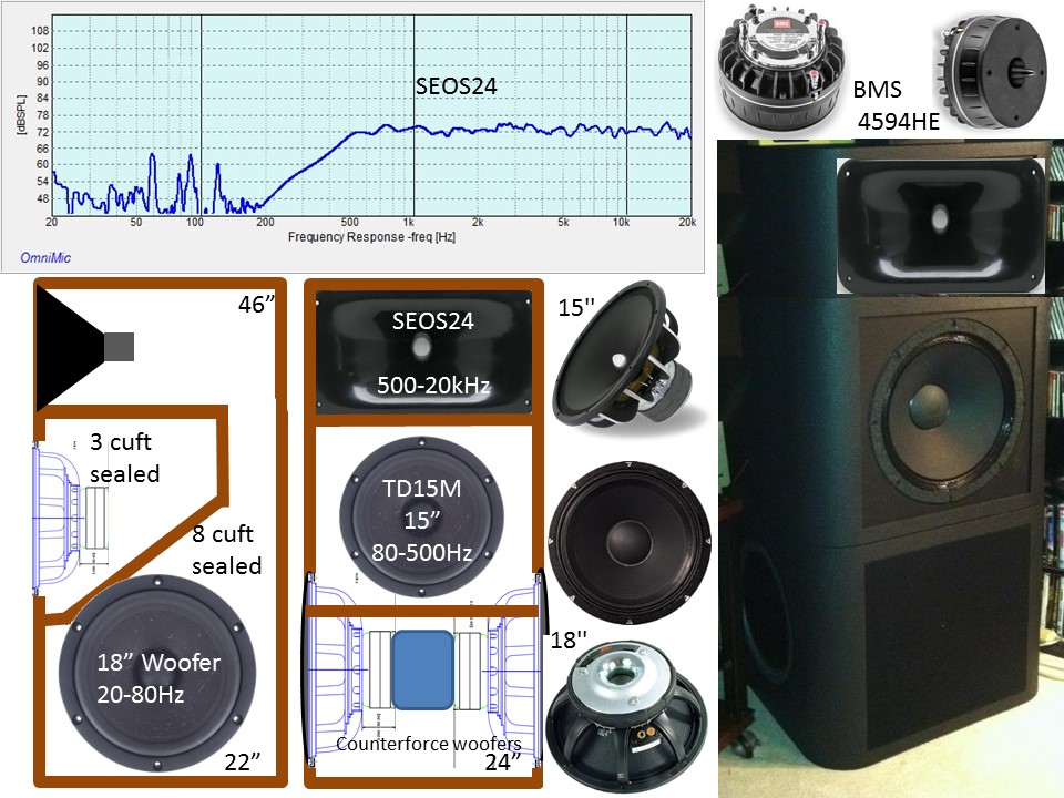

I wanted to build JBL 43xx clones for a long time. When the realization that original drivers were getting scarce and expensive, alternatives became realistic choices.
I think the game changers for a modern LARGE REFERENCE SPEAKER are the coaxial compression drivers, modern profile 24" - 30" wide horns, and multi-amp DSP. $2000-each + cabinets
There have been a couple discussion threads on controlled directivity and room integration. Experiments of when and how a horn's controlled directivity should transfer into a full room polar response will define the NEW LARGE REFERENCE SPEAKER .
coaxial compression drivers which perform well down to 500Hz
2" BMS 4594ND, 1.4" BMS 4592HE, 1.4" B&C DCX464
modern profile 24" - 30" horns which perform well down to 500Hz ... even 300Hz:
SEOS24, SEOS30, eJMLC300, Klipsch K501, JBL-M2, JBL-2384

The cabinet measured 79 degrees and gives a good benchmark for the room temperature and the thermometer
The resistors were all close to the same, high of 87 degrees
The coils were all close to the same, high of 87 degrees
The body of the L-pad measured 83 degrees
The hottest point on the Hypex measured 113 degrees.
I have a common pocket behind the two panels and the Hypex. This was by design to give the Hypex more room to dissipate its generated heat. I have a feeling that some of that heat has warmed up the other components. The L-pad is physically connected to the aluminum cover, and I think it acts as a heatsink as to the reason it’s a little cooler.
But even with the Hypex generating a lot of heat the speaker is still running at about 50% below the fasteners specs.
What do you think?
