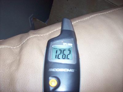

(The NHT subs can't hit 126, like my horn loaded sub... but then there's ZERO SAF for a sub that hits 126)

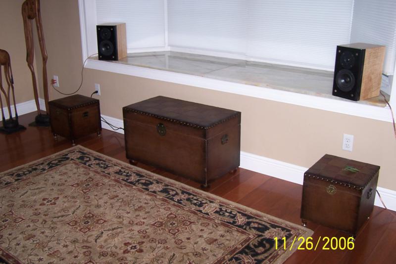

is corner behind a sofa an option?
Thanks, I cheated. My wife & I went to various stores that have trunks, I knew the sizes that I was looking for, and she knew the style she wanted. We found this set of trunks in a clearance section of a furniture store.
They are made out of thin cheap plywood, so I built MDF (with all holes cut) enclosures that fit very tightly inside, and glued the MDF boxes inside. I then used a zip router to route out the thin plywood exterior. Mounted my drivers and viola, Subs with high WAF. I also used some clear silicone to make sure the handles didn't rattle.
