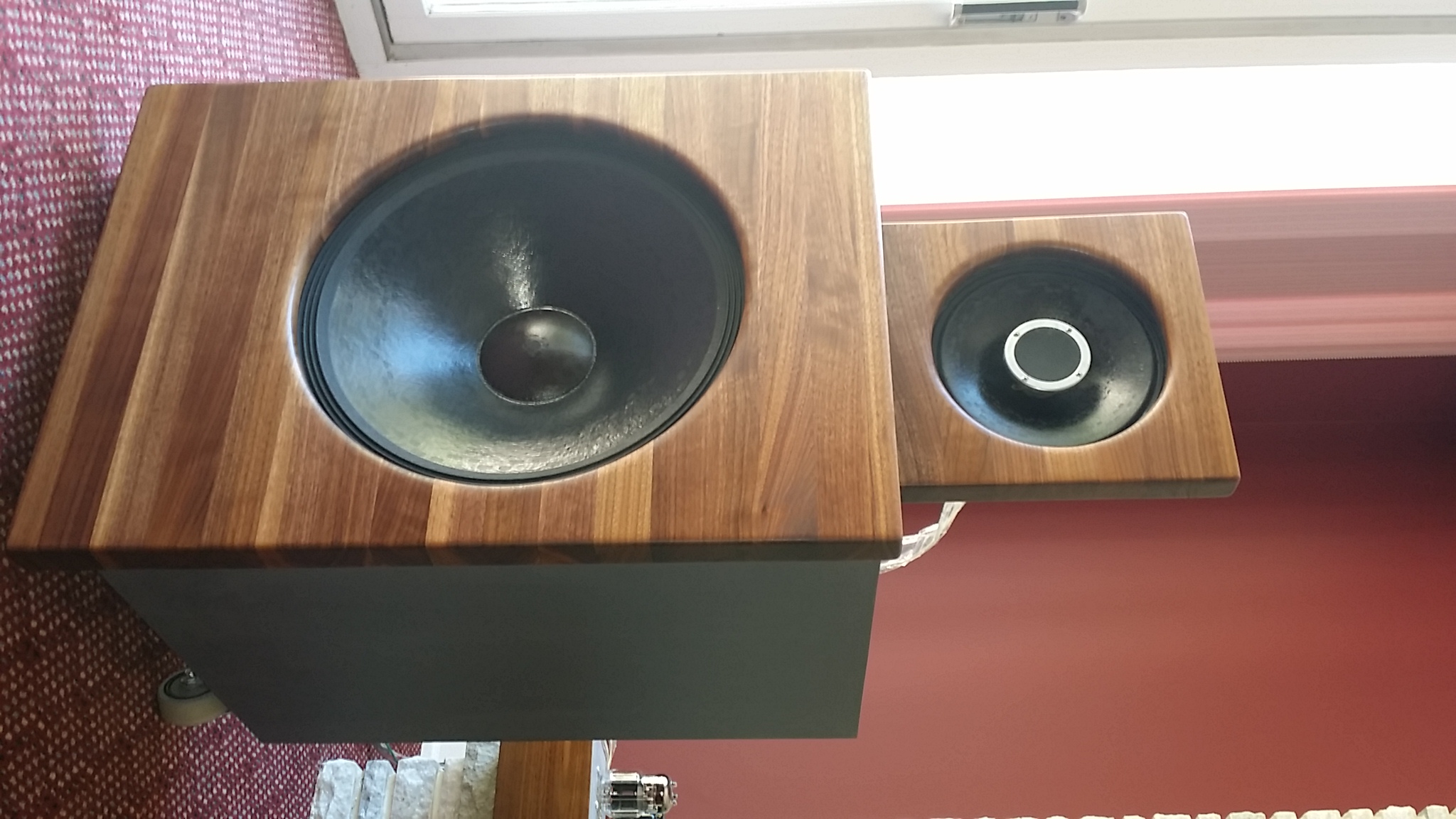

nice looking speaker
its not easy to make big woofers look good
(just look at open baffle threads like manzanita)
well executed

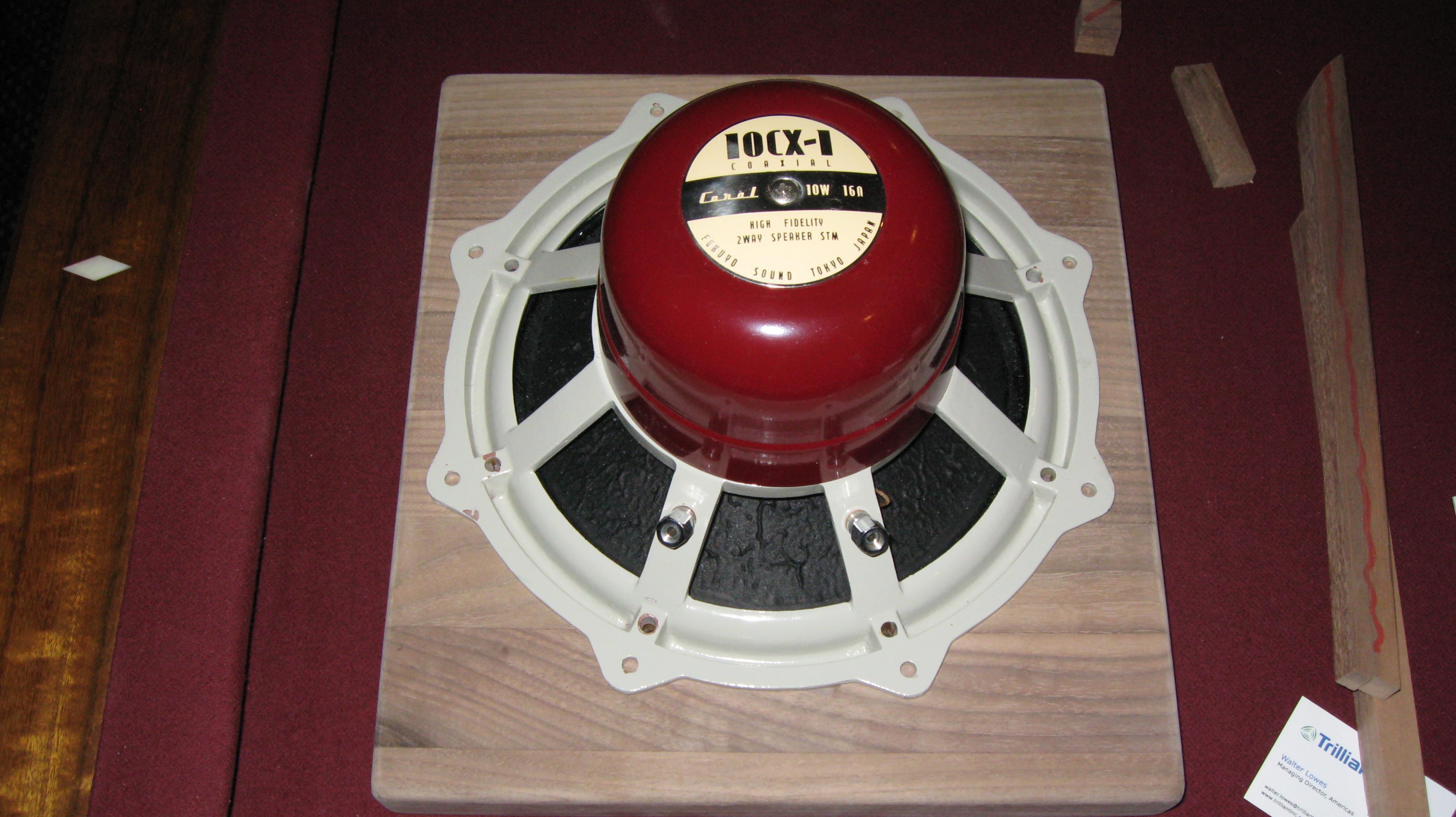

what coax? just curious
well executed
+1My advice is remember this, when you listen to speakers, you do it with your ears and your eyes as well.
Thanks adasonnice looking speaker
well executed
The coax is a really old(70s?) Coral from Japan-10CX-I. Alnico and paper cones. I changed the cap and did an enabl treatment on the cone. It plays from 150Hz up. First order x-over.
