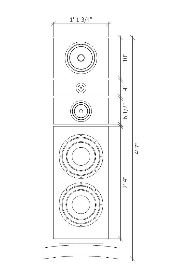

I've been in the planning/design stages of a fairly large multi-way for a few weeks now and thought id share some details for anyone who is interested.

I'm very much open to input. This is meant to be a fun project and simply an exercise in big, dynamic speakers. This will reside in my personal listening room.
PS. this will take some time, and this will be Active for now. I may convert the upper section to passive and use an active bass module. My passive crossover skills are rusty as I mostly deal with active designs and full range.
PPS. the attached drawing is just to get a feel for the cosmetic design. Inspiration comes from the Focal Utopia line. Dimensions are (almost certainly) subject to change. My listening room has tall furniture, and we are fairly tall people, as such the tweeter height may seem a tad higher than what is typical, but it suits our specific application.

Personally, the only application where I find the close spacing of drivers (tweet, 4", 8", 10" or tweet 5", 7.5", 10") is when multiple different principles of physics driving you in different directions constrain you to such choices, like a narrow baffle dipole where the conflicting interests of small driver size to reduce dipole path length and volume displacement needs to reach target spl. Or in an MTM where you're really trying to minimize interdriver spacing for vertical lobing considerations and still want to maintain a high spl target.
I'm not sure I see that focus in your design. So I'm not sure if the tradeoff in complexity is worth it. Your layout limits interdriver vertical lobing considerations to just the crossover frequency between say 4 and 8, or 5 and 7.5, instead of the upper xo frequency with the tweeter, which is a benefit, but will still have some interesting vertical response patterns and at a huge cost of complexity.
Picking one driver that can cover the range in a 3 way usually works out better unless as above you have some other goals that take priority and force you to deal with the consequences.
The Satori 5" and 6" are both really nice, and either could be used depending on tweeter choice.
Thanks for the input. I certainly see your point regarding the issue and complexity that arises from the layout. Moving the midwoofer below the midrange would help but raises the tweeter height considerably.
I considered a design with dual midranges in an mtm to better handle the issue, but cost and complexity only increase further.
A 3 way would greatly simplify the design and help deal with the issues of driver spacing. I've debated midrange size in this instance to find the sweet spot between displacement and dispersion. I believe a 5-6" might be the ticket.
This will be the most complex design I've done and certainly a learning experience. Truth be told I've been leaning towards a simpler 3 way. The 4 way shown in the sketch may be a bit ambitious.
