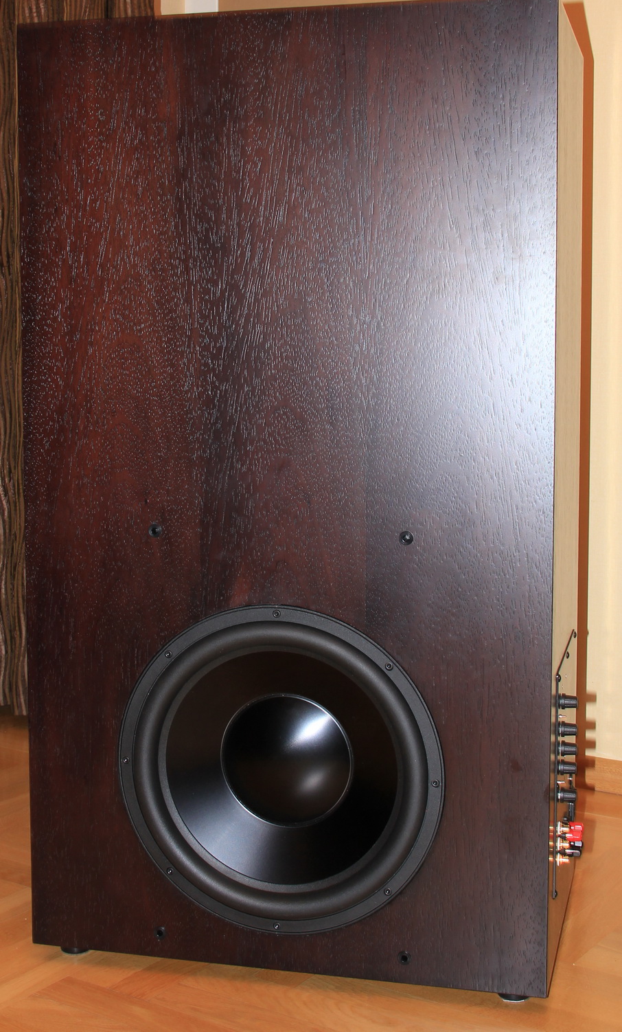

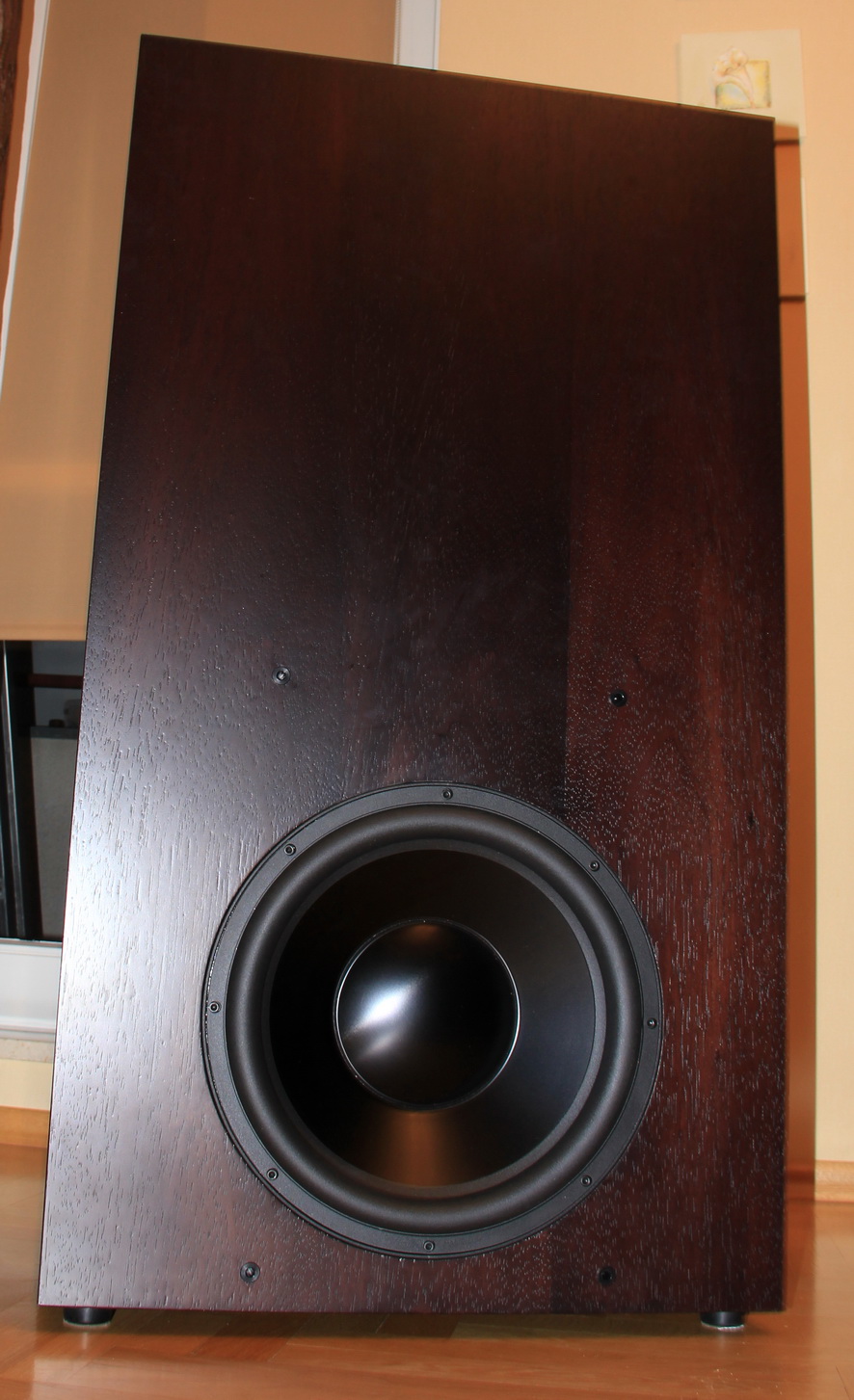

The project was created for a friend. Initially, there were attempts to buy the factory subwoofer, but finding a subwoofer with desirable characteristics as good prices happened after simply not realistic, came the decision to design Super Subwoofer.
Construction

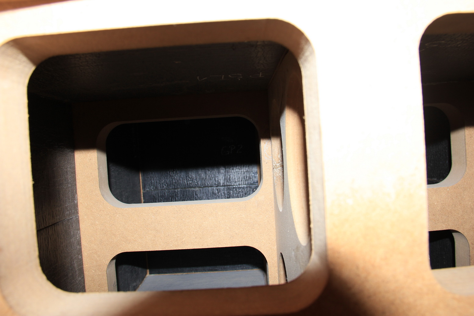

Design intent:
very low lower frequency range below 20 Hz
very good impulse response.

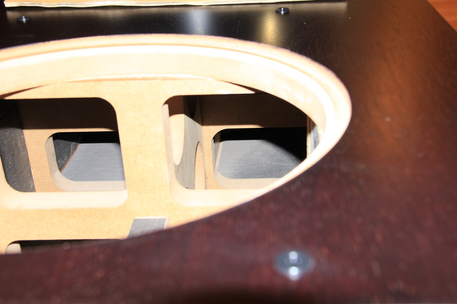

As we care for the very good impulse response design was based on a closed box! This resulted in That the size of the housing is simply a large external dimensions are 1.1 x 0.62 x 0.41 m and a total gross volume of 0.279 m3 (279L) brutto and netto 180 liters. As a speaker was chosen mighty Dayton RSS390HF. To drive the whole amplifier was used HYPEX DS4 reflected a near 400 W into 4 ohms (actually some 320W). Although I Consider That it is not too strong in the clean 500W inches would not hurt, of course, the amplifier operates in class D. Enclosure speaker, of course, been properly calculated .

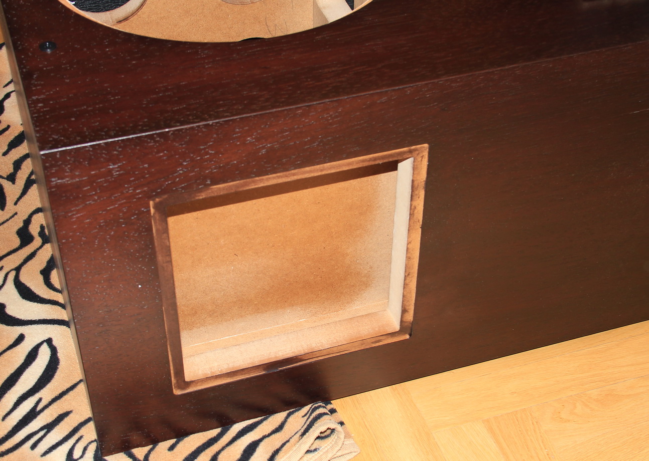

It was used for the construction of MDF with a thickness of 38mm with additional reinforcements in the middle.
The whole was then finished wood veneer.

Myself, I crunched the numbers for this driver & got a substantially smaller enclosure for a Qtc of 0.71...that said, his choice has the enclosure a bit larger than twice the volume...driving down Qtc...towards that "transient perfect" zone. Since it graphs out as a nice gentle slope (at least at 0.71)...he seems to want to try approaching zero "ringing", damped performance, but will need some equalization to bring 20 Hz. to zero Db. At least 9 Db. Just don't try to get those 16Hz. signals from a pipe organ...those will have fallen too fall, "off the cliff".
----------------------------------------------------------------------Rick.............
?? Did you follow the OP's link?
The Qts he gives is 0.42 and Vas is 281.8 litres. I chuck the numbers into a calculator and get 153 litres - close enough to the OP's 180 litres.
My calculator shows a -3dB point at 30Hz: same as the OP.
I sim it as about 7dB down at 20Hz. This, very roughly, is equal to the gain in a typical room.

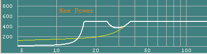

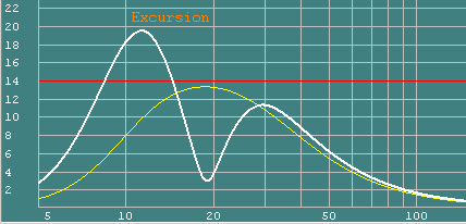

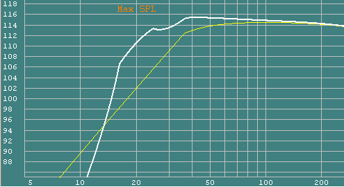

Hi i simmed the driver both ways with the T/S you showed. Several specs are different than quoted in the link on your www ? Dayton Audio RSS390HF-4 15" Reference HF Subwoofer 4 Ohm
Both boxes Net internal Vol = 180L & with a 24db HPF @ 10Hz
BR box fb = 19Hz
White = Bass Reflex - Yellow = Closed
The BR seems a lot better in many ways !
BR box fb = 19Hz
Wow, everyone's a critic! I think it's a good, simple build.
BR / sealed might depend on what the user prefers. I like sealed cos they are easy to get right. Also, placement and room effects are important:
I sim the sealed box as -7dB at 20Hz.
In this linked article, they show +8dB at 20Hz for corner placement, relative to a outdoors measurement.
So, with room gain, which normal simulators do not show, the sealed box should sound better, in-room.
