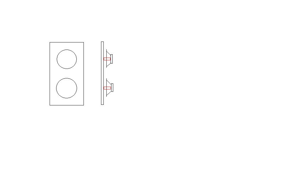

Could this be a way to do a huge woofer with very low Fs
Drawing shows a huge membrane coupled to one or multiple woofers
short version? Nope
Long version? REALLY nope.
You'd get a ton of rocking mode distortion from the extended pivot point, and the suspension isn't meant for the type of stress you'd be placing on it.
Better to get woofers more purpose designed for your app. What's wrong with a few Acoustic Elegance IB15s?

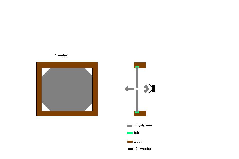

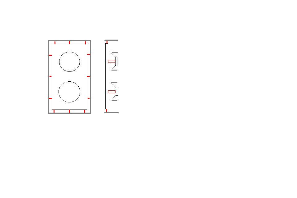

Well, its just an idea that suddenly popped up in my head
Drawing was quickly done, and very incomplete, sorry
I hope this one shows better
Menbrane is suspended by threads
Woofers are mounted in supporting frame

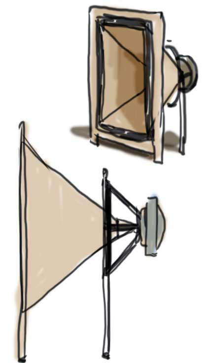

I have similar idea to make huge dipole sub.
get pro woofer with strong motor, remove its cone, leave spider and coil in place. then build and attach your own cone and frame.
then you'll have subwoofer bigger than 31" fostex for much less money.
flat panel cone is a bad idea, it will resonate way too much.
I actually plan to make deep profile, corrugated cone.

"Cone" might be a 1/2" thick polystyrene sheet, about a square meter
No thread surround, but instead use the flexibility of the polystyrene
Corners are cut away to increase flexibility
Which woofer?
I dont expect this to be a high power speaker
I want a refined sub to be used solely at "normal" SPL
But stilll need a woofer driver with a strong motor and fairly good Xmax, if this thing goes really deep
Beyma SM212 might work, and cost is avarage around 100EUR
Or maybe even a carfi woofer would work fine

That 'felt' surround can be noisy I guess, no? I like the one with thread suspension better:D
And the motor should be secured in some way, so I think the skectch by MisterTwister make more sense to me.
As to the membrance, how about honeycomb cardboard? Quite light and rigid related to given area. If more than one motors can be used, then it can be driven more evenly.
I can see quite a few problems with this. Firstly, two motors driving one cone seems like asking for trouble! Also having no baffle at all makes is horrendously efficient, so you are working uphill negating your gains.
I think you'd be better off starting with some large 15" drivers with a powerful magnet and low Qts. Now remove the surround and simply extend the cone so that it's bigger. Cones are better because they combine stiffness and low mass. Any flat panel will be inferior. So you might turn that 15" driver into a 21" and perhaps use a few of them. Now put it in a H frame to get the best efficiency you can from a dipole.

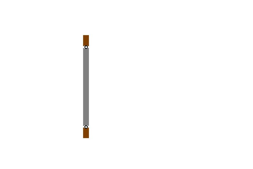

Perhaps you could fashion a more typical type of surround from bicycle inner tube rubber? You could then mount to a baffle for better efficiency. I'd have thought if you used the flexibility of the material to act as excursion, you'd push the resonance back up from the springyness?
I'd expect flat polystyrene to perform very poorly. It is light, but it has no strength or stiffness. A cone with the same mass will be a lot stiffer and stronger. Aluminium subwoofer cones have enough strength for you to stand on them! Just think how thick and heavy the polystyrene would have to be to support your weight!
A cone wouldn't be extremely difficult to make. You could try paper combined with fibreglass/carbon fibre/kevlar. You might use paper to create the shape first, then apply the matting and resin. You could even create ribs for extra stiffness so the cone can remain thin. You could use balsa wood ribs - it has little strength of its own but as the matting wraps around it you then get the strength.
The real challenge is the suspension system. Have you ever heard what a driver sounds like once the surround is damaged? It's not pretty! You can buy rubber surrounds for re-cone kits, but the ones I've seen are small and not cheap. You may have some success with an accordion style surround, but to me this sounds like one of the most difficult parts.
If you leave it out you need a very stiff spider.

I reckon a wheel for a racebike is 28"
A fine size for a woofer
Tuck in the tube
Pump it up
And its moving
Makes me wonder how much such a thing moves
