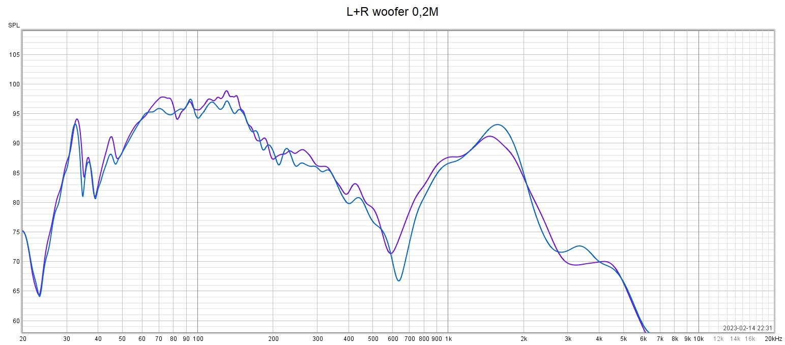

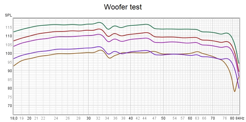

Jawen, is there a coil in serie with the woofers inside the cab ? What is the load : BR, sealed ? Looks like a band pass, very strange...
What you can try is to remove a woofer from the cab and measure it on the soil in front of your home if you have wire long enough and a laptop for the soundcard with the mic on the floor as well.
Yes its so strange!
The Peerlees 830847 XXLS have 2 x 8 ohm´s coils, so its in serie at the coil to 16 ohm and paralell utside with 2 x "the same" XXLS
Its a vented 102 liter netto tuned to 22 hz.
I used bitumen-cement when i mount then, so its going to be hell to get it loose.
Just so you know, i use 2 Krell F.B.I amp for this MTM and woofer.
One for the woofers, and one for the MTM.
Last mesaurement on Left woofer was from MTM amp side, the earlier mesaurement was from the wooffer amp.
Seems strange if one of the krell F.B.I have no hz over 150 hz ?

I'm not a filter specialist, very far from it; but it seems to me you have your answer with the measurement from above at seeing the green curve : your big dip is a measurement difraction issue, so the woofers are making bass as the blue and red curves are showing.
Most of the time for diyers, the bass and a part of the low mid must be simulated because it is impossible to measure rigth without anechoic environment.
The most acurate way is like you made : very near the woofer dust cap and also sumed at the output of the port if Bass reflex or band-pass design. cab side on the floor with mic on the floor. A mid measurement above 600/700 hz circa works if the mid is at iso distance of the floor and ceilling : in your case around 1.25 meter (and of course furnitures apart from this short area), so with a gating measurement of something 6 to 7 ms if my memory serves me well. Some dips in the 100 hz to 200 hz and also around 300 hz are often due to the room interaction.
If I wrote a wrong information here, specialists will correct. Your woofer seems to be fine

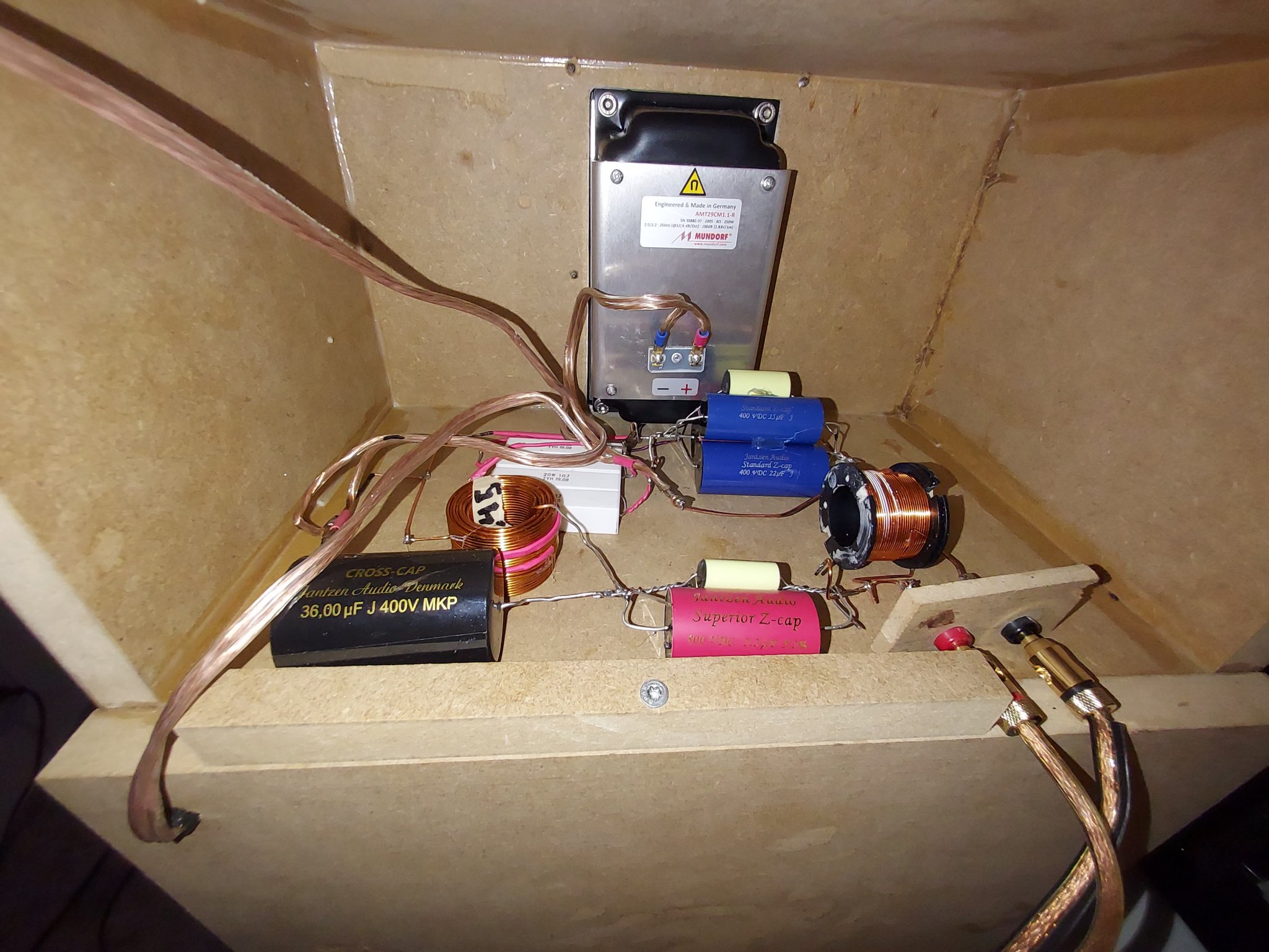

I'm completely exhausted today....You have piles of cables for everything in 15 centimeters of space behind the stereo bench, which weighs a lot because many components are in it. Reconnect solder & run extra wires from everything & measure, measure, measure.
So now the xovers are outside "the box" and no working speakers, and it´s not going to be fun solder the xover ( because I have such short cables)
And have also disconnected everything & moved around heavy amp and preamps, so at least a couple of hours to get everything back.

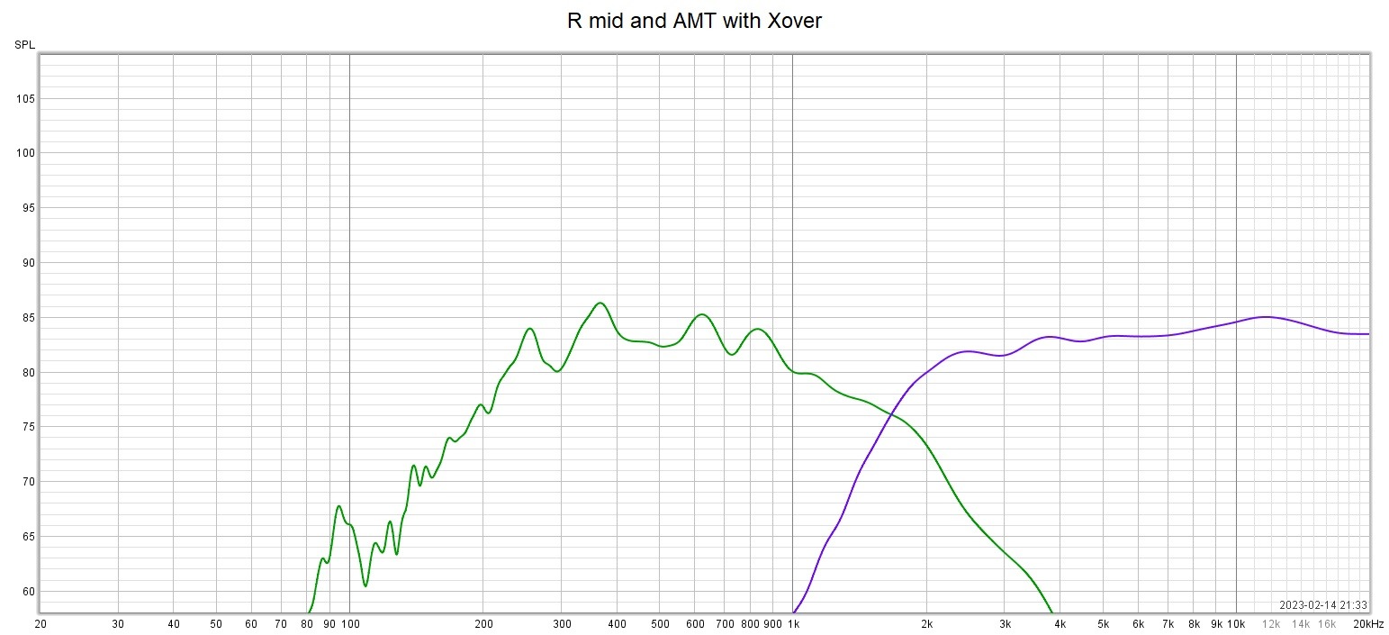

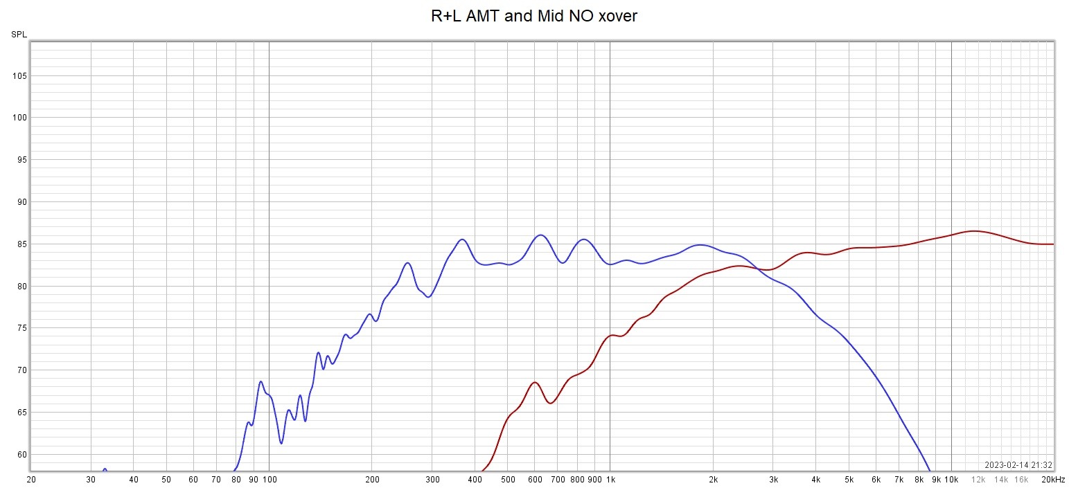

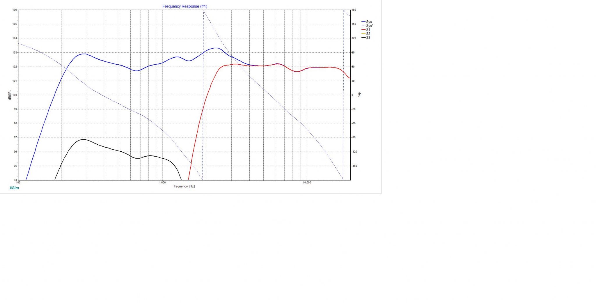

Had put the real mesaurements in XSIM, and are working with getting a better 340-1K curve...And also lower the xover-point for the AMT a little.
Regards John

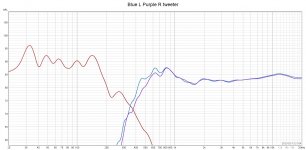

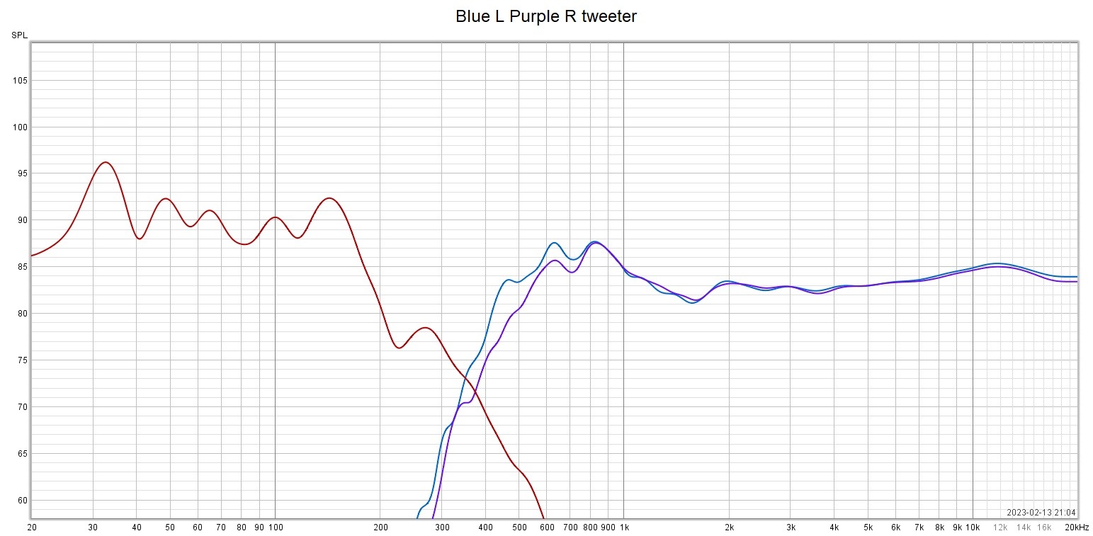

Have done some finetuning and masaurements in passive xover, but dont have enough experience to know "where to stop" and be satisfied.
Mesaurement and phase and distortion and waterfall.
For yoy guy´s, how does this look ?
Happy if i get some comments and suggestions.

Quite interesting that XSIM and actual mesaurements in the room are so near eachother!
Even if i have spend much time.
Think i end up with having 2 order filter for the AMT insteed of 3 order, and finetuned with cap-change on mid and a resistor on both mid and high.

It would be helpful if you could describe the measurement process you are using. What microphone are you using? What is the measurement software/hardware? Are you applying a time gating or windowing ? How much distance between the driver and the nearest large surface (wall/floor/ceiling), and how much distance between the mic and the nearest large surface?

Sorry J I didn't think of that in all the "fixing" and thinking.
Im using a calibrated UMIK and the software REW.
And im not familier with the setting in REW, so i think its "standard", but took a dump on the side so you can se.
The speaker is about 55 cm out from the front wall, with toe-in.
Center MTM is about 1,1 meter from floor and 1,4 meter to the ceiling
Center of AMT 1,1 meter from left wall, 1,1 M from floor and 1,4 M from ceiling
The mic is 1,1M from floor , 1,4 M from the ceiling and 1,52 M from left wall.
Is a bit of chaos now while I work and measure, but here is a pic att the room/mic/speaker

You need to know the exact impedance of the filters at their cut-off frequency, hence impedance measurement in their cab, raw of the filter first.

From what I can tell, it seems that you are using the "as-measured" responses of your drivers, right down to the lowest frequencies. This technique may not provide you with enough accuracy at low frequencies.
To get the most accurate low frequency measurement, you will need to make far field gated measurements and merge them with near field measurements. Far field measurements capture the higher frequencies (above 500 Hz approximately), and near field captures the low frequencies).
The far field measurements are made at a distance of 0.5 m to 1.0 m, and a time window (or time gate) of 4 - 8 ms is applied. The measuring distance is dependent on the width of the speaker, and a good rule of thumb for a tall speaker is to measure at a distance of 3x the width. The time window is dependent on the distance to nearest large surface. Usually this is the floor. The time window is chosen to capture the direct sound of the driver, but to exclude the first reflection. If the driver is 1300 mm above the floor, the time window would be about 5 ms.
The near field measurement is made with the mic almost touching the cone. For this measurement you do not use a time window, or you set the window for a very long interval such as 200 ms.
The next step is to merge the far field measurement and the near field measurement. VituixCad is the tool I use to do this, but there are others. The attached document explains how and why this is done.
Once you have a "merged" frequency response of each driver, you will have much more information to help you understand what is going on with your measurements and your simulations.

- Big dip between active and passive filter around crossingpoint?
