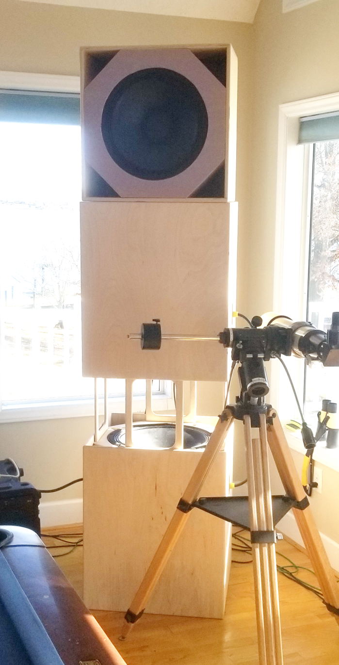

Here's a big coax, a B&C 15cxn88.
Ported to max out at around 100Hz.
The subs underneath are two single Failtal 18fh500's.
It was a whacked out idea wanting to use two single 18"s in push-push for vibration cancellation, and also as a stand for the coax.
Reactions: Naturlyd

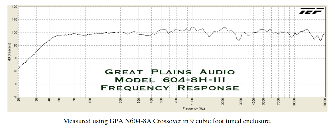

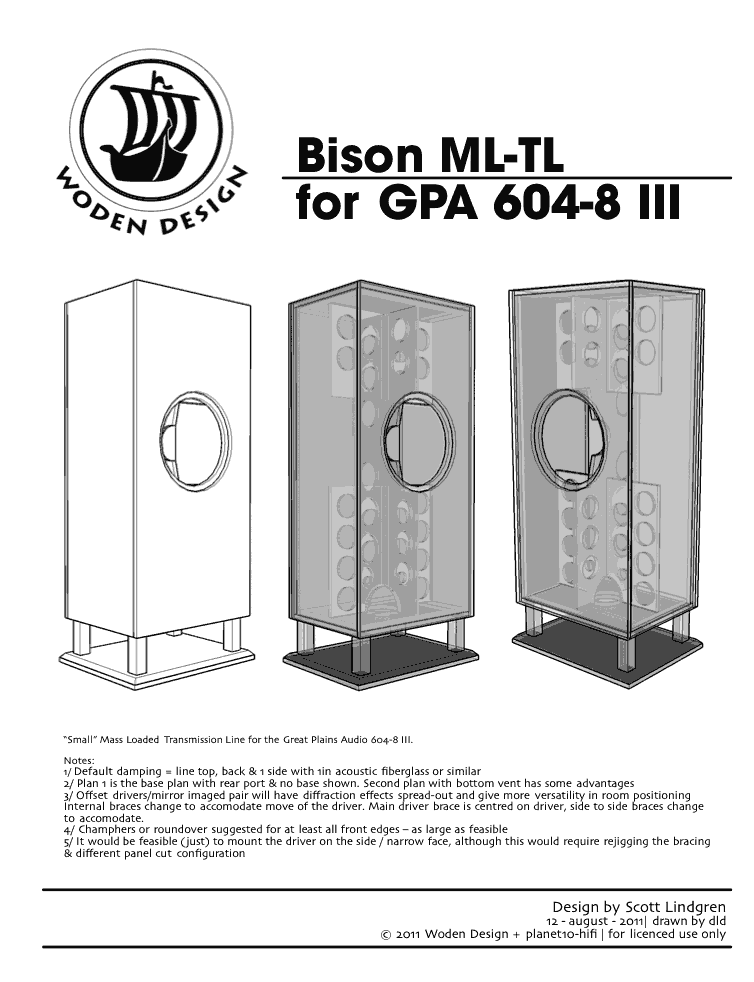

Yes, bi-amp is far and away the best for me. I have original Altec 604-8H's
604-8H
1979 to
1981
Altec 604-8H (last 604 with Alnico magnets and first with Mantaray horn)
16" Duplex Speaker
Magnets: Alnico V
Power Rating: 65 watts continuous pink 20Hz-20kHz (AES)
Sensitivity: 100dBSPL/1W/4ft
Free Air Resonance: 30Hz
Response: 20Hz - 22kHz
Crossover: 1500 Hz
Network: matched crossover with parallel filters, 8 ohms, added mid-frequency EQ
Impedance: 8 ohms
Phase Plug: Tangential "Tangerine" phase plug
HF horn: Mantaray constant directivity horn 60° horizontal x 40° vertical
Cone: paper cone with an "accordion edge" cloth surround
Frame: 16" die cast aluminum frame dark gray paint
Weight: 34 lb.
comment: Last, and some say best, model of Alnico 604 series from Altec, and the H introduced the newer Mantaray horn - these and 604-8G's were used in original UREi 813 using UREi's blue horn and Ed Long designed Time-Align crossover
