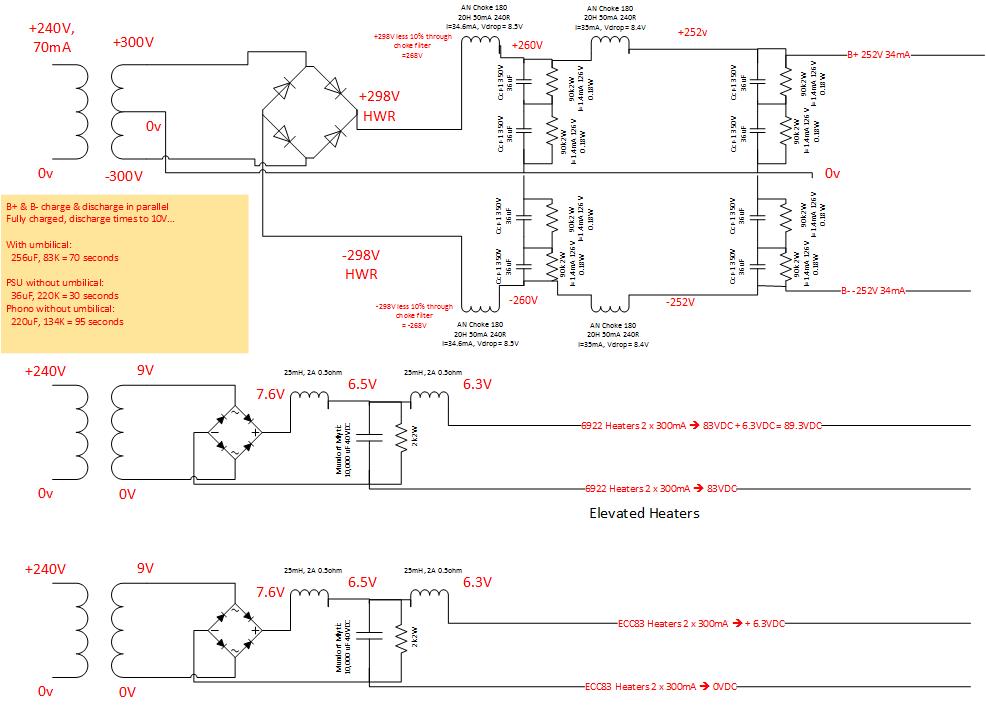

I'm building a power supply for my new balanced phono stage, choke filtered LCLC. Transformer into bridge rectifier, B- & B+ taken from here so each is Half-Wave-Recitified.
I have 10H and 20H chokes - currently planning to put the 10H first, followed by 18uF cap, then 20H, then 18uF. Bleeders across both caps (voltage dividors, as the 18uF is actually 2 x 36uF in series to give plenty of voltage headroom).
What's the criteria for deciding whether to put the 10H first or the 20H ? The 10H are AudioNote 165 (10H, 200mA, 80DCR), 20H are AudioNote 180 (20H, 50mA, 240DCR).
Operating current will be around 34mA, the voltage after the bridge rectifier should be around 290V, so above critical for even the 10H.

Can you link to a schematic, as your description of half wave rectified doesn't seem right.
Have you simulated the design using PSUD2 - that would indicate the peak choke current level. The second choke sees a lower peak current, so is preferably your lower current speced choke (20H).
You are obviously aiming at low output ripple level. Were you contemplating tuning the first choke for maximum 2nd harmonic ripple reduction?
How are you managing rectifier dI/dt and dV/dt noise - valve diodes - smallish filter cap before first choke?

Appreciate the response Tim thanks. Attached image is several versions out of date - I'll convert my visio to an image later and repost. It's quite possible I've described it wrongly but I hope not as that might mean I've also misunderstood it. This is my first real build, although I've modded my own amps and preamps before. Pretty much learning as I go, with the guidance of a friend and help from this forum.

As for your comment on managing rectifier noise - ok you completely lost me sorry. Perhaps the schematic will clarify ?

Your PSU circuit still shows a full-wave rectifier yet calls it a half-wave rectifier.
You haven't shown any 0V connection between the secondary CT and the first set of caps. The 0V seems to fly past the rest of the PSU! Getting grounding right in a PSU is as important as getting component values right.
Why use such small caps and big chokes? That was the way things were done in the 1950s, because bigger caps were not available then at reasonable prices and size.
As a comment, I would still refer to the transformer and the filter as seeing full-wave rectification waveforms.

PSUD2 will give you some indication of how the rectifier can generate large dV/dt and dI/dt waveforms - they need to be managed, otherwise they can easily egress to your amplifier circuitry. Softening the step waveforms and controlling where currents loop are well worth aiming for. Valve diodes are very soft switches. Nowadays you can use ss diodes such as UF4007 that have negligible reverse recovery effect, and very low off-state capacitance, to avoid some noise issues. Adding a low value cap between diodes and choke can alleviate step behaviour, and provide some protection for the choke to voltage transient stress. PT leakage inductance may also be a concern.

Thanks all - shows how much I still need to get.
The PSU diagram could be clearer - the caps for B+ and B- ground to it (obviously with B- I'd need to ensure I connected the positive node if I was using electrolytics).
Clearly I need to better understand FWR vs HWR. Back to the reading.
