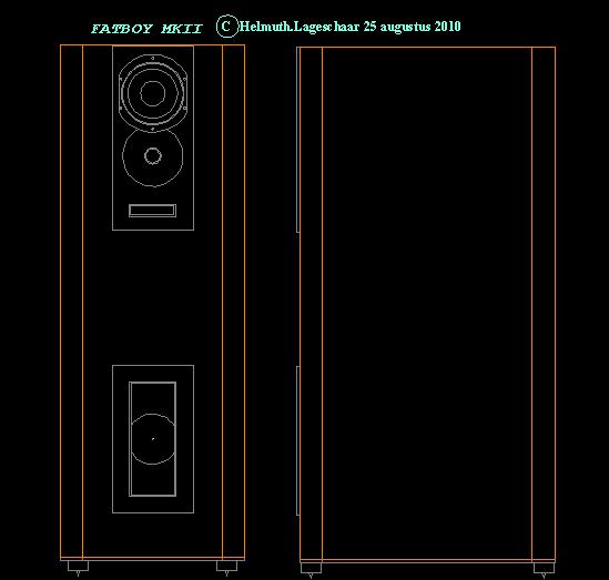

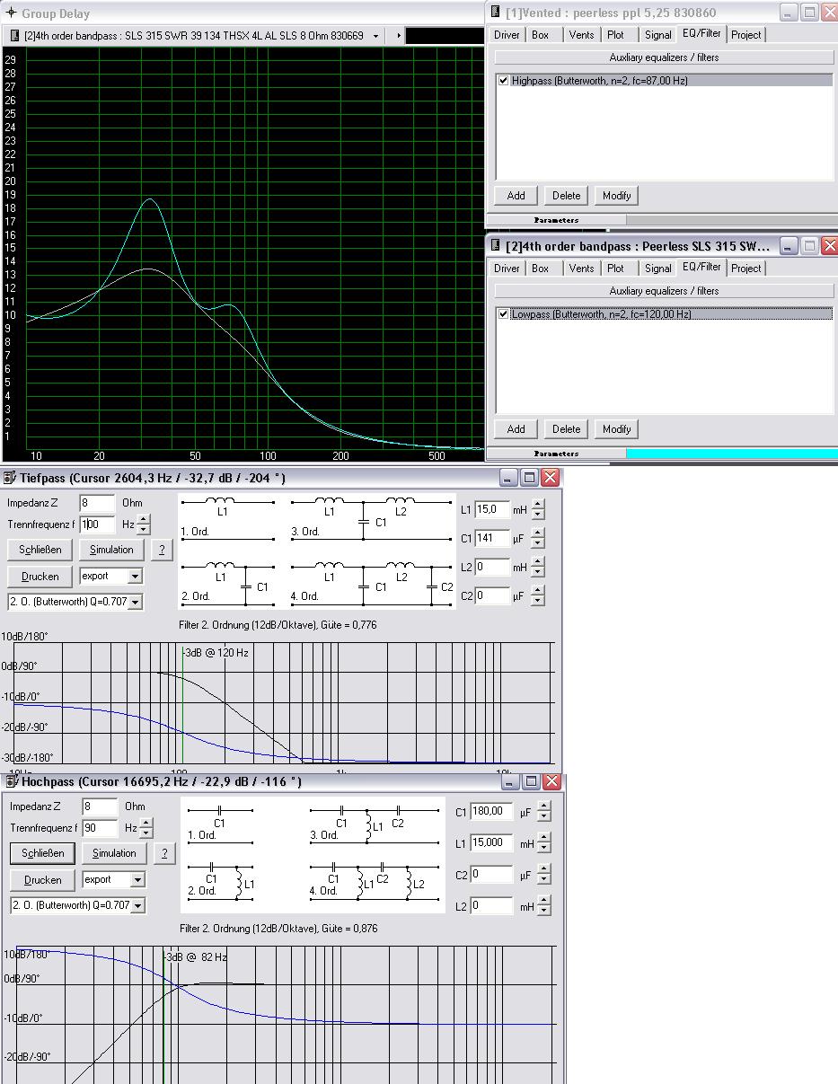

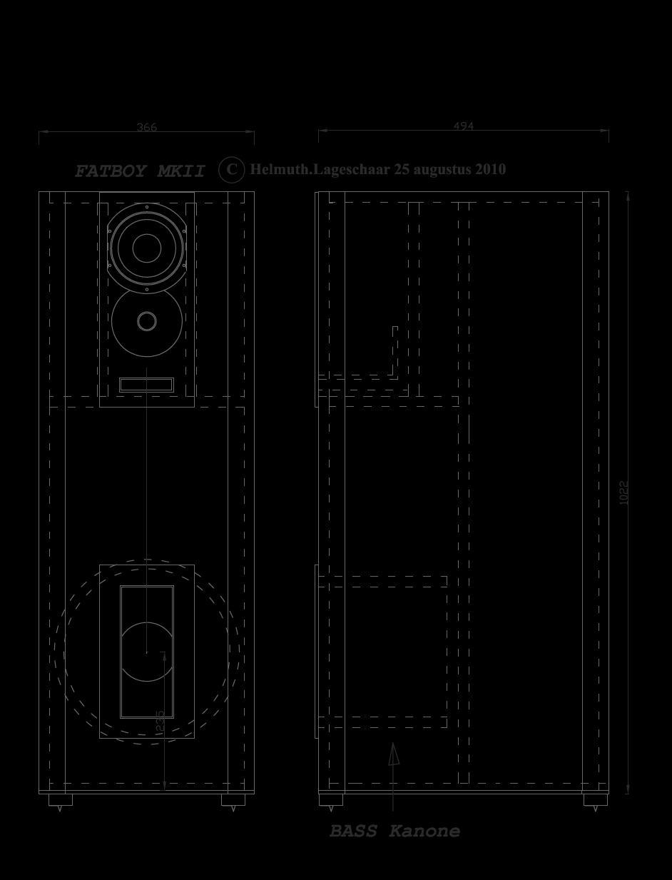

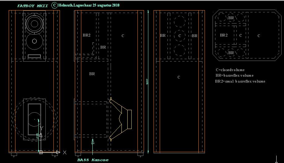

I made a virtual new design FATBOY MKII for people how are interested. It is also good to understand the background of design choices.

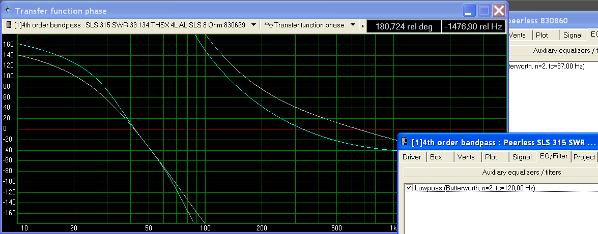

The part that is interesting do do well is the filtering of the sub-bas to the mid bas. I use winisd this helps to show the group-delay of both drivers also with filter. So we do not suffer losses by phase problems.
Virtulal design fatboyII
The design.
The old design was 156 litre the MK2 is 182litre to be really Fat.

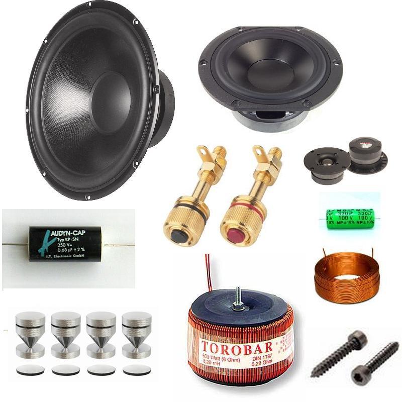

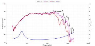

The part I use are high quality and low price.
A big 12" peerles subwoofer with high x-max of peerless with sturdy aluframe.
A peerless polypropylene Highly damped cone almost no breakup at high frequency and sturdy aluframe.
And the Monacor DT300 a very good performing 28mm dome tweeter with back chamber at bottom a price.

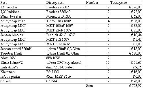

attachment.php
partlist
attachment.php
The fatboy displays what is needed in a speaker design small bas-mid and a big subwoofer because there the most energy needed. With a big volume it is possible to create good sub-bas at normal efficiency.
Here the simulation of the bas to mid. Inclusive filter so that the group-delay of woofer and mid-bas is the same.
attachment.php

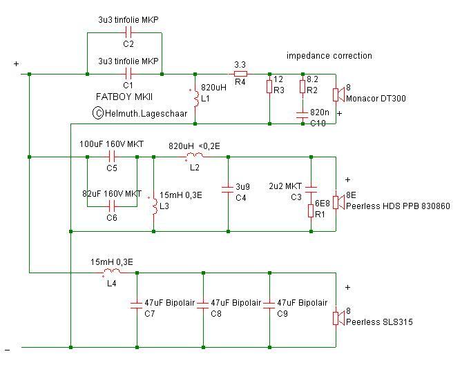

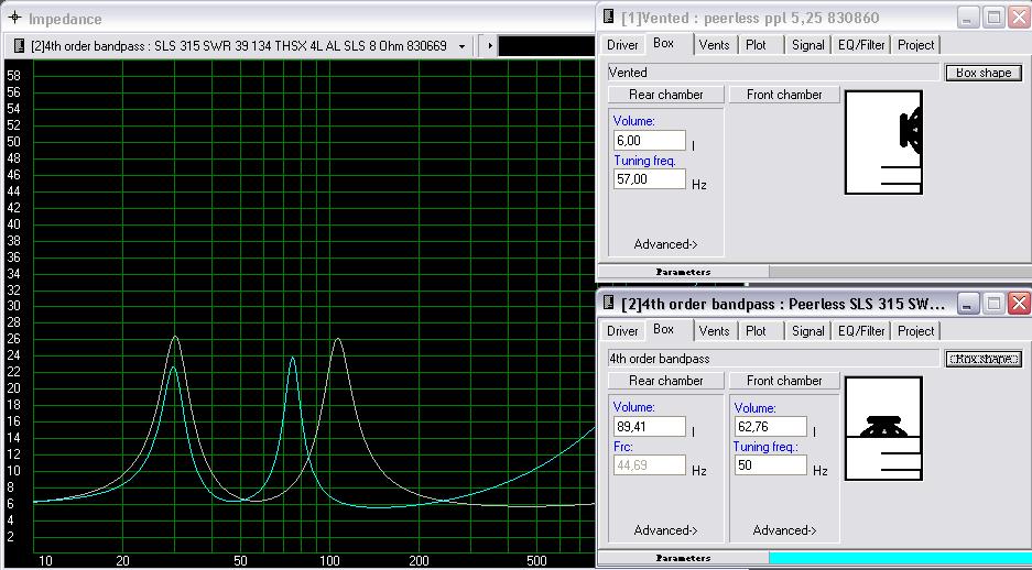

The filter is at two different point because the impedance rise of the drivers compensate impedance faults caused by this configuration.
attachment.php
attachment.php

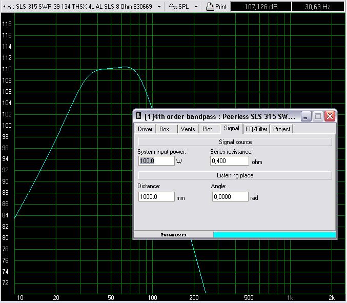

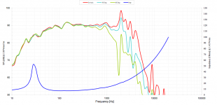

Spl at 100W 110dB flat to 30Hz is very good, this is a design for people who like to hear quality sub-bass. this in combination with the fast mid subbas of the peerless bassmid driverwill sound great.
The basmid driver has also bassreflex loading to control xmax at the low end and there for keep THD and doppler effect low.

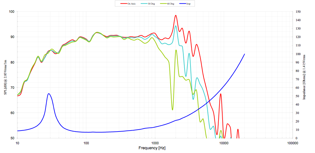

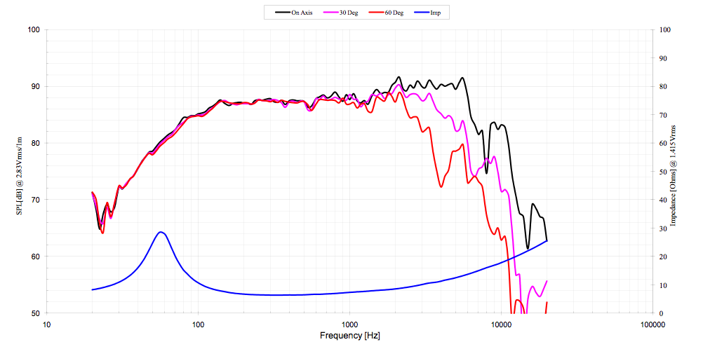

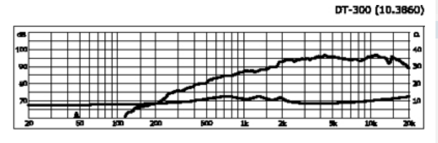

Responses of used drivers.
attachment.php
attachment.php
attachment.php
Regards Helmuth

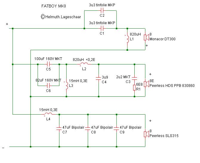

virtual design fatboy MKII
Alternative filter with attenuation of tweeter and impedance compensation.
I would say try what you think sound better pure or with attenuation.
To improve the response of the DT300 further place a 2,7uF parallel over R4.
Note: here mid and low is in phase this is also the case by the other filter posted because the BR tube inverts the phase.

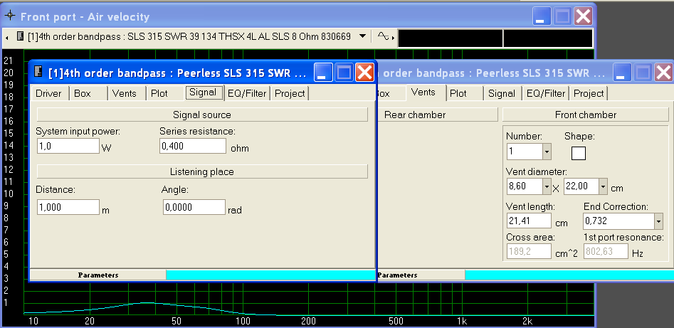

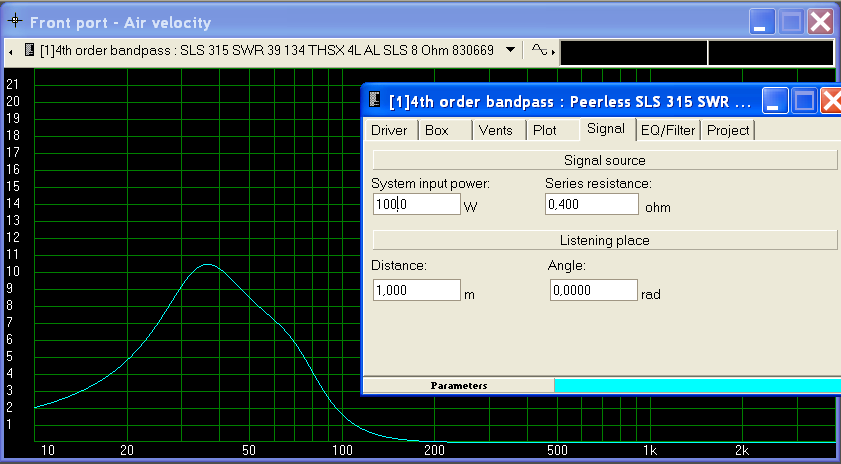

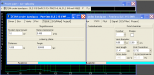

A bass reflex tube shout be 1/3 Sd or bigger if the it doesn't becomes to long.
This to reduce air speed in port and there for reduce losses and air noise.
The Fatboy mkII has a big vent. See here the size of the port and air speed 1W and at 100W.
1Watt = 1mtr/sec
attachment.php
100 Watt about 10mtr/sec
attachment.php

As building material I advise 18mm birch plywood. For it excellent characteristic. And it is easy to work with and a transparent finish looks great.
So the total cost to build these speakers with high quality (expensive) filter-parts will be around 1000 Euro's.
