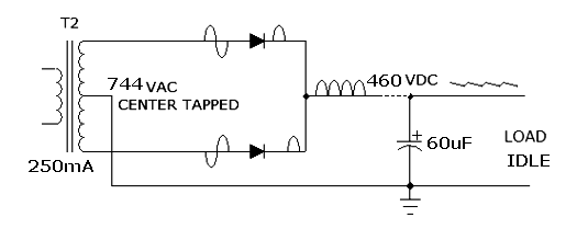

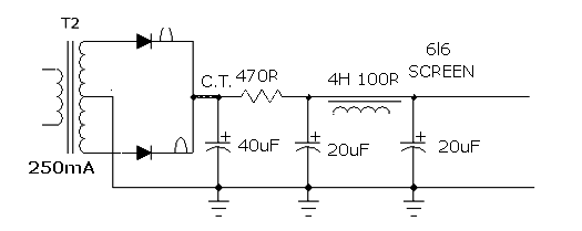

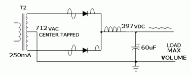

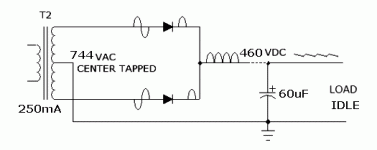

Hello folks!
I've built an amp with 2x6l6gc P-P AB1 in the power section. There is problem that I can't solve: after full wave rectifier, B+ is 460VDC (372VAC on secondary) at idle, and 395VDC (350VAC on sec.) at full power.
Power transformer specs are: 250mA; 372-0-372VAC.
6l6 are biased (fixed bias) at 35mA each. Diodes are 1n5408 (1000v, 3A)
Well, i need more clean headroom and I can't understand why it's sagging too much . Suggestion? Tricks?
Thanks!
well the best thing is to increase regulation. about another 100Uf or so in the power supply would work nicely. but regardless of how stiff you make the power supply, it supposed to sag slightly without inducing power supply noise.

Several people suggested it, did you provide us the DC resistance of the power transformer windings? From your report, your AC voltage at the transformer was dropping considerably. If that voltage drops, then so will the resultinbg rectified and filtered DC. You can consider the resistance of the winding to be in series with it and causing voltage drop with current flow.
You also need to consider the resistance of the primary. The total resistance that should be considered to be in series with the secondary winding is:
Rtotal = Rprimary*(Vsecondary/Vprimary)^2 + Rsecondary

now with your meter set it to ac measure the AC voltage at the output of the rectifier. if this is more than 5mV add more caps.
but in reality your voltage should sag slightly during operation.
its only bad when your power supply can not recover fast enough
as the output tubes conduct they form a resistance that is in series with the output trans. (pri) resistance and parallel to the power supply transformer's (sec) resistance. Any voltage measurement along the points would be measuring that point of the voltage divider network.

From your report, your AC voltage at the transformer was dropping considerably. .
No, was dropping only 10-12 volts. After the rectification DC dropping about 60v.
What is the output voltage at the first cap and second cap ;

The AC output from the transformer will be "flat-topped" since the filter cap is charging only at the peak. Current waveform has perhaps 3:1 peak-to RMS "form factor" - NOT 1.4 like a sine wave! PEAK voltage sags much more under load than RMS. And PEAK voltage is what determines output voltage. Larger first cap will help a little (average output is increased by half the amount the P-P ripple decreases).
